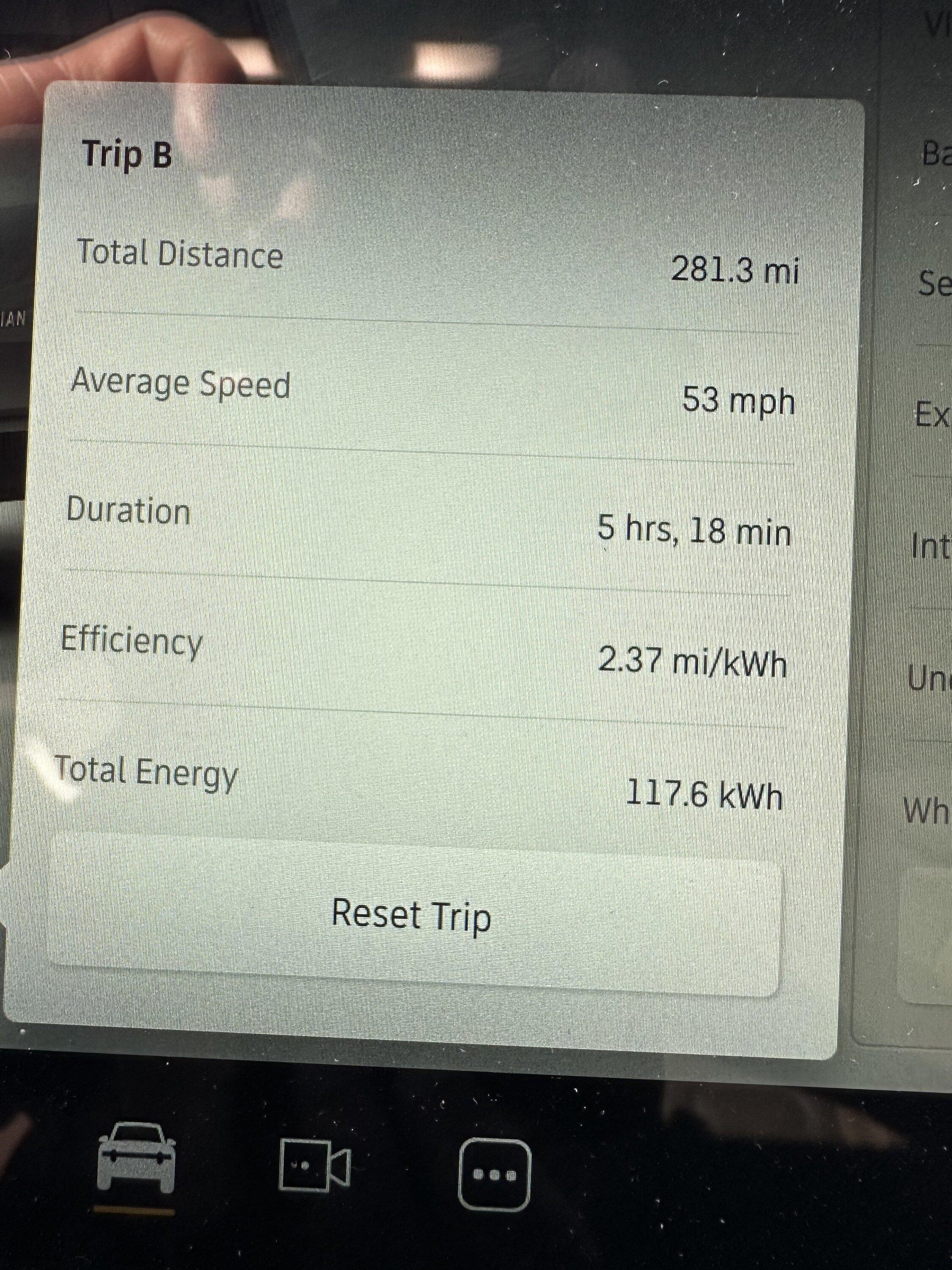

I must be doing something wrong. Just did a full charge to 100%. Ran it down until I had 10 miles remaining in conserve/lowest and was pretty disappointed in the efficiency. This is on 22s.
Rivian R1T R1S Car and Driver Range Test @ 75 mph with 22” wheels - 280 miles 5EF177DE-DF80-41F2-AF24-E36FD72B3EEF
34,497
Doesn’t mean you did anything wrong. It’s still pretty close. 9 miles could be the difference in terrain or outside temp between C&D’s test and your own?
frostbit3
Nov 2, 2021
352
717
Texas Coast
2022 Rivian R1T
Also could be wind speed and direction. Wind is known to have a not insignificant impact to range. I know when outofspeckyle does his range tests he drives both directions so that he goes both with and against the wind to try and average it out.
