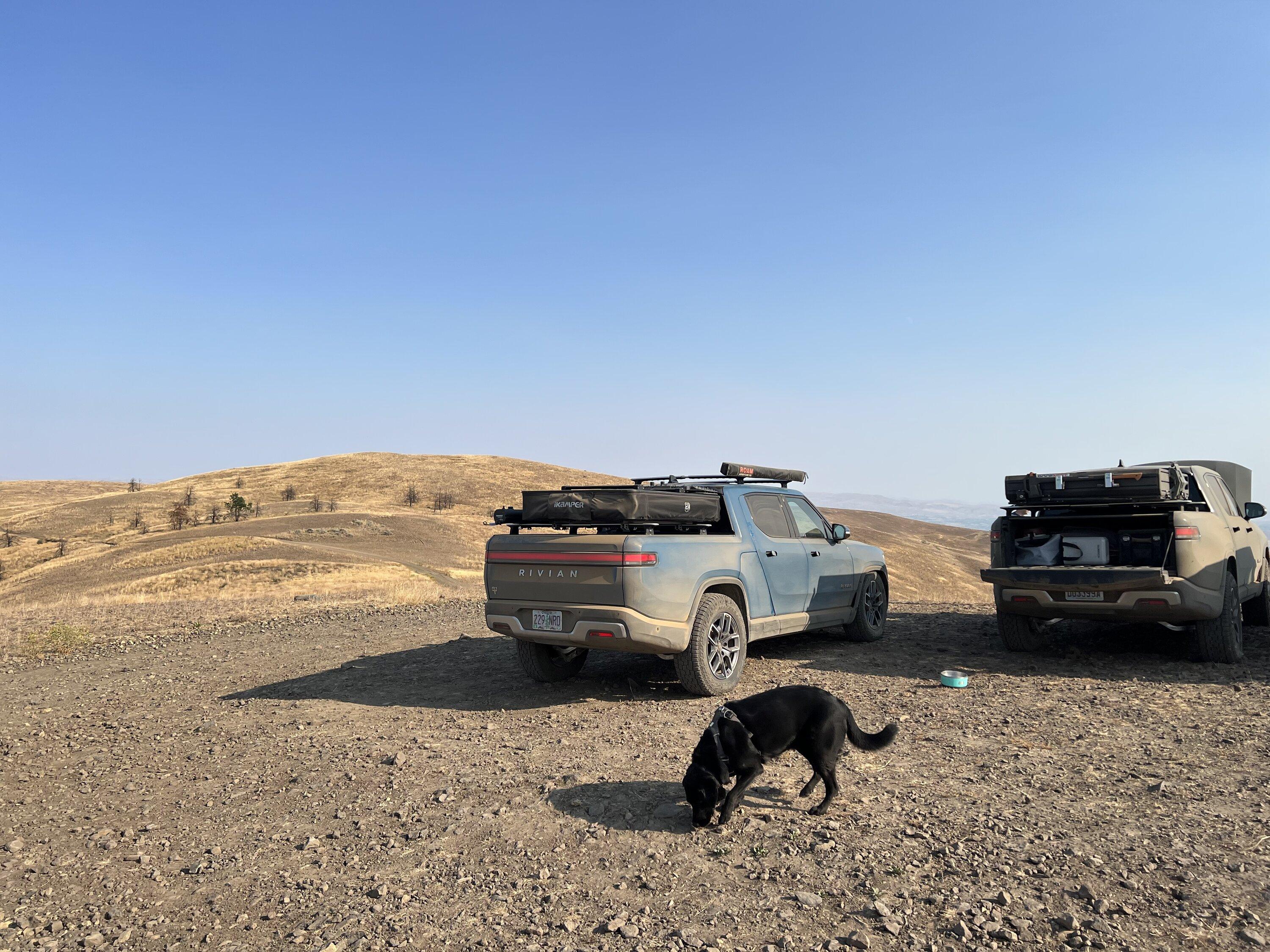

So we had a plan to meet up and do an overlanding mission with our trucks (Myself, @mgc0216, @SeaGeo, @kylealden). The plan was to charge in Yakima Saturday morning then pick up the WA BDR (Backcountry discovery route) towards Ellensburg to charge then continue the WA BDR to Cashmere then head to Leavenworth to charge up and head on our way.
I personally was in Bellevue getting my DF hub replaced at the end of the week, so left there and drove over Chinook Pass in the Rivian and found a camping spot west of Yakima for Friday night, then we met the others in Yakima Saturday morning.
I got the latest update installed just before we left Yakima so was excited to try that out. I did test it while parked downhill for lunch and seemed to work well, albeit slowly. Also camp courtesy is great, no more sounds or bright lights when locking/unlocking the truck.

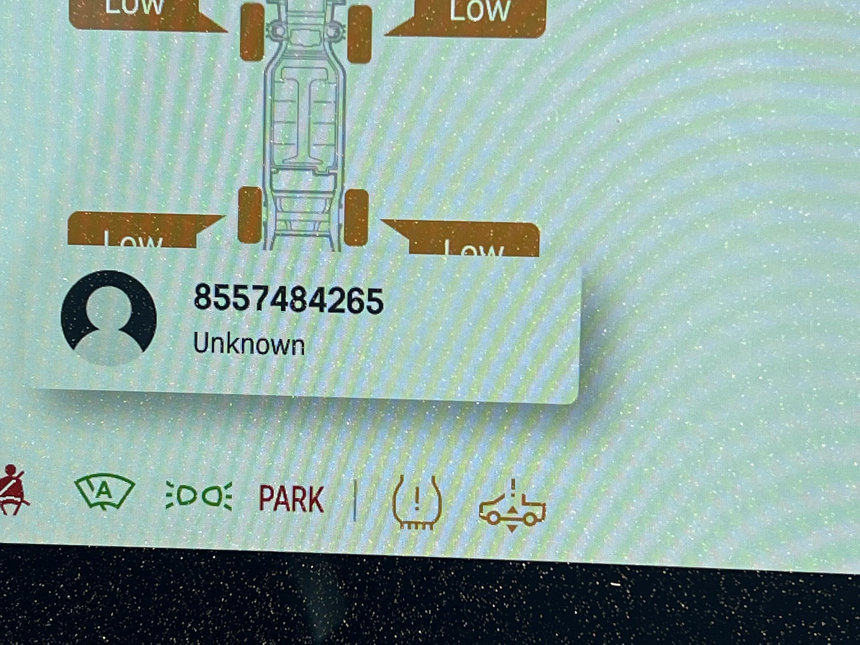

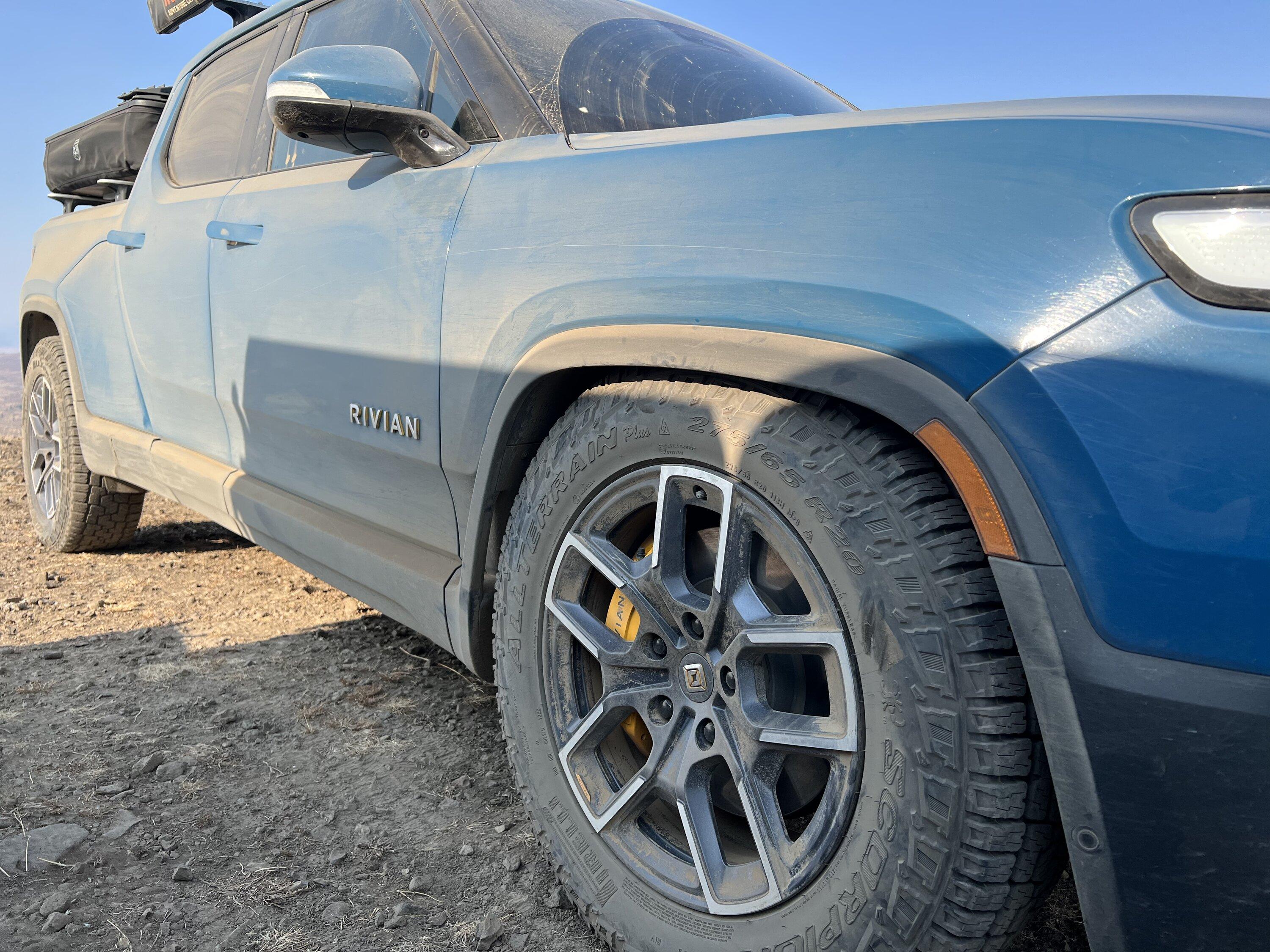

Unfortunetaly for me disaster strikes day one of the trip. The suspension on the PF wheel appears to be leaking such that the truck is nearly sitting on the wheel, definitely rubs if you turn to sharply. It’s a shame because the trail was not overly technical so not sure what the failure point was, we had a few theories but anyones guess. We were able limp my truck to a nice spot to camp for the night then continue to limp out to Ellensburg. This did happen not long after using the camp level feature for lunch but not sure it’s related, though It is possible. After the damage to the suspension I was having a lot of issues with overheating the compressor, it also limited me some due to camp mode and it trying to reset the level on our way out which limited me to 8mph but I was able to reset that issue.
Rivian has been very helpful but are limited in options since rental car agencies in Ellensburg as well as the service center in Bellevue are closed until Tuesday. So they have agreed to reimburse me for the hotel stay for the weekend and my dog and I will ride it out through the holiday. I’ll make the best of it but sad we couldn’t continue our journey to Cashmere.
Iā€˜m sure the others will be able to post much better pictures as we had a dedicated camera person(s).
9/7 Update: They found a leak in passenger front damper. They replaced it and inspected the rest of the suspension and all is good.

Anyway to check for an air leak in that line? If compressor is overheating could be it's running to unsuccessfully fill suspension...

Yeah, sounds like a leaky fitting with the pump spinning it's wheels. A small leak can be found with soapy water. Big leaks should be obvious. Sorry to hear about your trip being cut short. Please let us know once you learn the actual cause so we can prepare a field kit if possible.

Sounds like either a punctured air bag or leaking fitting, causing the compressor to continuously cycle.
EDIT to add that I carry a spare Keldermann air bag for this very situation as part of my Earthroamer field kit....pray I never have to actually replace one in the field, as jacking the camper off the frame is tricky

Yeah, I think a leak somewhere as well. I did take the tire off on that side and had a look but couldn’t see anything. I think I can hear a leak when it is under load but when I had it jacked up not so much.
I think it is a slow leak as well, when the compressor is not overheated it will raise the car for a short bit. Then all of the sudden after a few minutes the front goes into a crouch, more so on the passenger side.
New tire a couple weeks ago as well, so listening to the rubbing was painful.

I noticed the suspension gets wonky afterward if you leveled where the truck has to compensate corner to corner. It's like it doesn't know how much air to put into the other two corners after it goes back to normal. I could see something getting damaged if you rushed that process, even at 8 mph if it's off-road.

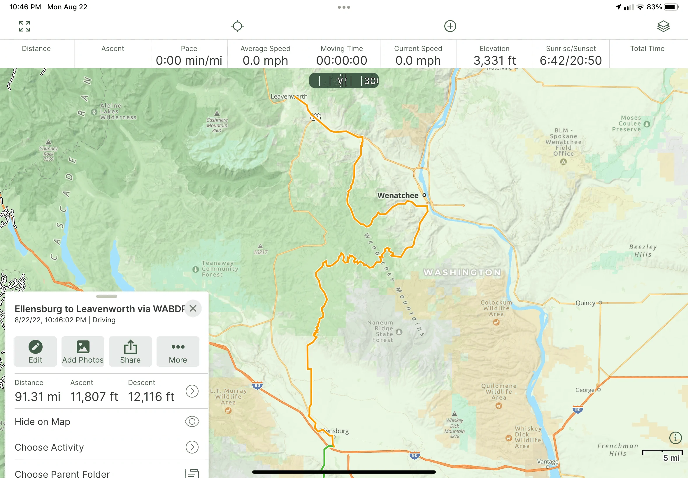

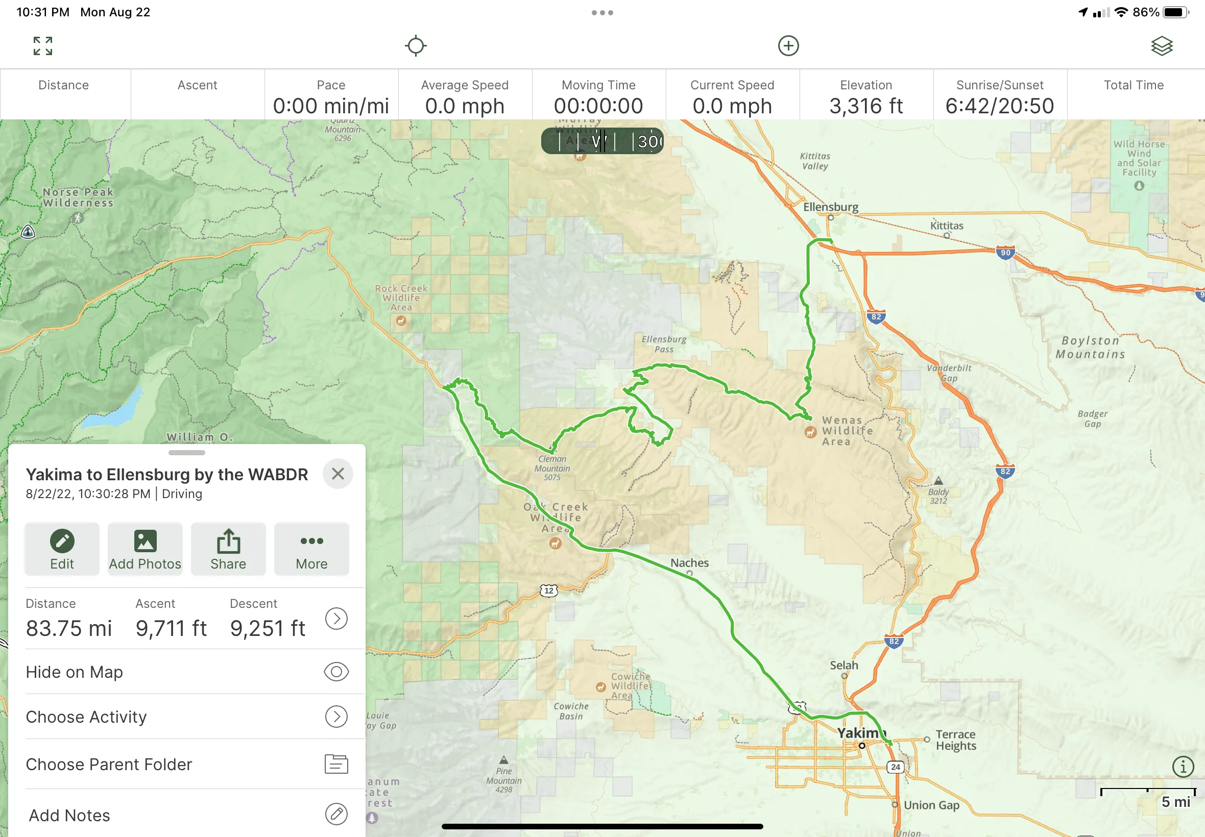

Sorry about the troubles on your trip.... bummer(s). Just curious what app this is you are using for the mapping?
It’s Gaia GPS. I use it on my IPad.
Poking the bear a bit but would be a huge advantage of having Apple CP in the Rivian and use the trucks screen for Gaia tracking, offline map use.
