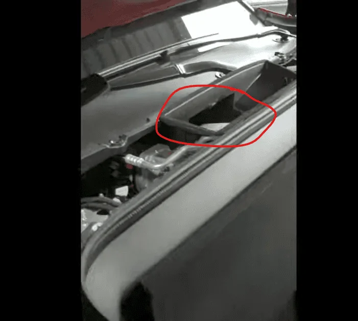

Has anyone done a dyi replacement of the cabin air filter? I blew mine clean when mobile service came out to replace the 12 volts. Getting to the filter involved removing the frunk bed. Seems to me that there ought to be a door to get to a component like that which can be user serviced. With wildfire smoke impacting our road trips last year, I seriously thought about doing a replacement. Is there a video for removing the frunk bed and then putting it back?

You just pull off the plastic cover up against the windshield, under the hood. I removed mine just to see how easy it was. You have to scrunch it up a bit to wrestle it back in, but it was not bad. I sat in the tub to do it.

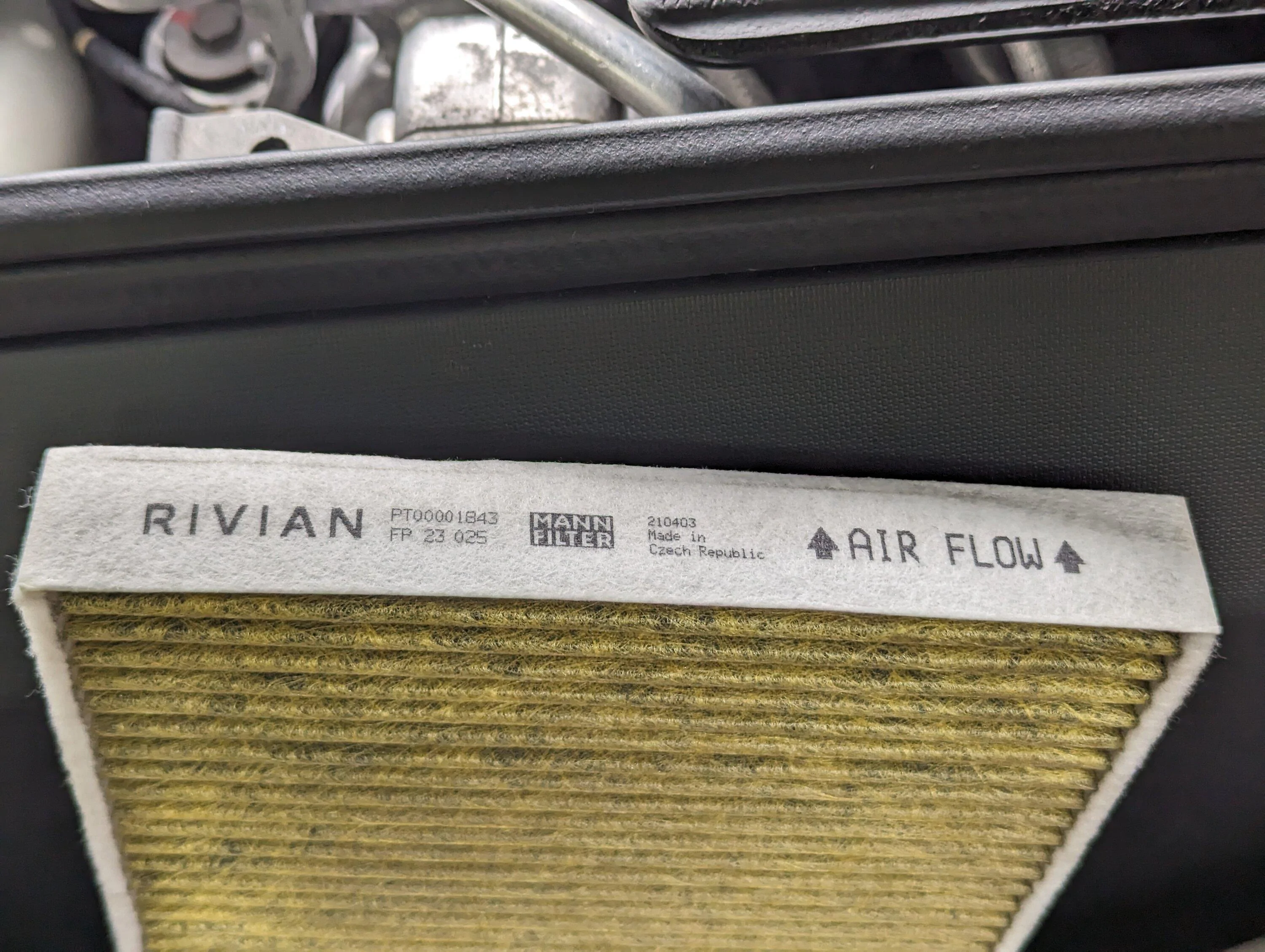

I ordered a FRAM CF10285, waiting for it to come in. Looks pretty easy to change out.
Mine actually measures out as 200 x 230 x 30, the fram one I ordered seems like it will be too loose and make noise. Gonna check the R1S though
