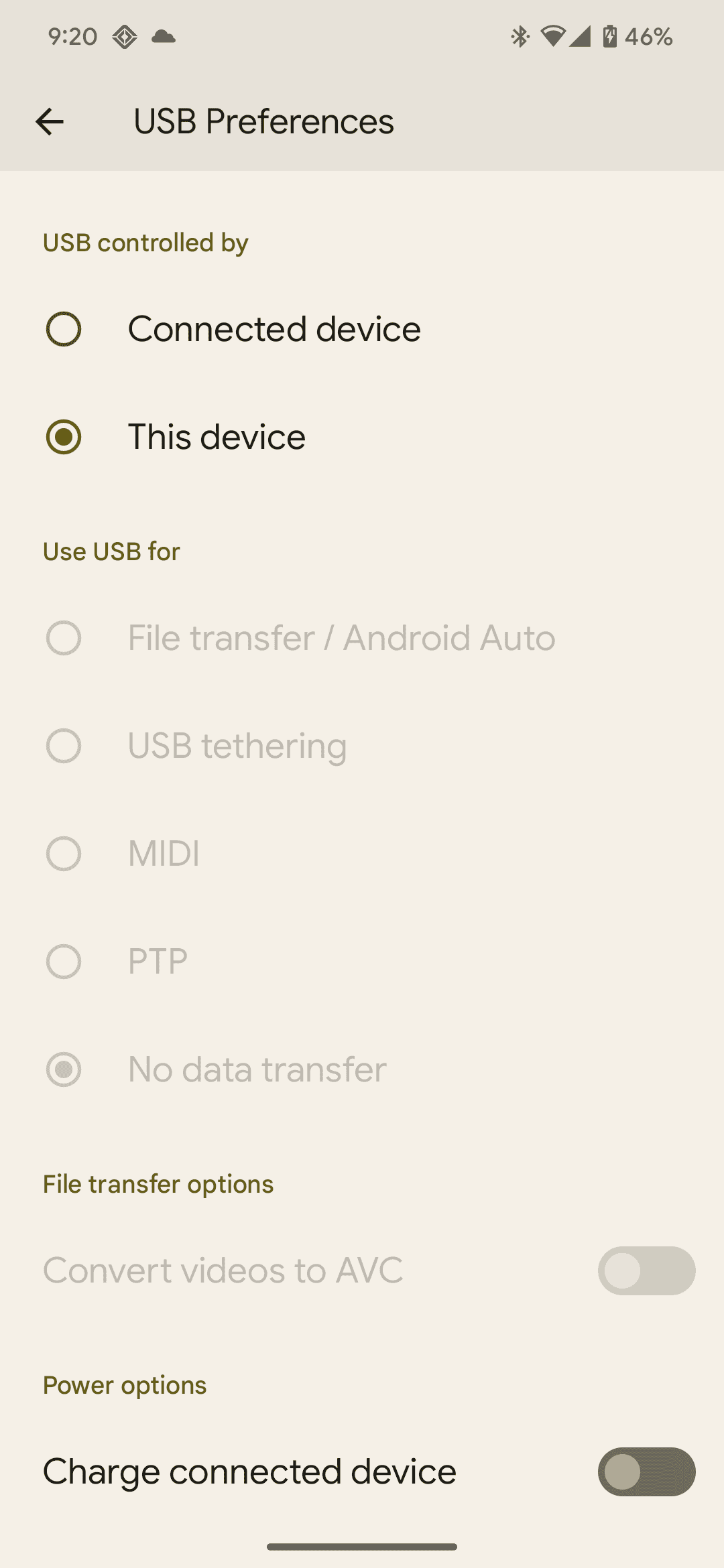

Thank you all for your advice. Got back to my speaker after it was fully charged via wall plug and found the following:
If turned on and then plugged in the speaker charges the phone
If turned off and then plugged in the speaker charges itself from the phone
Neither allowed the phone to change these settings in the app and both situations still said "couldn't switch".

I experienced the same problem with a Samsung S6 tablet and a Pixel 7 Pro phone.
The tablet has no interface that I can find to control the USB connection, but it seemed to be depleting it's battery (no charging icon, percentage decreased while watching it) while the camp speaker displayed it's throbbing light near its USB-C.
With the phone, I saw the same interface as OP. I was unable to switch any options. When I tried, the phone reported it couldn't switch.
Rivian R1T R1S Camp Speaker Drains Phone Battery Screenshot_20230824-212035
After trying to toggle both "USB controlled by" and "charge connected device" options off multiple times, and without power cycling the camp speaker, I unplugged and replugged and the phone switched to self-control and not charging the connected device. The charging icon also showed up over the battery in my phone's system tray. While I type this, my phone has gone from 44 to 47%.
It seems unintuitive and difficult to control, and I have no knowledge of how these devices handshake and negotiate, but it sort of works in this context. But when I plugged it back into the tablet, the tablet is charging the speaker again and I can't find any interface to hack at it.
I think the post above yours should do the trick for you. If it does I can update my initial post with that suggestions. Good luck!
