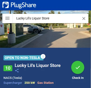

A quick look at PlugShare shows that there are Tesla SC's in Kalispell that are open to us:
Rivian R1T R1S Camping at Glacier Park 1750687125130-q0
If Kalispell is on your route you could charge up to 90% or so there on your way into and out of the park and you'd likely be fine.
