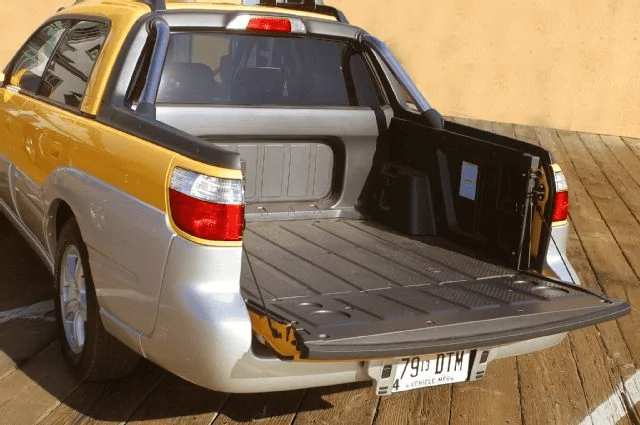

They should do like the Subaru Baja and have the plate on a rotating mount so it folds out to be displayed properly when the tailgate is open:
