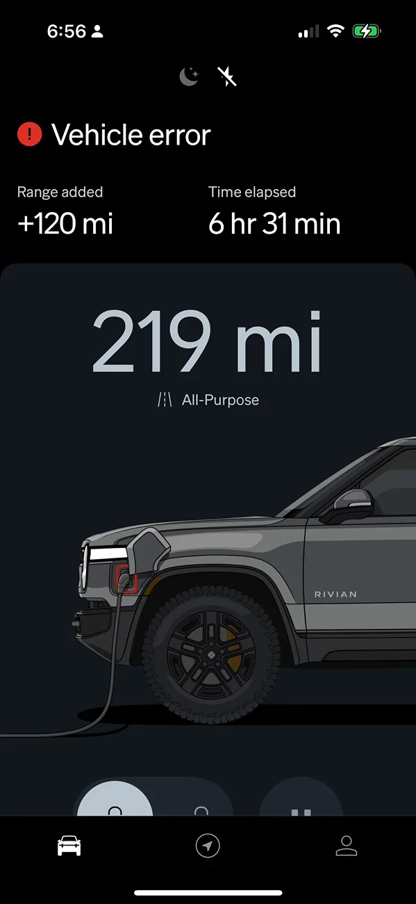

Since the last update I have seen this error 3 times now. It’s charging L2 and just randomly stops after a few hours. Anyone else?

This happened to me. In my case the 240V outlet couldn't handle the amperage and the circuit breaker trip.
Maybe limit the amps in the R1's energy screen to see if that helps? It could be the power is fluctuating too much on the outlet.
Yes - same here. Was told by mobile service tech that a software fix is coming. However, my coolant was about half filled which may be impacting the conditions as well.
The thresholds on heat were changed which may or may not be a good thing. Those thresholds may be why tge errors occur.

Thanks for the confirmation. It consistently does it now and am no longer able to rely on charging overnight.
Service request number 5 going in! ?
