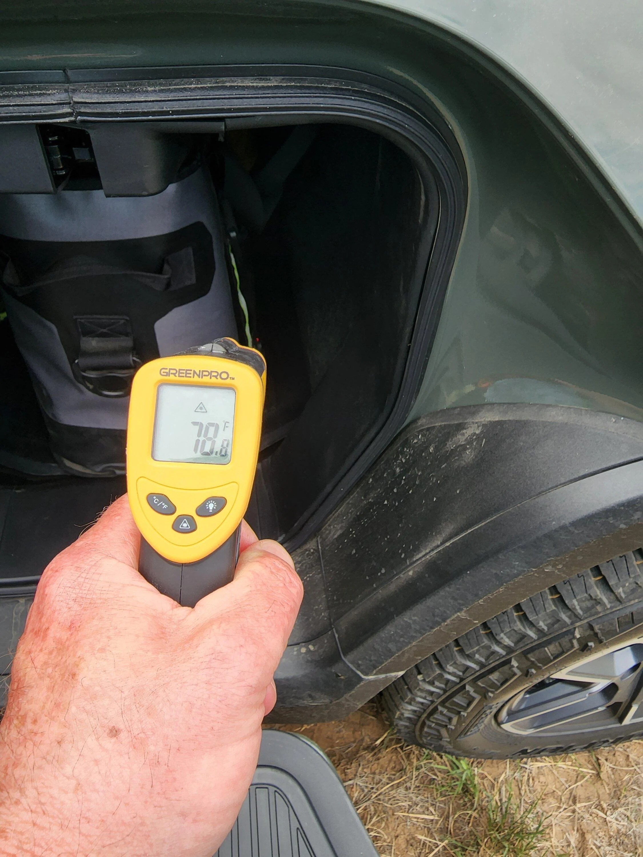

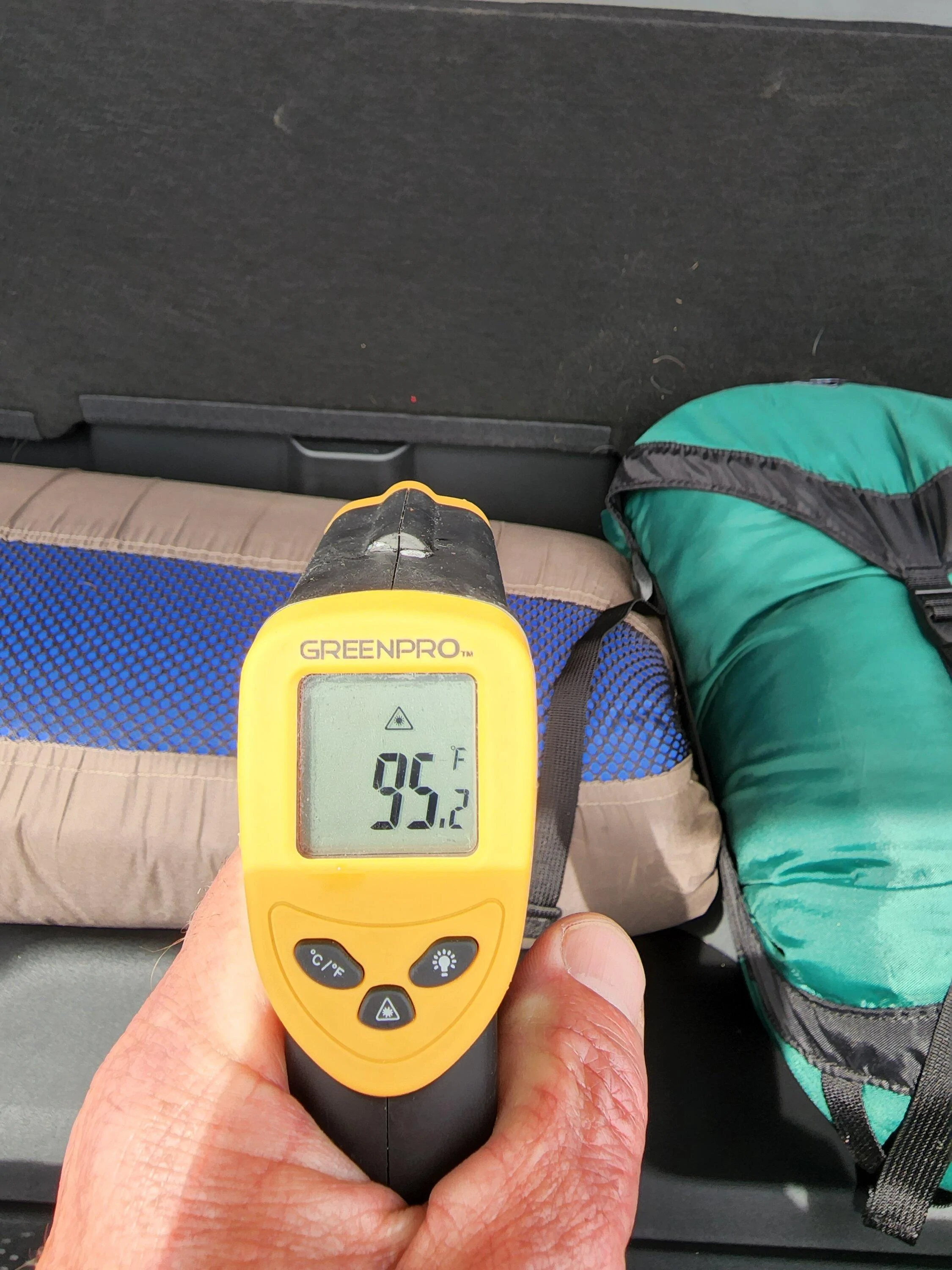

No you are not thinking of the correct material. This is a very thin sheet 18x18 that has a reflective barrier and a layer of woven silica with an adhesive backing. I’ve used this product on some builds for off road vehicles and it works well. I will happily provide readings before and after if my truck ever gets built?

Thanks for the data point. You're using an infrared thermometer which measures the surface temperature of whatever you're pointing it at. It's helpful but an ambient air thermometer data would be more useful. I'm assuming the air temp would get quite a bit higher than 95 degrees in there, maybe by about 10-15 degrees.
