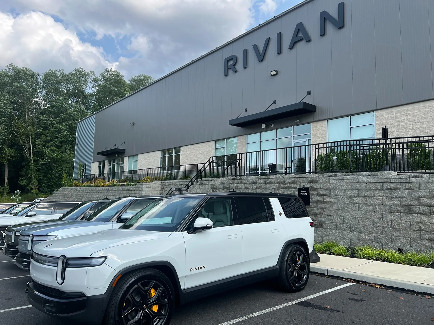

Took delivery of my new 2025 Gen2 Tri on Friday - couldn't be happier (pic attached)! A few imperfections noted but my expectations were set going in so no deal breakers. My apologies if this was posted anywhere previously, but I couldn't find much information regarding defaulting drive modes.
