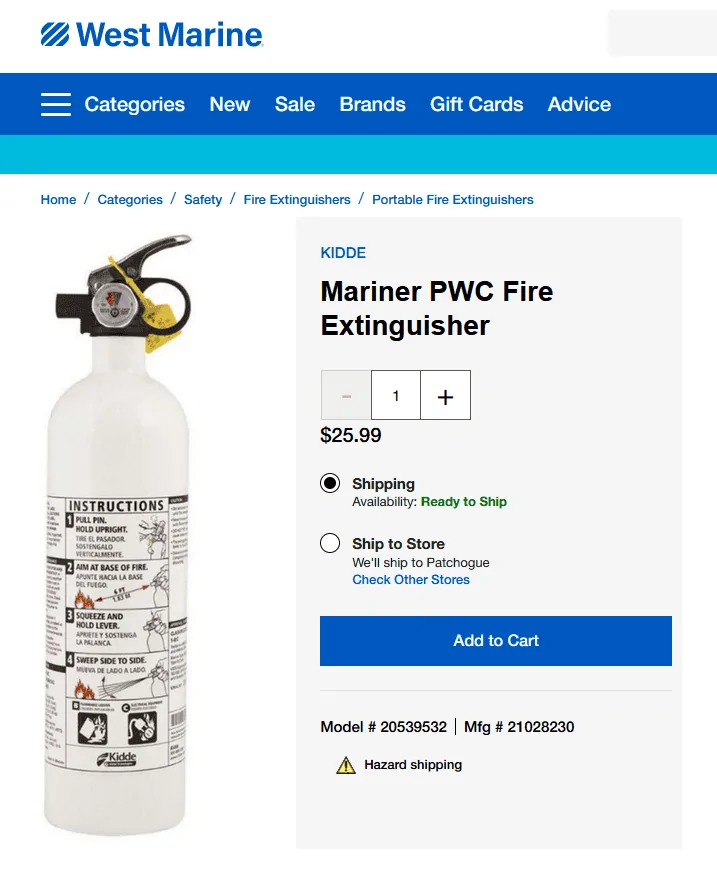

Wow - great conversation! I understand the value of the chemical fire extinguishers, and have one in my FJ40 and boat (both have carburetors!). The concern I have is the capacity, if you’ve ever used that small Kidde 8-12 sec isn’t going to buy you much. These discharging 50-100 sec is a big deal if they work. I’ve reached out to manufacturer on their performance on EV fires, keeping in mind no hand held is going to extinguish a full on battery pack fire. I’m looking on prevention before it gets to that ?
