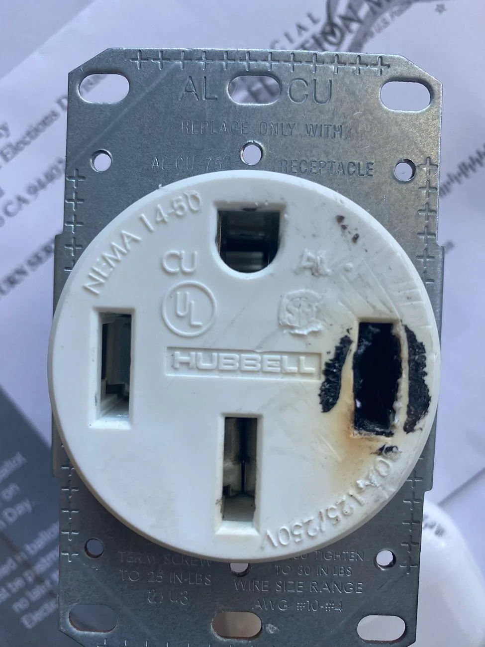

Electrical issues are a genuine threat if not treated with respect and professionalism.
The images below are from a previous NEMA 14-50 that my electrician installed for one of my EVSEs in the garage. I caught it before it burned my house down.
PSA - Only install commercial-grade connectors if you're using a plug-in EVSE. Ideally, hardwire. Consumer / dryer-grade are simply not rated for the duty cycle of a constant 40-amp draw, and will inevitably fail.
Man I've seen so many of these melt and catch fire. From my perspective, it's just not worth the time and money saved from not hardwiring your charger and making sure everything is code compliant.

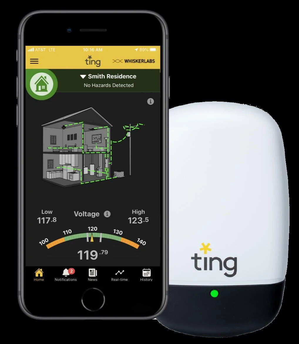

I've had a plug melt due to a loose connection as well. Recently my homeowners insurance company sent me these devices from Ting that monitor all of the electrical circuits and notify you if there is an anomaly. (Homeowners provided them for free but they sell on website for $99.)
https://www.tingfire.com/

The NEMA plugs definitely have limitations that 'heavy users' (frequent plug/unplug cycles) need to be aware of, because dirt and corrosion on the pin/socket present high resistance and arcing. But the less visible side of the connection where the wires are clamped inside the receptacle are more likely to go undetected. Also the person that makes these connections had better have a good understanding of the critical 'area of contact' in this regard. A competent installer will ensure this integrity by clamping hard enough to deform the copper wires inside the receptacle, which can easily increase this critical area of contact by a huge margin. A properly clamped wire will not present a resistor in the circuit, an improperly clamped wire is a time bomb.
One more useful comment; the photo's showing extensive heat damage DEFINITELY heated the plug, so if you use a connection like this, then it's a good idea to pay attention to this, and if the plug is warm/hot, investigate!

The problem is not the unplugging and plugging back in, it is the repeated heating and cooling cycles of the charging that will weaken the spring tension of the receptacle. Other issues are often the actual wire to receptacle connection, the heating and cooling and loosen up the contact and that is where the melting, arching and eventually burning can start from, especially if the screw mushes (spreads) the wires under the screw with stranded connectors.
FYI, Hubble is such a brand name that it is commonly call out in electrical specs.
I'll wager that the fault with that outlet was the connection for the wire wasn't properly tightened. With stranded wire, after the initial tightening, you have to wiggle the wire around to get the strands seated, then tighten it again. If you fail to do this, the heat/cool cycle will eventually loosen the connection. That causes the heating shown on this plug.
But, yah, only buy high quality, name brand electrical components, like Hubble.
Agree. And from switch breaker panel to outlet or hardwired unit, torque the connections!
No no no!!
Be super careful - Hubbell is great but they do offer different grades of product. The one shown is standard grade that gets installed all the time for dryers etc. many electricians didn’t understand this when they installed home L2 units.
You must use a commercial grade if you want to support the duty cycle of an EVSE.
