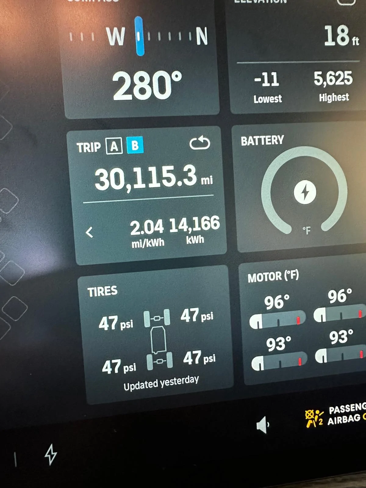

We got 2.04 with over 30k. On our 2022 Quad. This includes thousands of miles of pulling our camper at 1.1-1.3 on 22” tires. Btw, we just traded for a PDM Max Pack. On a road trip currently. We got closed to 348 miles on the highway yesterday. Ideal conditions..82 degrees and ~76 mph.
Rivian R1T R1S First 10k Miles, Exact EPA Efficiency Match IMG_8867
