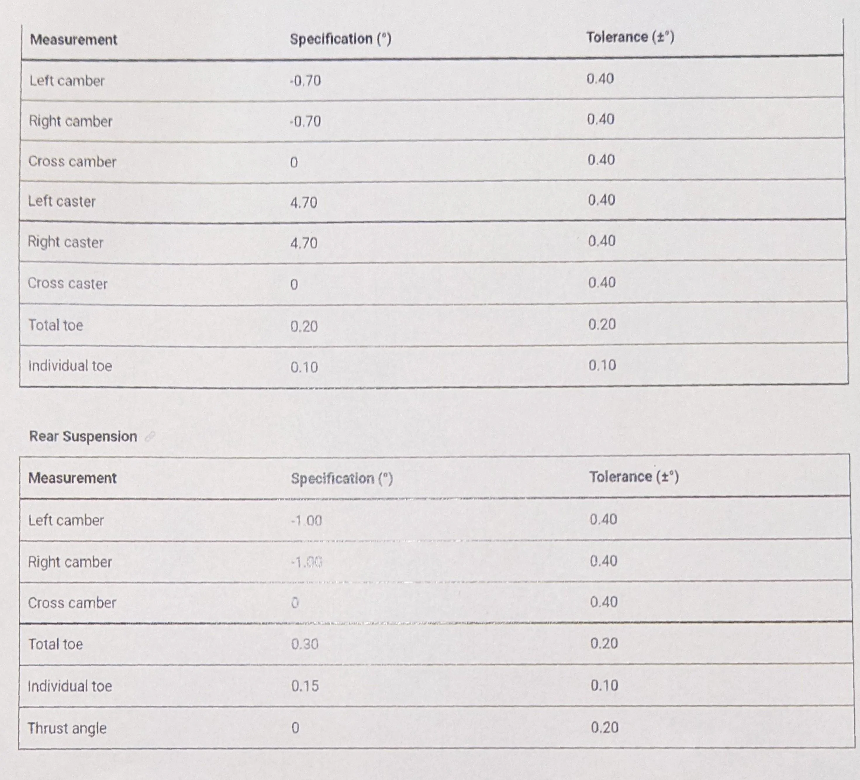

They update the software as well? Mobile tech says you have to update some parts of the software when they do alignment
I doubt that. Here are the specs if the shop you go to needs them.

Nice Specs. As I live 150 miles from the Denver Service Center so I will take these to the local shops to see if they can manage. But a couple of questions, are the spec the same for the R1S vs. R1T?? Does the model year matter?
Thank you in advance.
