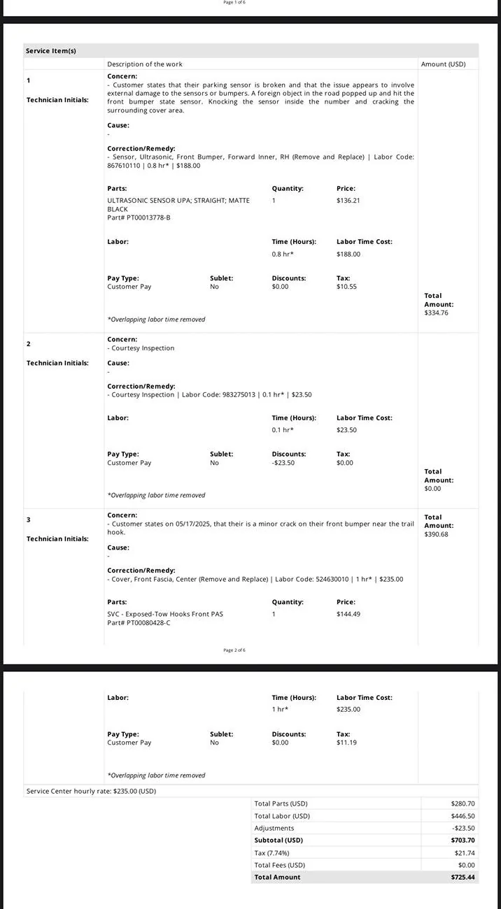

I had one pop inward after being hit by road debris. This resulted in a 3mm crack in the black plastic surrounding it. After a two month wait for an appointment in San Diego, Rivian swapped it out.
Total cost was $750. The parts were about $300 and the rest was labor. They told me that they had to take the whole front fascia off as one huge purse. This included tuwbfirst level of painted areas. If it was just the sensor they can stop there. But since they needed to replace that surround they had to undo several layers of parts to replace it.

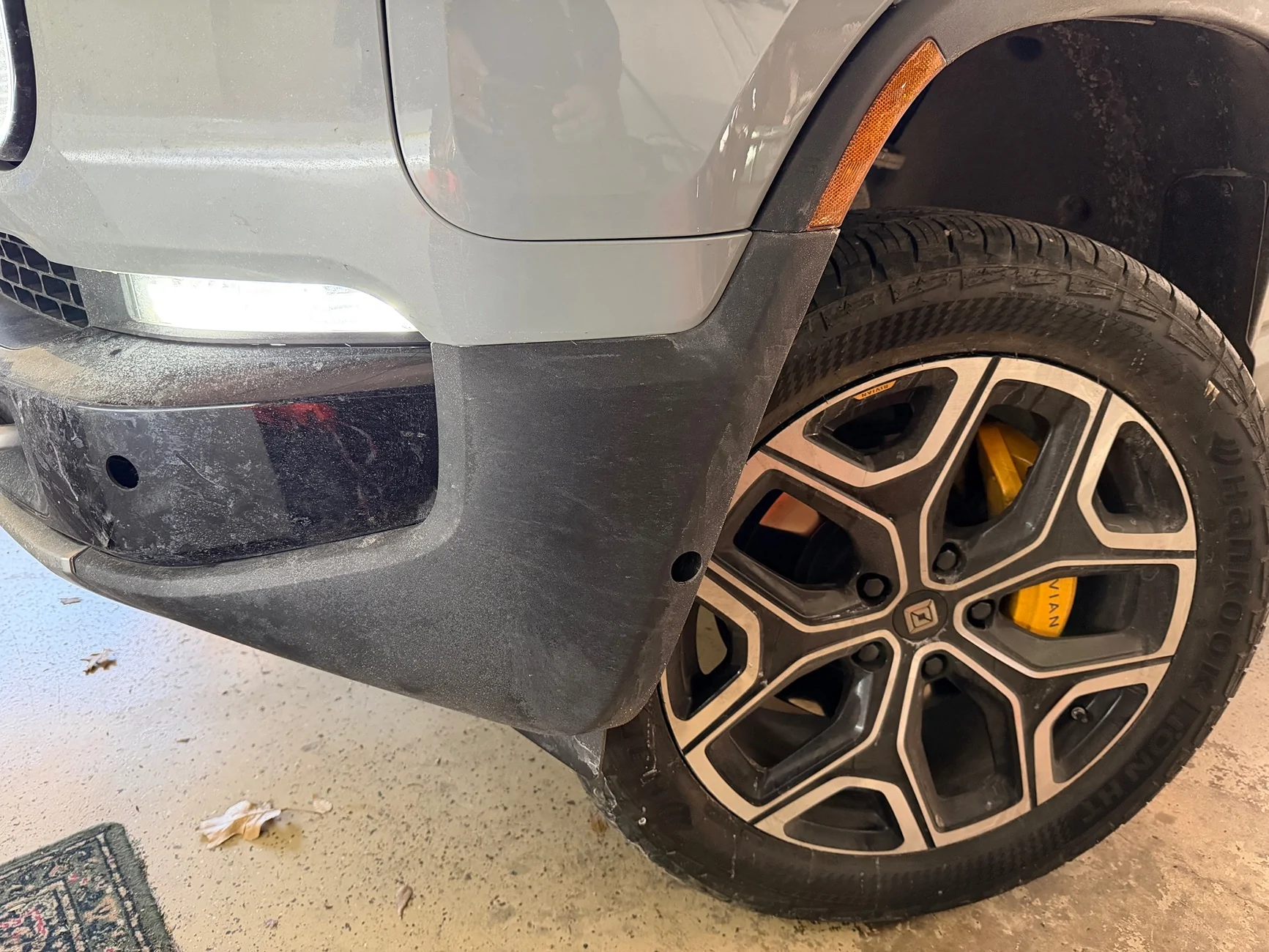

Thank you! Image attached. It’s one near the driver side tow hook.

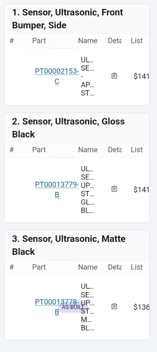

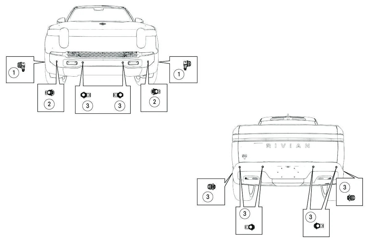

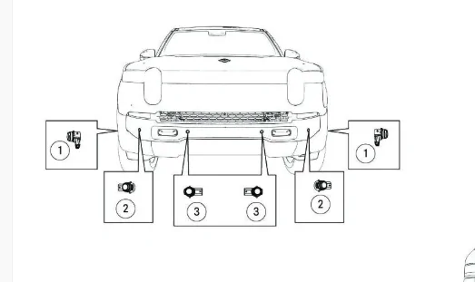

So #3 for you, PT00013778 . eBay has a ton new or used in a range of prices.
Your pictures look like a Gen 1 so I'll DM those instructions. Easy part is replacing it, hard part is pulling off the front fascia. You have to loosen or remove the front of the wheel liner for that as well.
