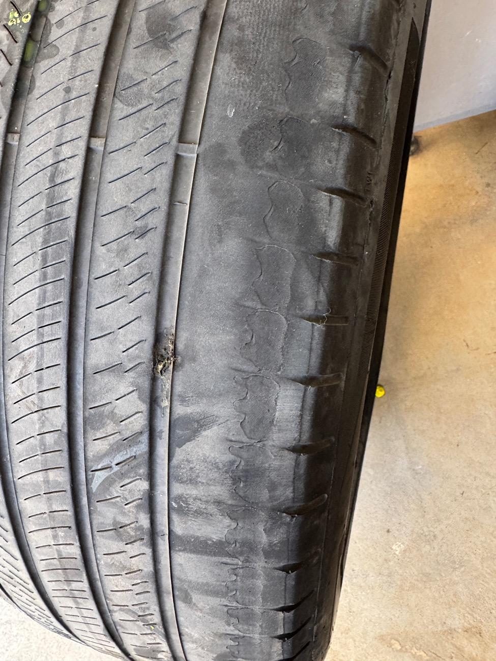

I have mine in for service now. When I got there and they did the walk around with me he said my tires were just about shot. 29,xxx miles on the original 22” pirelli’s is pretty good if you ask me. He said look, turned my tires and showed how they are wearing badly inside. I never drive in very low and do not go crazy while driving. He said it is 100% the alignment.
I knew I needed one but i guess I waited too long to get it.
so that is my guess for you, alignment.
good luck!

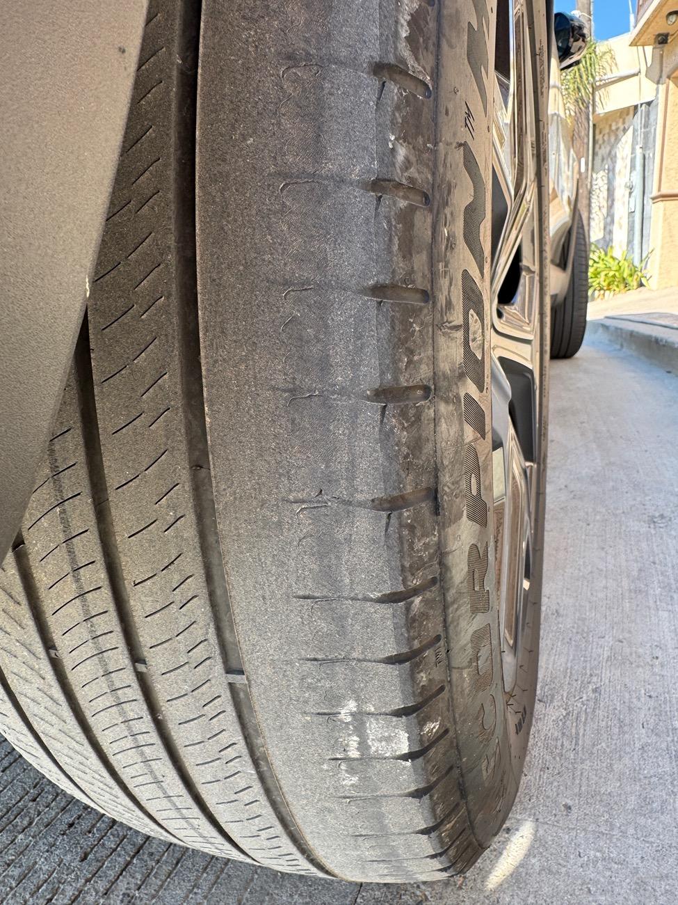

Alignment issues. These tires had 2100 miles on them. All 4 were replaced due to bad alignment on the rear tires.
