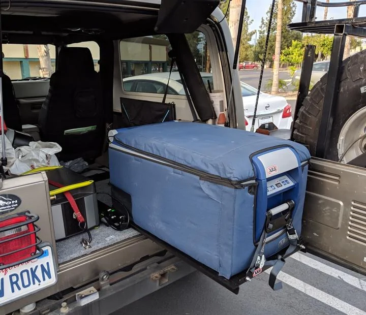

Has anybody seen measurements for the frunk and gear tunnel? I am curious if my ARB fridge will fit in the frunk.
Can't answer the question but I can, in the hopes that Rivian is watching, express the hope that the frunk will be equipped with a switched 12V power point that, whenever the switch is on, remains energized, even though the vehicle is parked, for just this application. Of course it would be nice if this power point were de-energized, regardless of switch position, when the battery gets below a safety level.
An earlier post reveals that the gear tunnel has a 110V outlet in it. I suppose the frunk could use one too but 12V ones are handy too because the ARB fridges (and I assume others like them) have 12V compressors. When run on AC it must be rectified losing some battery energy as heat.
I think 12V is a given, and my ARB fridge will definitely be in the frunk from time to time; it can run AC or DC, but DC would obviously be preferred.
ajdelange
A. J.
Aug 1, 2019
2,883
2,319
Virginia/Quebec
EE Retired
I wouldn't say it's obvious that 12V is to be preferred unless your reason is other than the one I am thinking of. The ARBs have 12V compressors. When they are run on 120 that 12 V comes from a rectifier/power supply in the unit. As that power supply is not 100% efficient there is some energy lost when the unit runs on AC. It is small but these things only take about 20 W when run on DC so even a watt or 2 represents an appreciable percentage loss.

I am wondering how effective this type of fridge will be in an enclosed space like that, whether it fits or not. The fridge will heat the frunk, and if the frunk cannot dissipate that heat, the refrigerator will become less and less effective. I have one that we keep in the back of our Model X and if the cabin gets very hot, it can spend a lot of time running to keep up.
I suppose it is a case by case basis; whether the owner has it set to freeze or refrigerate, ambient air temps, etc. But it is likely a consideration.

No question that the further uphill it has to pump the heat, IOW, the hotter the outside is, the less "efficient" the refrigerator becomes so that it has to draw more current to maintain its interior temperature as it becomes warmer outside. There's really a triple whammy here. First, the thermodynamic efficiency drops, second the head pressure goes up so the compressor has to work harder and finally more heat flows into the compartment through the insulation. It's clear that if you park the vehicle in the sun and leave it the fridge is going to draw more current than when underway. The only relatively good news here is that these refrigerators just don't draw much so that the solar load, when parked, is probably appreciably greater than the extra heat from the fridge. But frunk or trunk one should, when parked, try to keep the solar load down and run the cabin A/C if this is feasible (if it's in the cabin).
Interestingly enough I just stumbled across some puff piece on Rivien that said they are offering a refrigerator for the frunk. Makes sense, really. Given this I suppose the frunk is vented to keep heat shed from a refrigerator condenser from building up the temperature in it. Simple fan and thermostat? Totally passive?
I hope the frunk is vented. The confined space is definitely a consideration. I have left my ARB locked up in my Jeep in the hot desert sun a couple of times. I am sure the fridge didn't like it but it worked very well. Kept everything where I had it set at just above freezing. My 100W solar panel more than made up for power usage too.
