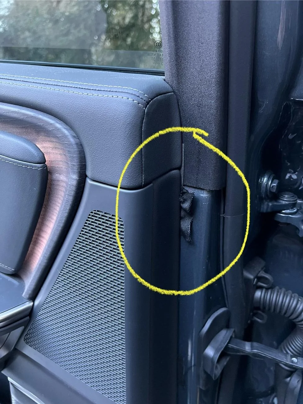

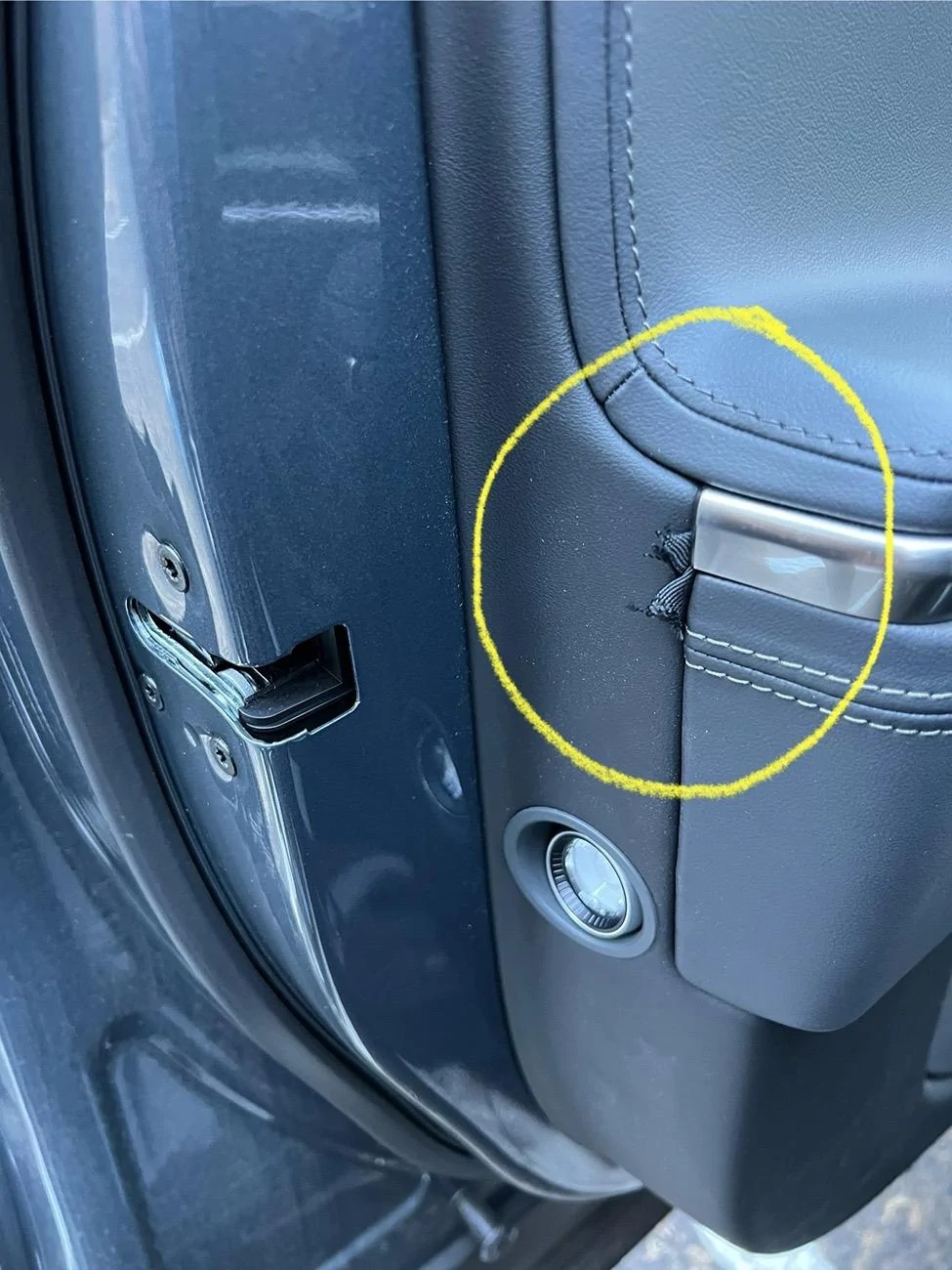

I've also suffered from rattles from (seemingly) all 4 doors on my R1S. A few mobile tech visits helped for awhile, but they returned (or new ones developed). Recently, took the time to have my wife drive the car around while I systematically tried to isolate the rattles. For at least some of these, it appears to be caused by rubbing between the interior door panels and the metal door frame itself. Putting pressure with my hand on various places would pause the rattle. I took this further based on some other forum posts and carefully worked in small pieces of felt at suspect locations. I used a guitar pick and a tiny flathead screwdriver to slot the felt in certain places. Glamorous? No. Functional? After a few weeks, seems the answer is yes! Most of the more annoying rattles seem to be gone. Hope this might help a few others out there trying to quiet down the ride!
