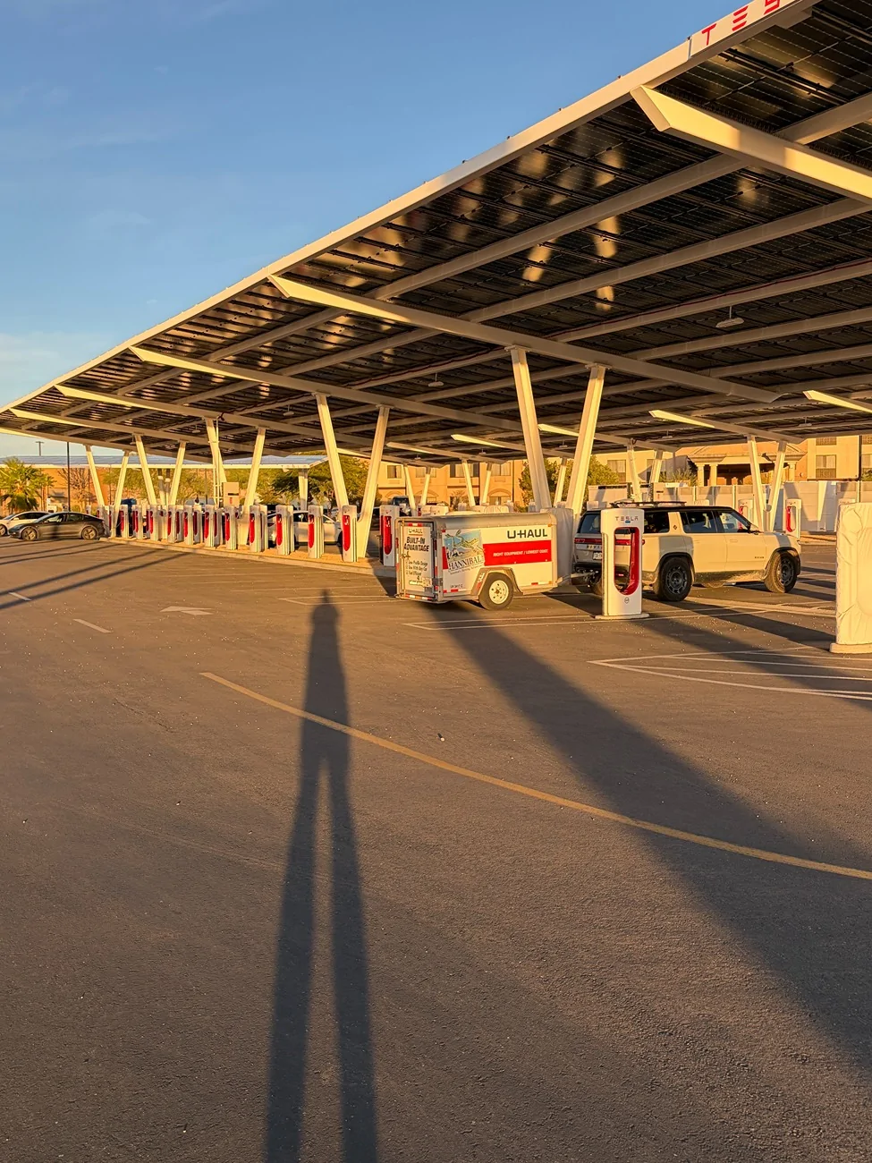

Charging while towing also continues to get easier. I love how practically every new Tesla station comes with a trailer pull through. Even the new Grand Junction one in the middle of a tight shopping center parking lot has a pull through (I think it's the only one in Junction, the RAN there doesn't as I recall?).
