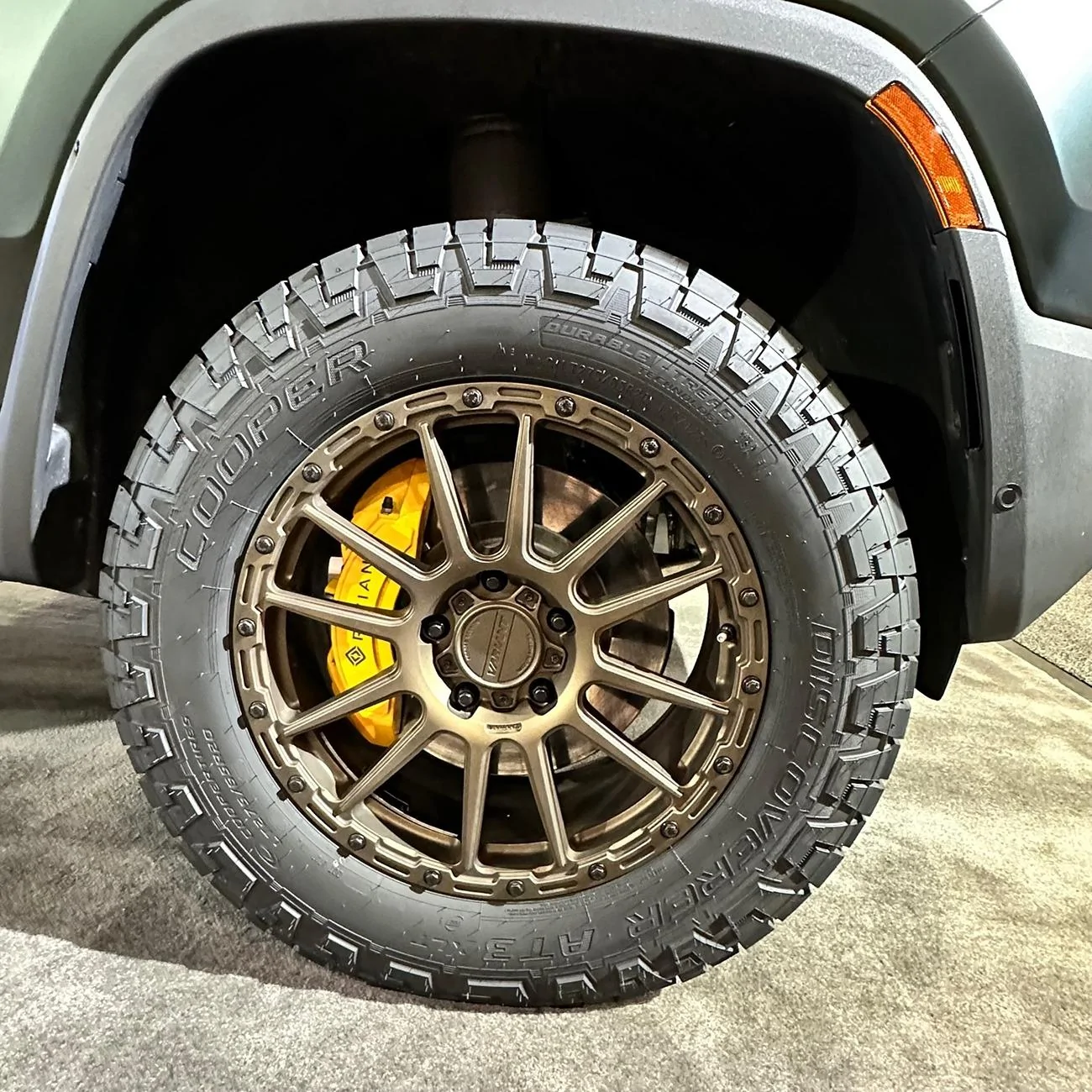

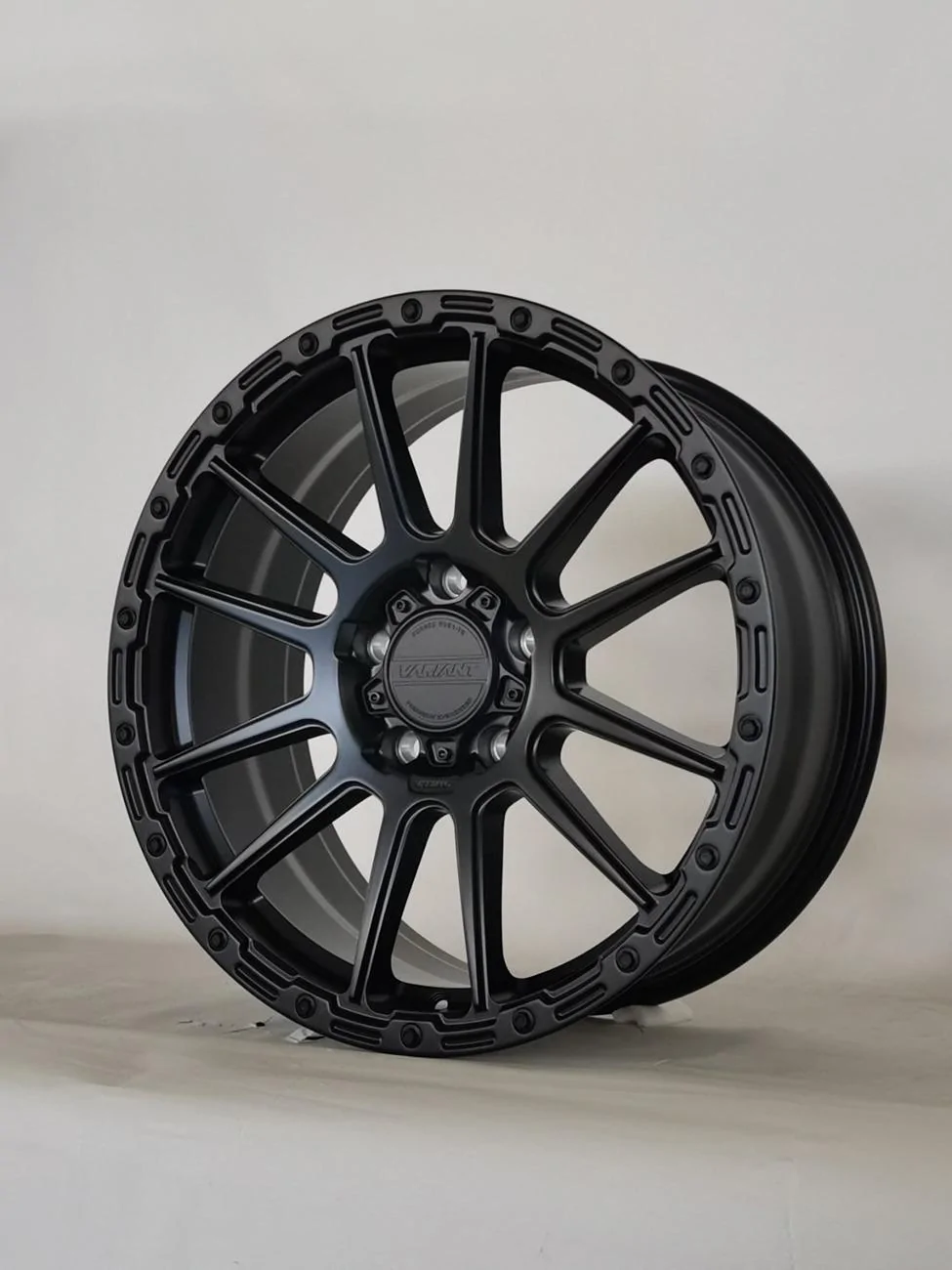

This has been a common question, and as noted, selecting the correct 20" tire size for your wheels eliminates the need for recalibration when transitioning to a 20" configuration,
On a related note, we have one set of our custom forged Variant Wheels in Satin Black remaining from our large pre-order, arriving the third week of January. These are also 20" wheels, shown below in Triple Bronze on my R1T for reference. Last photo is actual 'Satn Black' which will be ready for shipment in 2 1/2 weeks.
Rivian Forgred 20" Variant Wheels LINK $695 EA

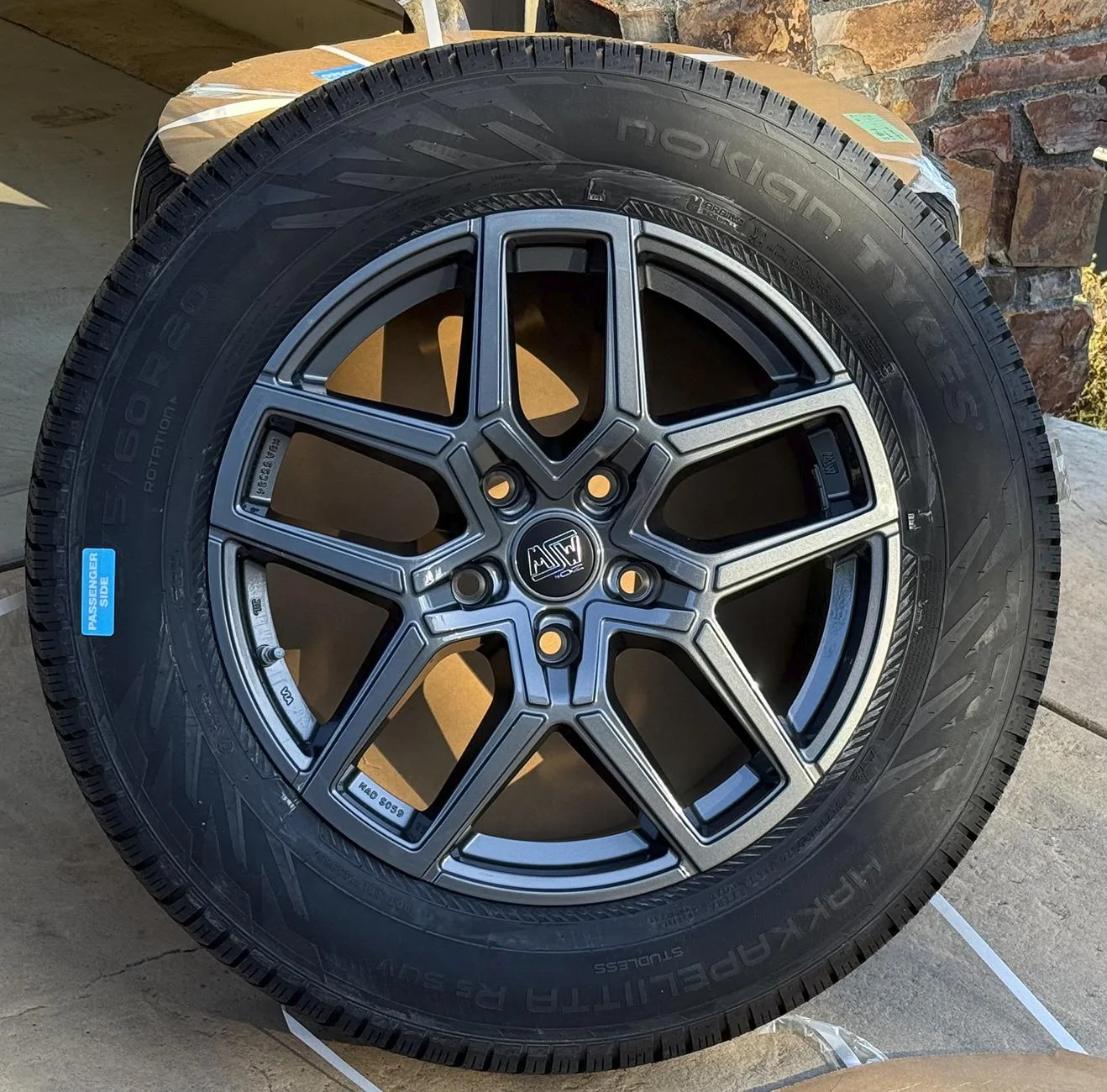

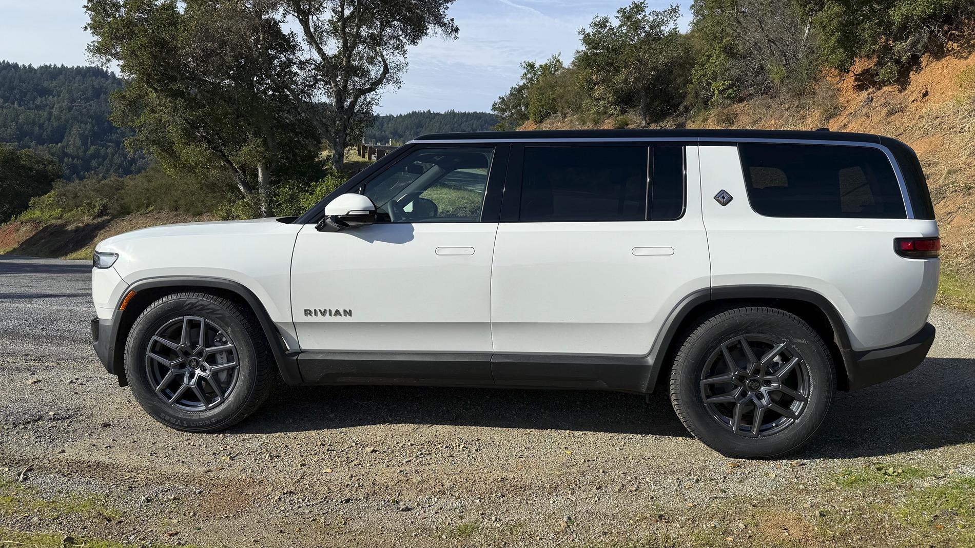

I've posted in another section of the forum, but in case you didn't see it: I ordered ours with the 22s & all seasons and just installed 20's with Haka R5 SUV (275/60R20's) for Tahoe. Tire size is spot on with the 275/50R22 Pirelli Scorpions and don't require any re-programming.
Years ago I'd seen the recommendation that a little more sidewall is better with snow tires? Have had great success with the Haka's on another vehicle - this setup is no different.
Originally wanted a different wheel, but these were all avail via tirerack - mounted, tpms installed and shipped to my home.
