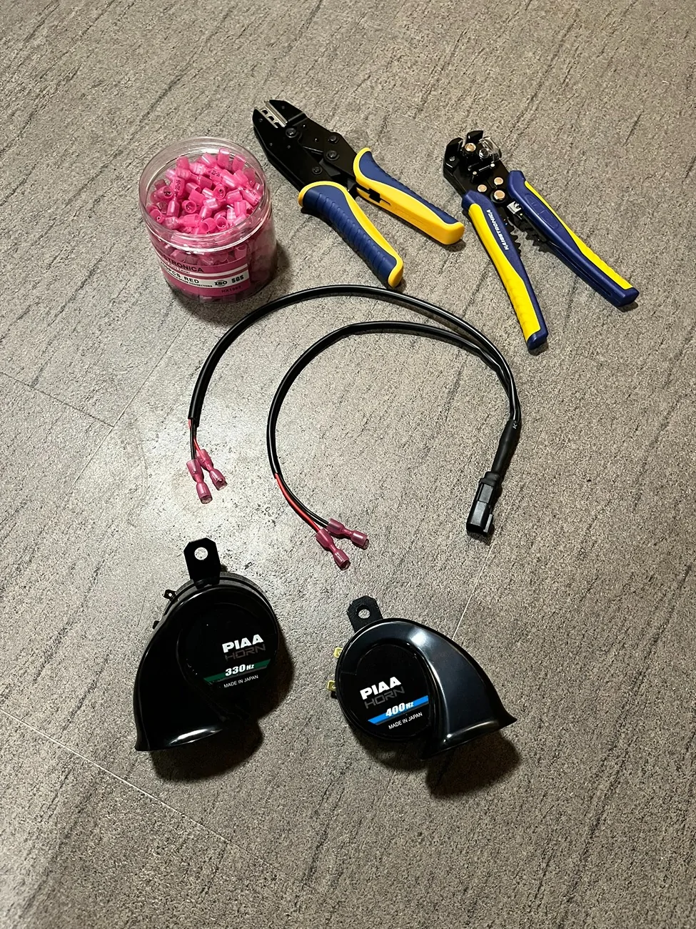

As soon as I get a weekend with some extra time, my plan is to install a PIAA Superior Bass horn set to replace my single horn (Gen1). I'm hoping to simply unplug the single horn and plug this setup in, then have beer to either celebrate my success or comfort my failure!

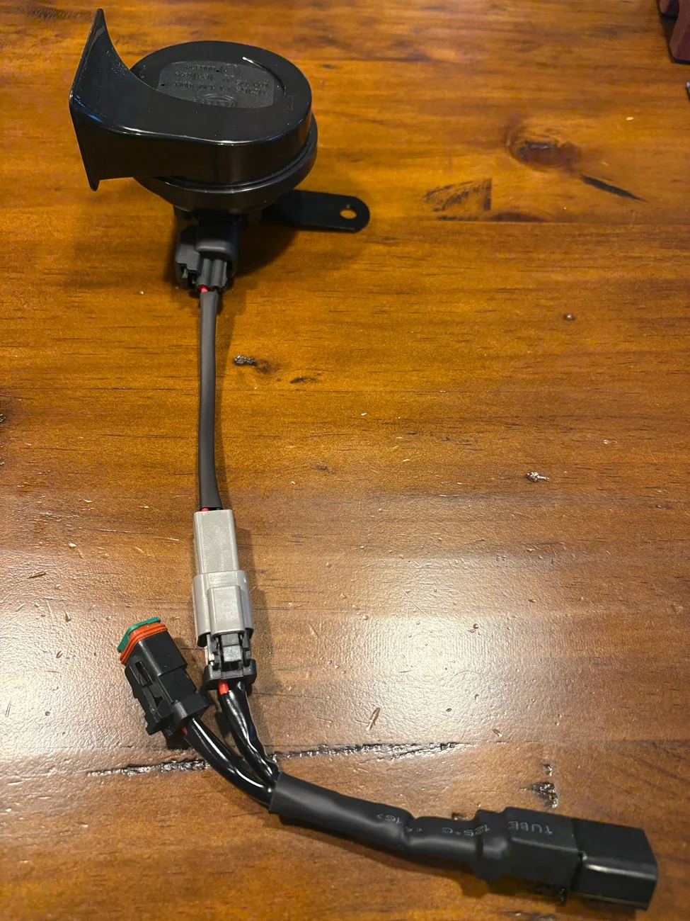

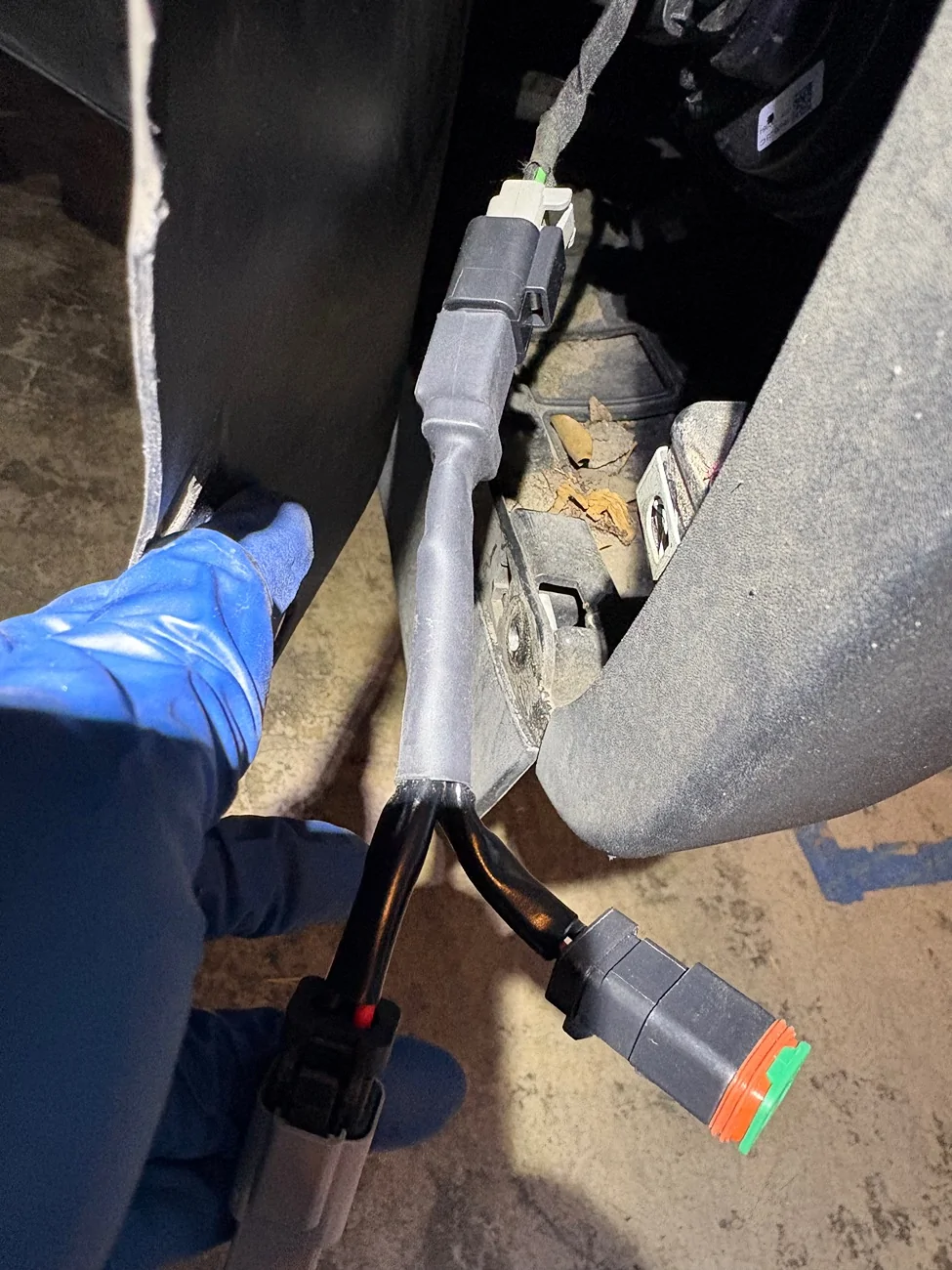

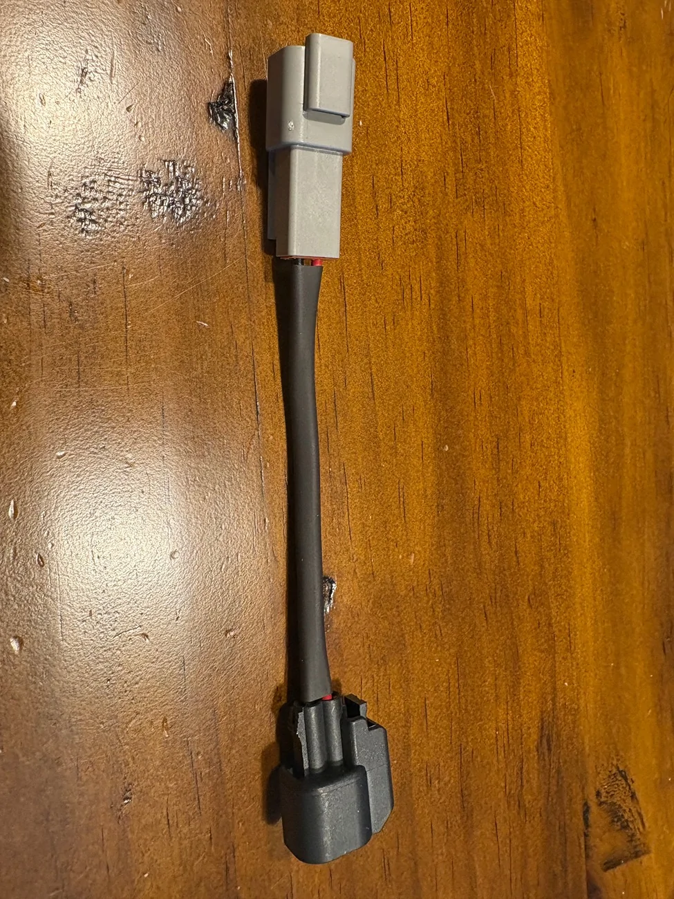

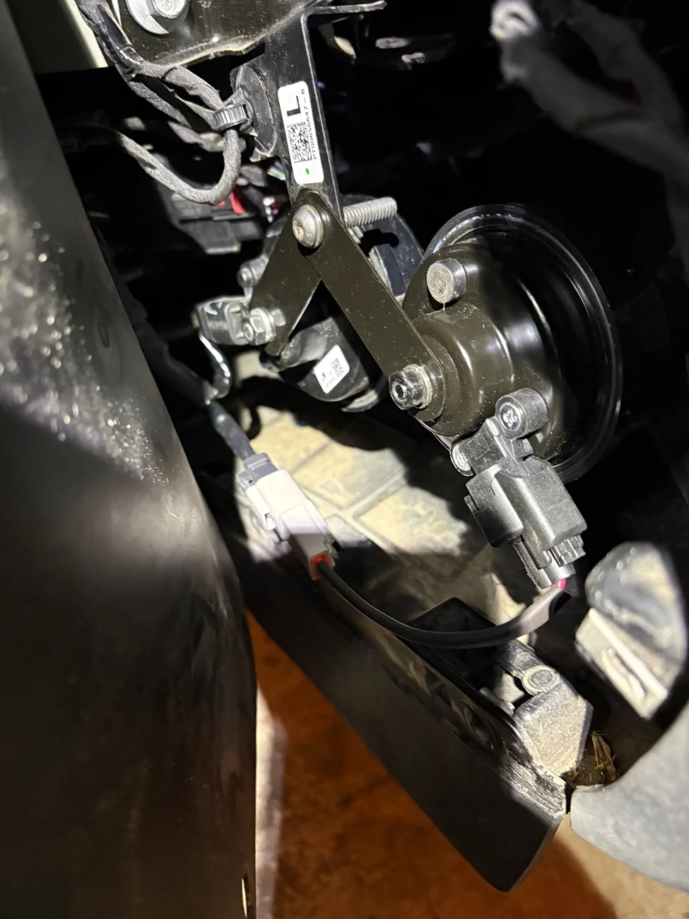

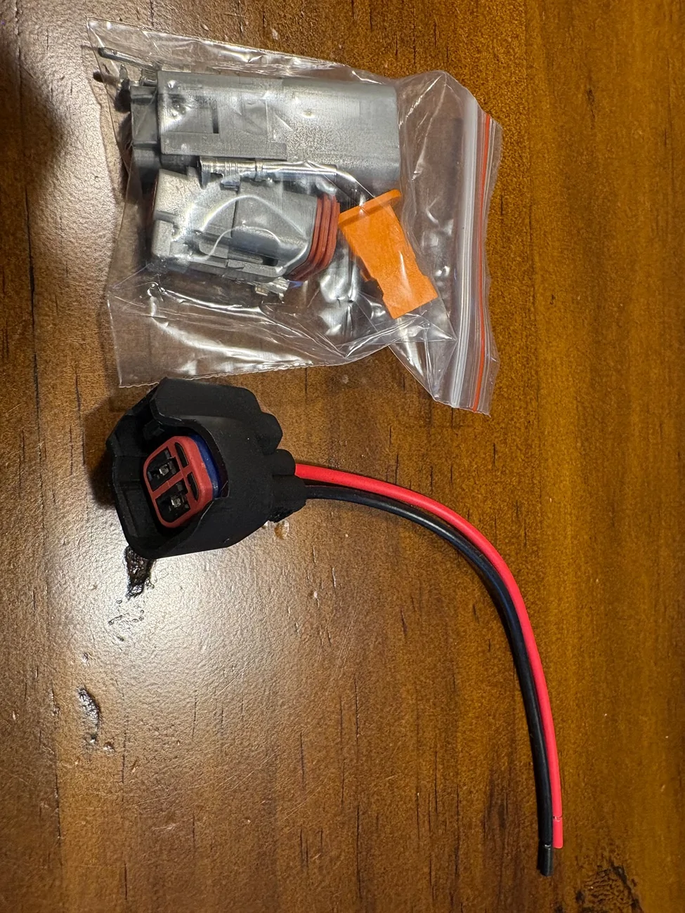

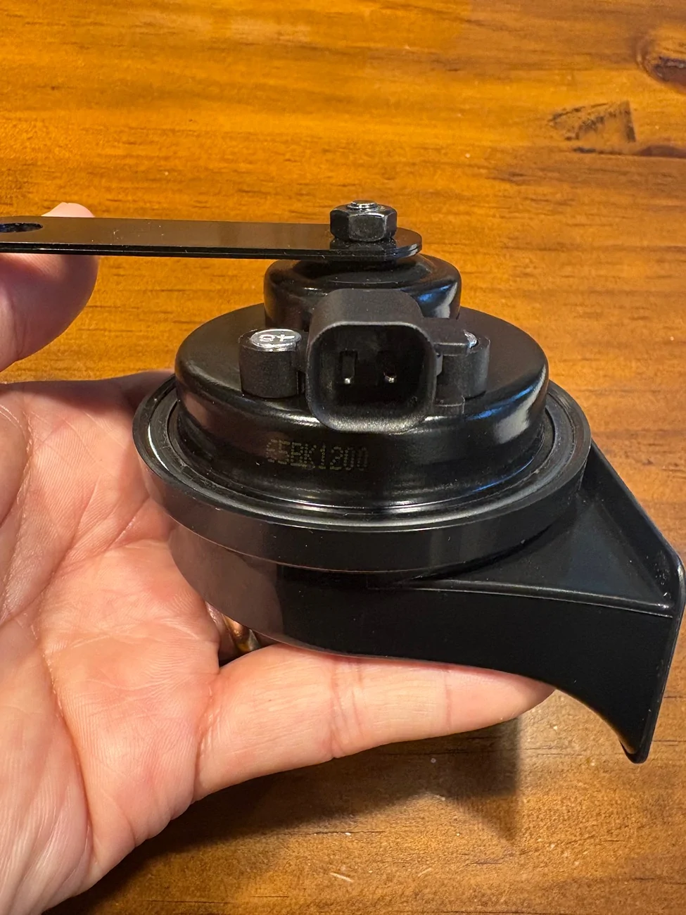

FWIW I just added a single 500hz Hella horn that has a USCAR connector (Ford/Chevy) to our 2025 R1S and it’s working fine so far. I made a USCAR to DT 2 pin adapter and connected it to one leg of a DT splitter. The USCAR/DT adapter goes to the new Hella horn, the other DT leg goes straight into the stock horn. My horn was located on the passenger side so it was easy to access by pulling back the fender liner, no frunk removal. I used the supplied brackets from the Hella horn to remount the two horns side by side using the original mounting hole. No spliced wires, water tight, and easily reversible. Pics and before/after sound clips if it helps, along with parts list. Less than $50 total and about an hour to install. The only thing I would change is getting a slightly longer DT splitter, maybe 10-12” vs the 7.5’s I got to make horn adjustment easier.
Hella Horns (Part #011225921 - USCAR pair, couldn’t find any singles so now I have an extra 400Hz horn)
DT connectors: https://www.amazon.com/MUQIDA-DT-Co...connector+2pin+kit+muqida,aps,176&sr=8-3&th=1
USCAR pigtails: https://www.amazon.com/Injector-Con...r+connectors+socket+plugs,aps,196&sr=8-2&th=1
DT Splitter: https://www.amazon.com/Universal-Sp...harness+splitters+deutsch,aps,155&sr=8-5&th=1
