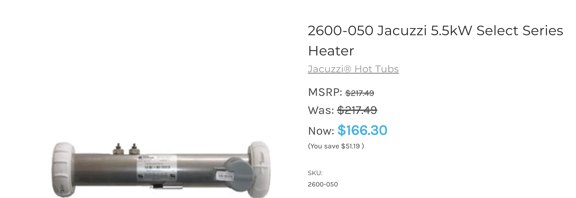

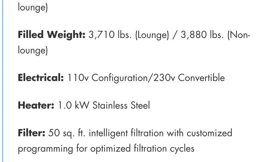

On the manufacturer's web site it says it is convertible to 230 VAC, so in theory converting to 230 VAC would make it a bit more efficient. 1 Kw will struggle in cold weather. If you wanted to hack it, you could probably upgrade the heater to something bigger, likely needing a contactor that could handle the bigger load.
