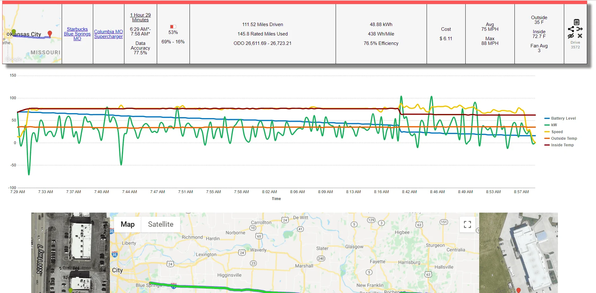

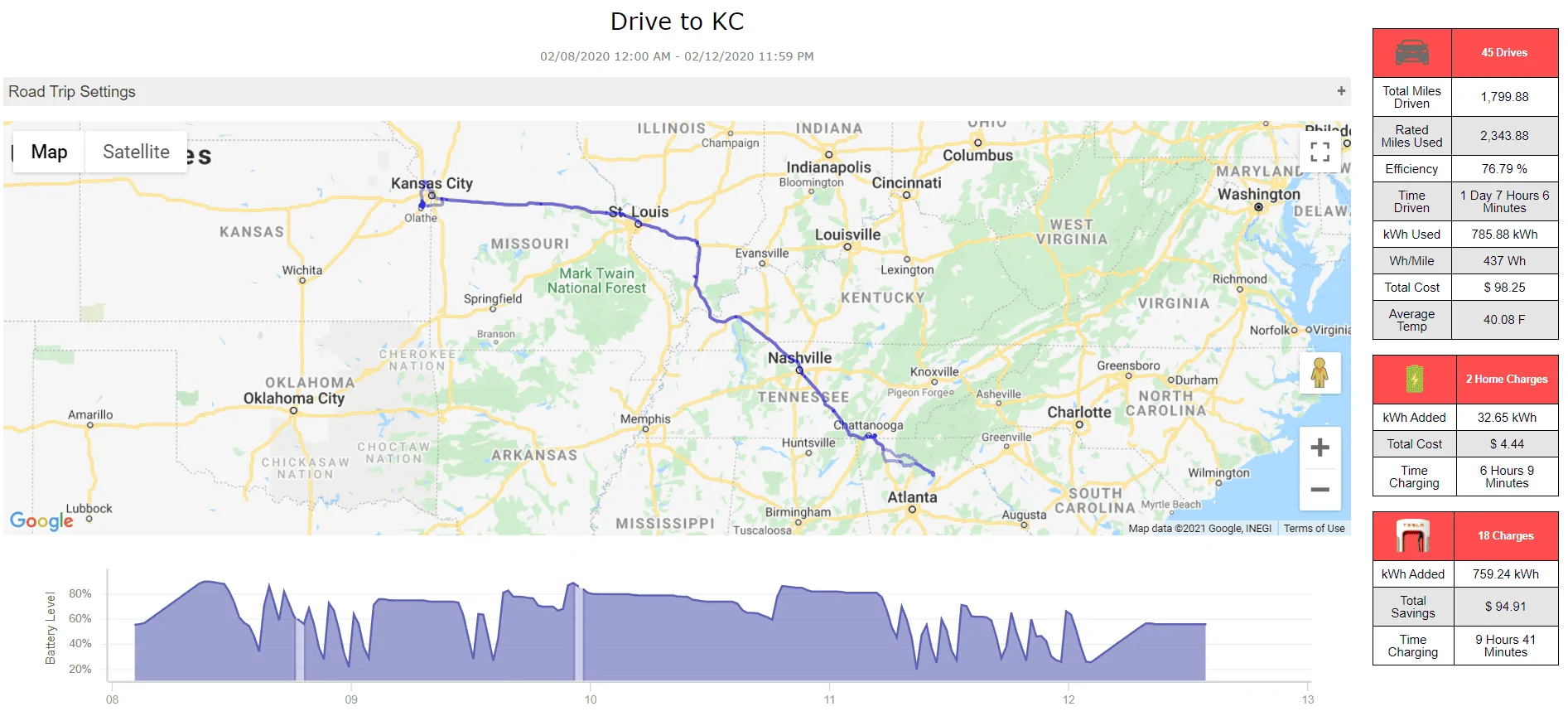

I don't know the answer, obviously. I hope you are right. It will be interesting to see what the real numbers turn out to be. We are really close to launch to still have to guess on such an important element of the vehicles. But, if the published info doesn't change, with a rated range of about 428Wh/mi, highway travel at 70-75 for a premium of just 22Wh/mi will be difficult with the frontal area of R1S/T.
Out of curiosity, I looked up a recent trip to Kansas City and back in my X. I averaged 437Wh/mi with nearly all of it being highway travel. That is a 27.8% premium over the rated range.
We know how Tesla games the EPA ratings somewhat, so that factors in as well. I'm also curious, how fast were you going?
Tesla is aggressive in their range projections. I agree that factors in. Hopefully, Rivian is NOT like Tesla in their gamesmanship of the range numbers.
On that trip, it looks like I mostly used cruise control at 77mph. Averge speed 75.
