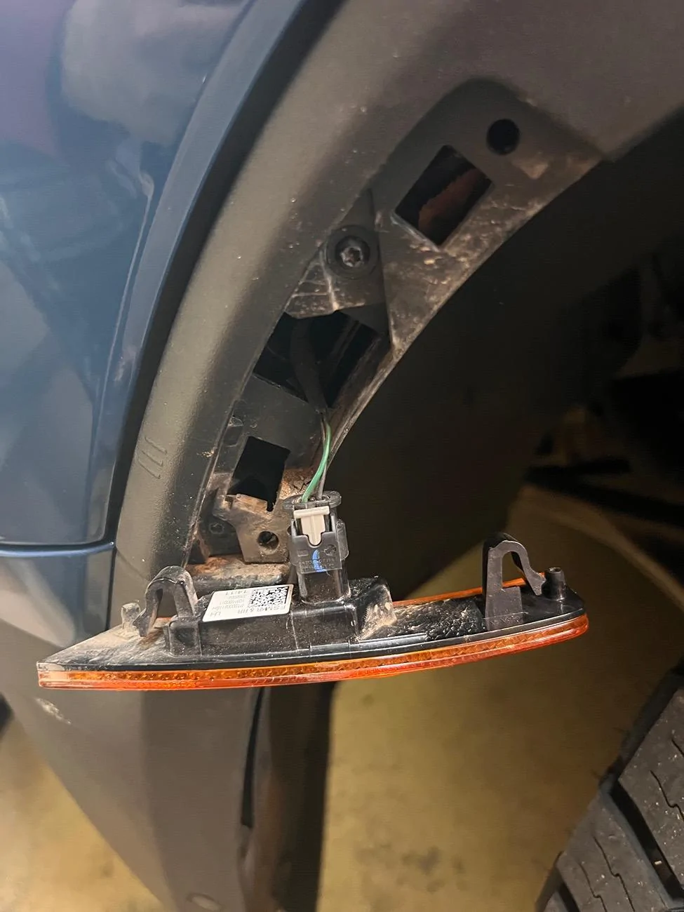

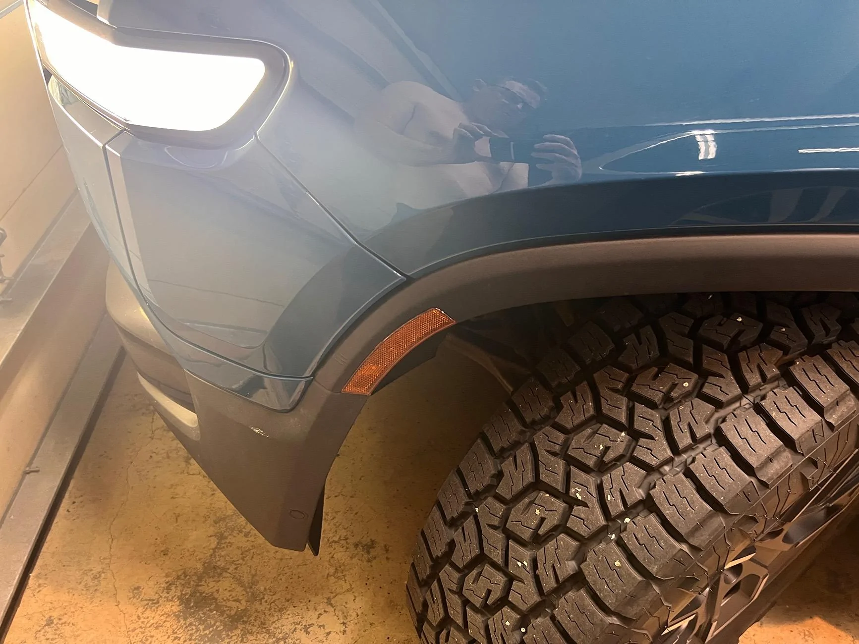

Anyone know how to pop the amber marker lights on the front wheel wells off or otherwise access the wires to these lights?
I’m installing a Switch Pro and it looks like this would be a good trigger for IGN/Go/Ready. As long as the light setting isn’t fully off, these lights come on when you hit the brake peddle and stay on until exiting the vehicle. They don’t come on when the truck wakes or is unlocked.

Use a trim tool, or just a flathead screwdriver, and they pop right out. No mess, no fuss.
