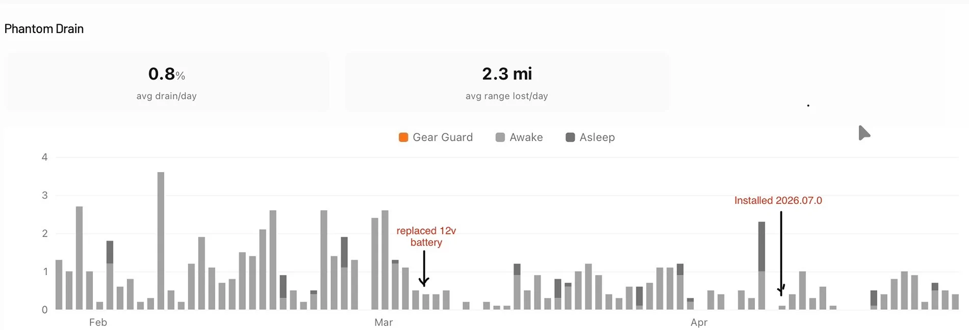

My phantom drain was between 1.5-2kWh per day. It is now 0.8kWh. This is better than what I experienced this time last year when I monitored this a bit more. Also, after a charge my SOC stays consistent for three days. See the gap in April where no data exists.
This is a noticeable improvement.
Courtesy of Rivian Roamer:
Rivian R1T R1S Improved phantom / standby battery drain after new update IMG_1053

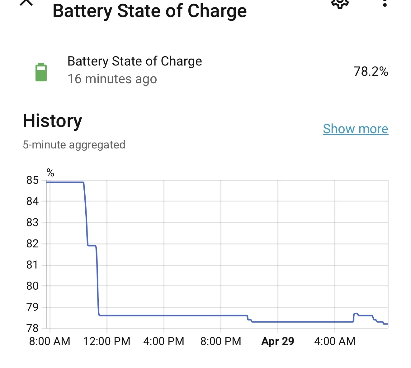

I noticed the battery SOC seems to fluctuate. See the pic below from Home Assistant. While sitting in my driveway unplugged the SOC goes from 78.6% at 9:45pm to 78.3% at around 10pm, a reduction which is normal but, it stays there until 5am this morning and jumps to 78.7%. Then it starts to drop again to 78.3% by 7:40am. And I won’t be surprised if it jumps back up again. I’ve seen this kind of behavior after a prior update a while back even with my previous battery. I believe this is Rivian trying to address vampire drain. To the driver all of the above % will appear in the vehicle at 79% over this fluctuation period. Not a big deal just an observation.
Rivian R1T R1S Improved phantom / standby battery drain after new update IMG_0920
@Rivian Roamer does your app provide this state of charge metric?

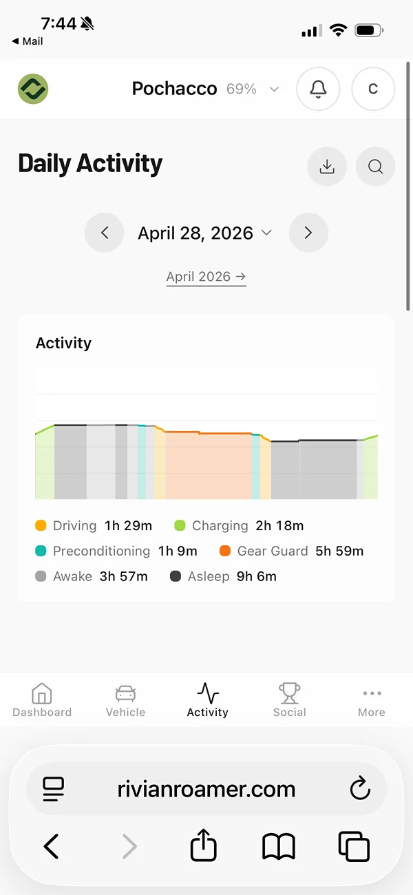

sure does
Rivian R1T R1S Improved phantom / standby battery drain after new update 1777473952664-a2

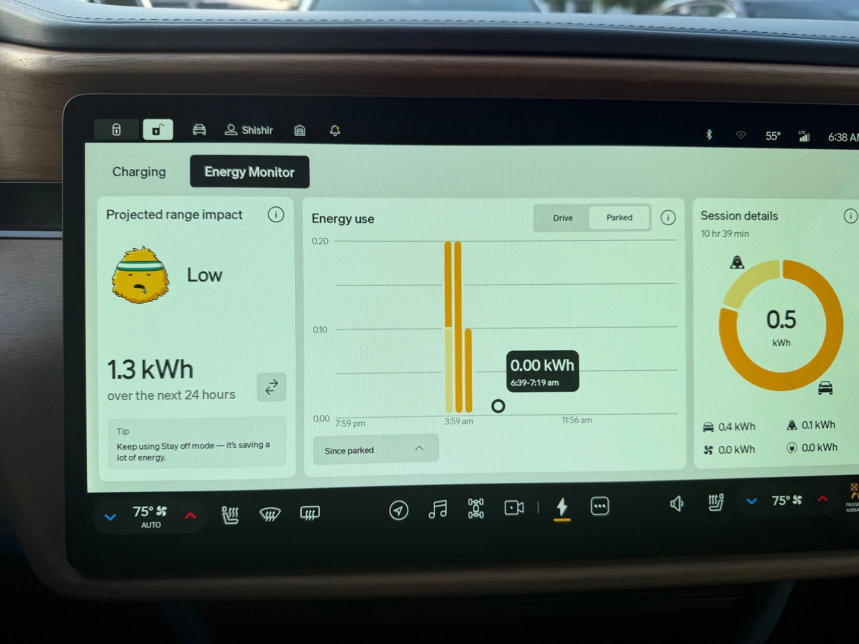

0.5 kWh for 10.5 hours. I think this is the best I’ve ever seen it…
Rivian R1T R1S Improved phantom / standby battery drain after new update IMG_8793
