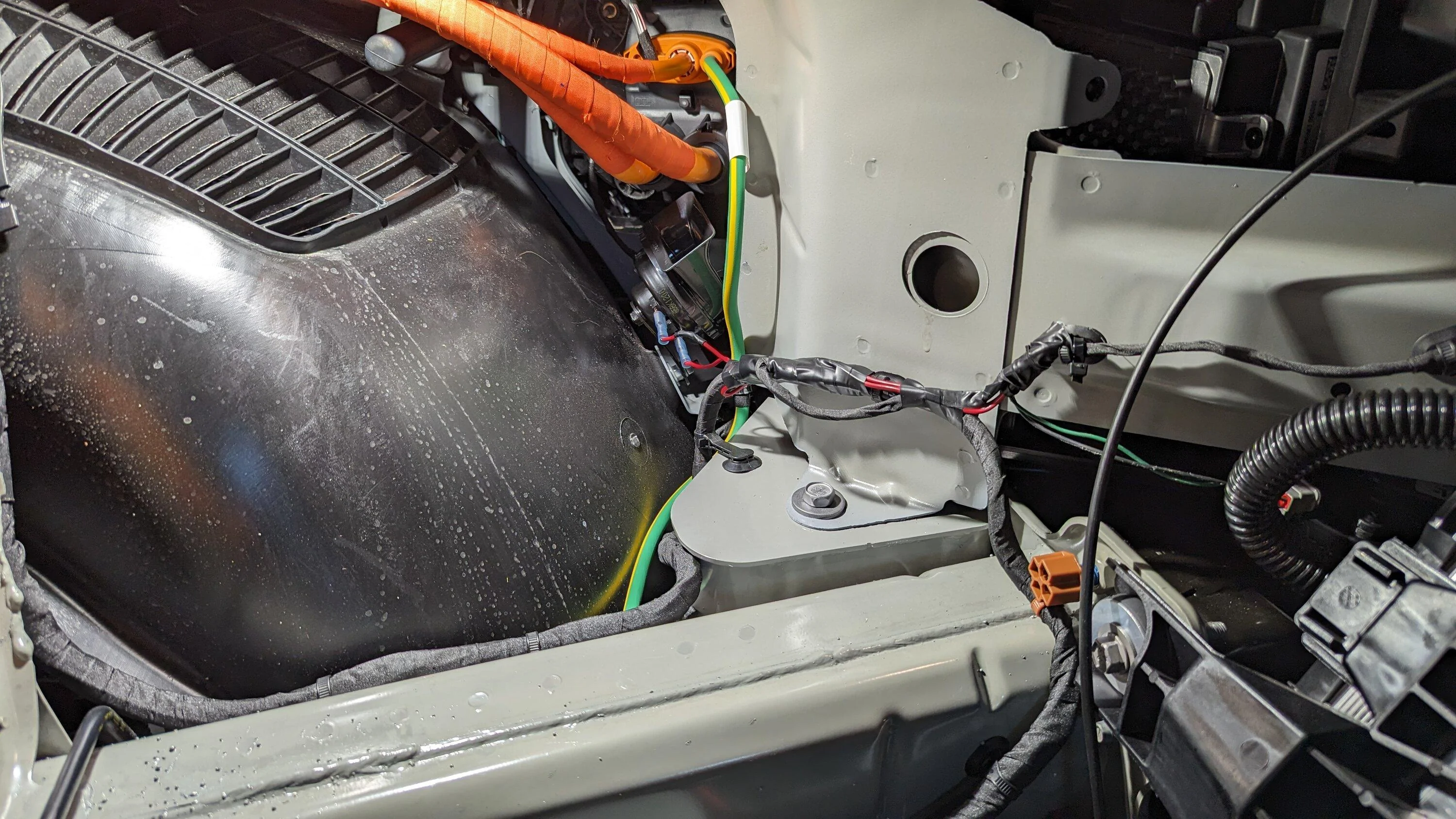

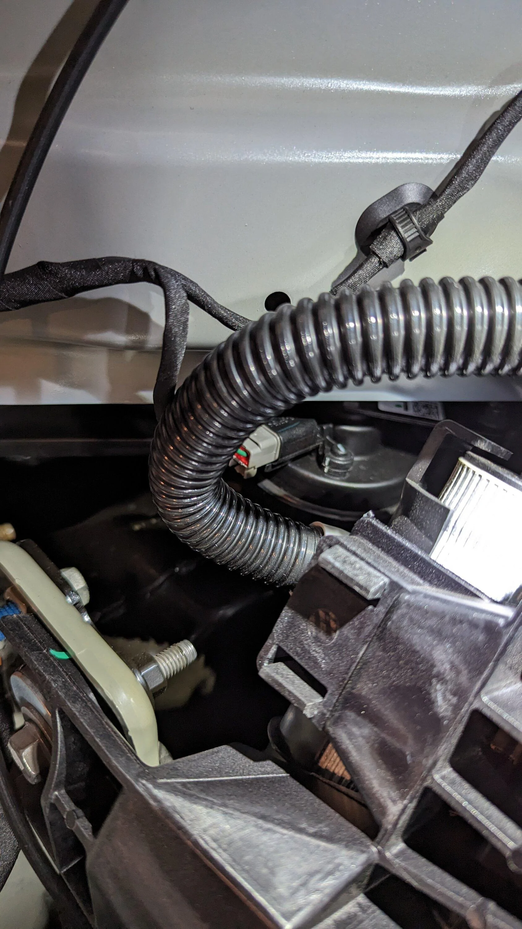

I had a leftover nut that almost worked, but wrong threads.
So I took that into Lowes and used that as my point of reference.
My nut was standard. The bolt is metric.
I believe 6M x 1 was the size. Bought a pack of 6 and 6 washers. Worked like charm!
(I'll see if I still have the package to verify)
I'll look into getting a set of thread checkers, never really occurred to me. Great suggestion!
You’re a hero for this post! They are indeed M6 x 1.
Installed a second horn extremely snuggly on the two studs you identified. Thanks!
Sweet! Great job, glad to be out assistance!
