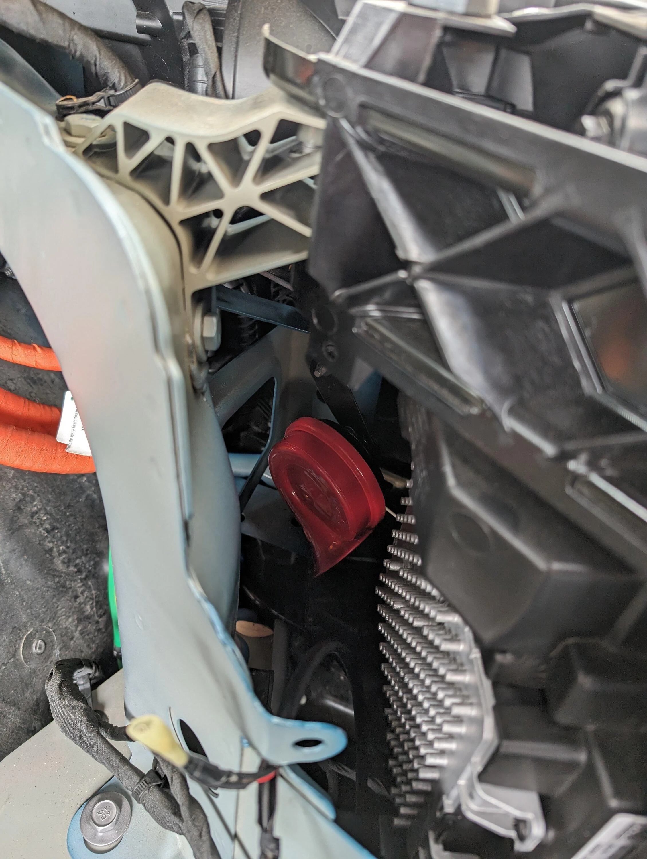

Just the one. Both horns on driver side, plenty of space. Rivian is just using standard 12v horns. Looking at the stock horn it very much resembles the Hella ford horn. No Telsa crazy yet.
Is this a picture of the actual Rivian horn? I'm wondering if we can identify the connector being used. If they're using the same connector as Ford/GM, there are y-splitters that are easy to come by without requiring any splicing.
It's similar, but that isn't a picture of it. The connector location doesn't align with what I saw on the truck and the connector on the Rivian doesn't look like the Ford/GM connector I saw on other videos. So I just spliced in to the harness. I'm sure this is a standardish-connector you could find a counterpart for if you didn't want to touch the harness, but that was more time I didn't want to invest.

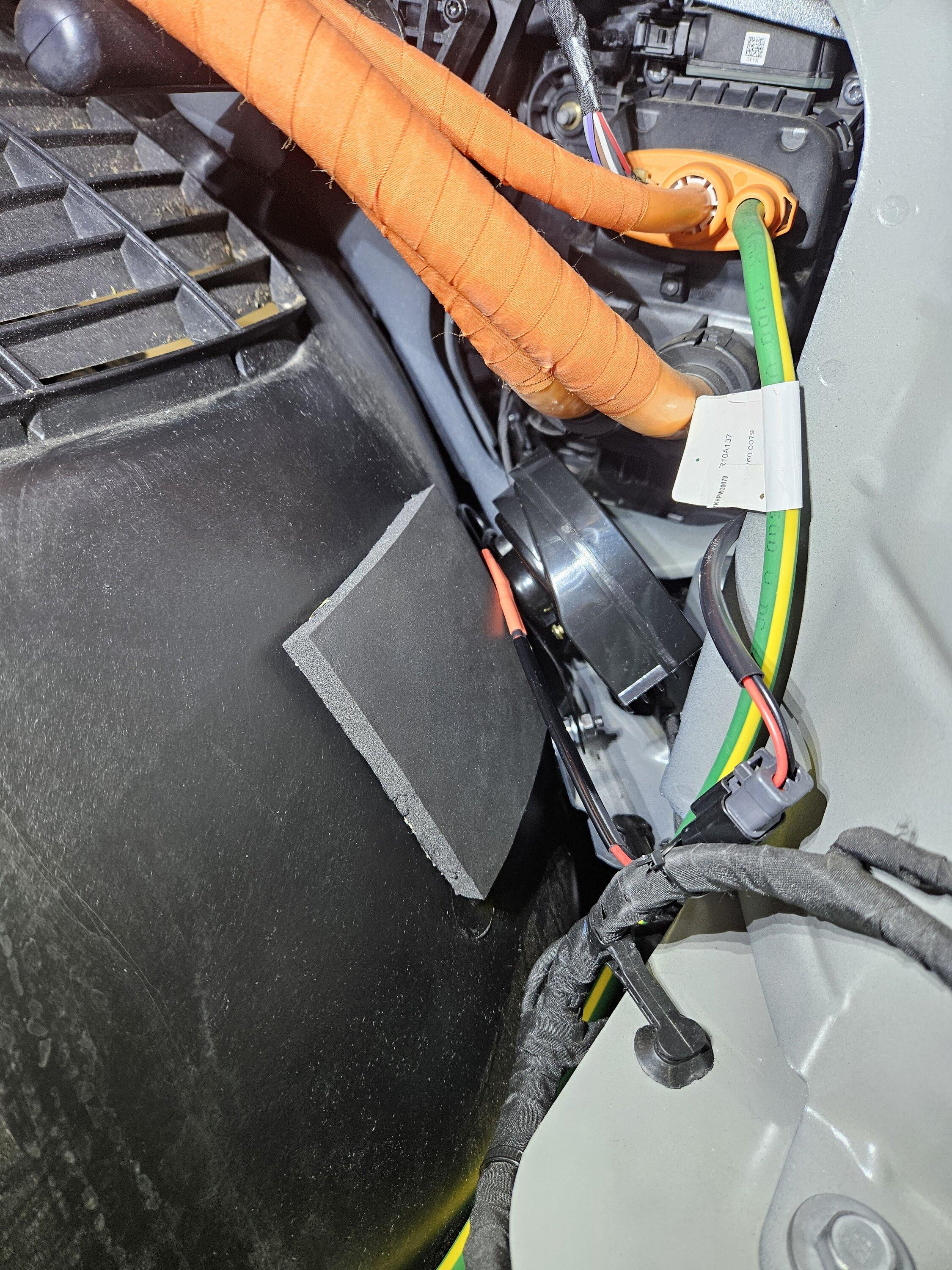

Just added the second horn too, same mounting spot as I could not reach anywhere else that could be a potential mount point.
Bought a slim 510Hz model, it is aimed down which needed longer wiring. Bent the horn mounting plate to match the curve.
https://www.amazon.com/dp/B08HWC34RB
Used a 2-pin splitter instead as I wanted to keep it as identical as the original 2-pin plug.
https://www.amazon.com/dp/B09HQFVG92 (longer length since I didn't know how much I would need to route the cable)
https://www.amazon.com/dp/B0BYJH85XN (only need 1x 2-pin connector for the horn
Stuffed a foam pad there in case the cable or something rubbed on the plastic.

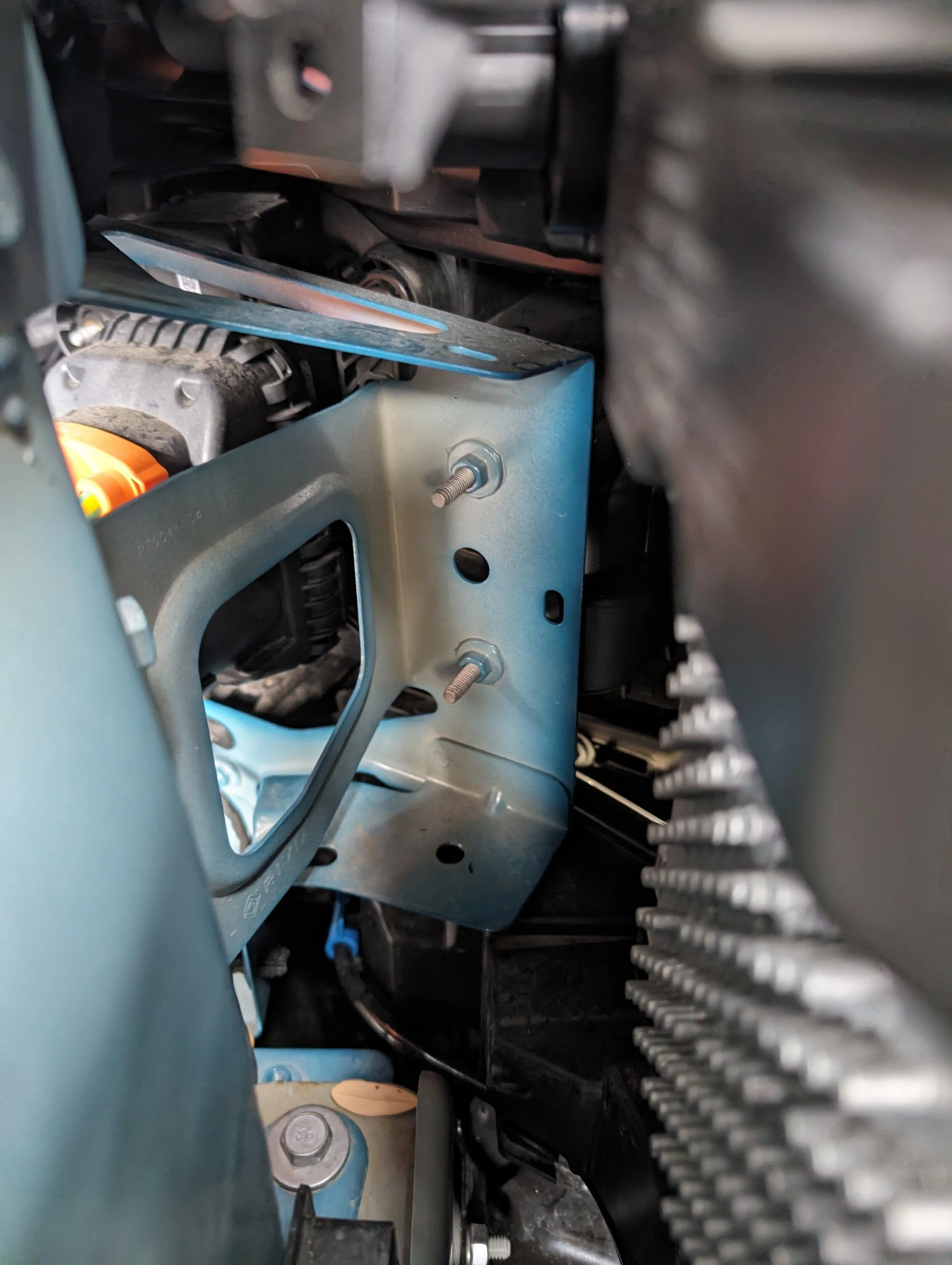

Here's my proposed mounting area for my 2nd horn.
Does anyone know which nut size/thread type for those bolts sticking out?
This sits right behind the driver's headlight. The horn came with 2 brackets so this should be a perfect little spot for it.
Sorry, I do not know. However, a set of thread checkers would be a good investment for this and future projects. Great mounting location.
I had a leftover nut that almost worked, but wrong threads.
So I took that into Lowes and used that as my point of reference.
My nut was standard. The bolt is metric.
I believe 6M x 1 was the size. Bought a pack of 6 and 6 washers. Worked like charm!
(I'll see if I still have the package to verify)
I'll look into getting a set of thread checkers, never really occurred to me. Great suggestion!
@Nuclianba @flush appreciate the write up guys. @flush I assume your method avoids any splicing - correct? How is the slim horn holding up?
No splicing of the original horn wire in the vehicle, just connect all the various wires between the new additional connector + Y splitter to the new horn.
No issues at all, horn works well, people actually hear it now.
