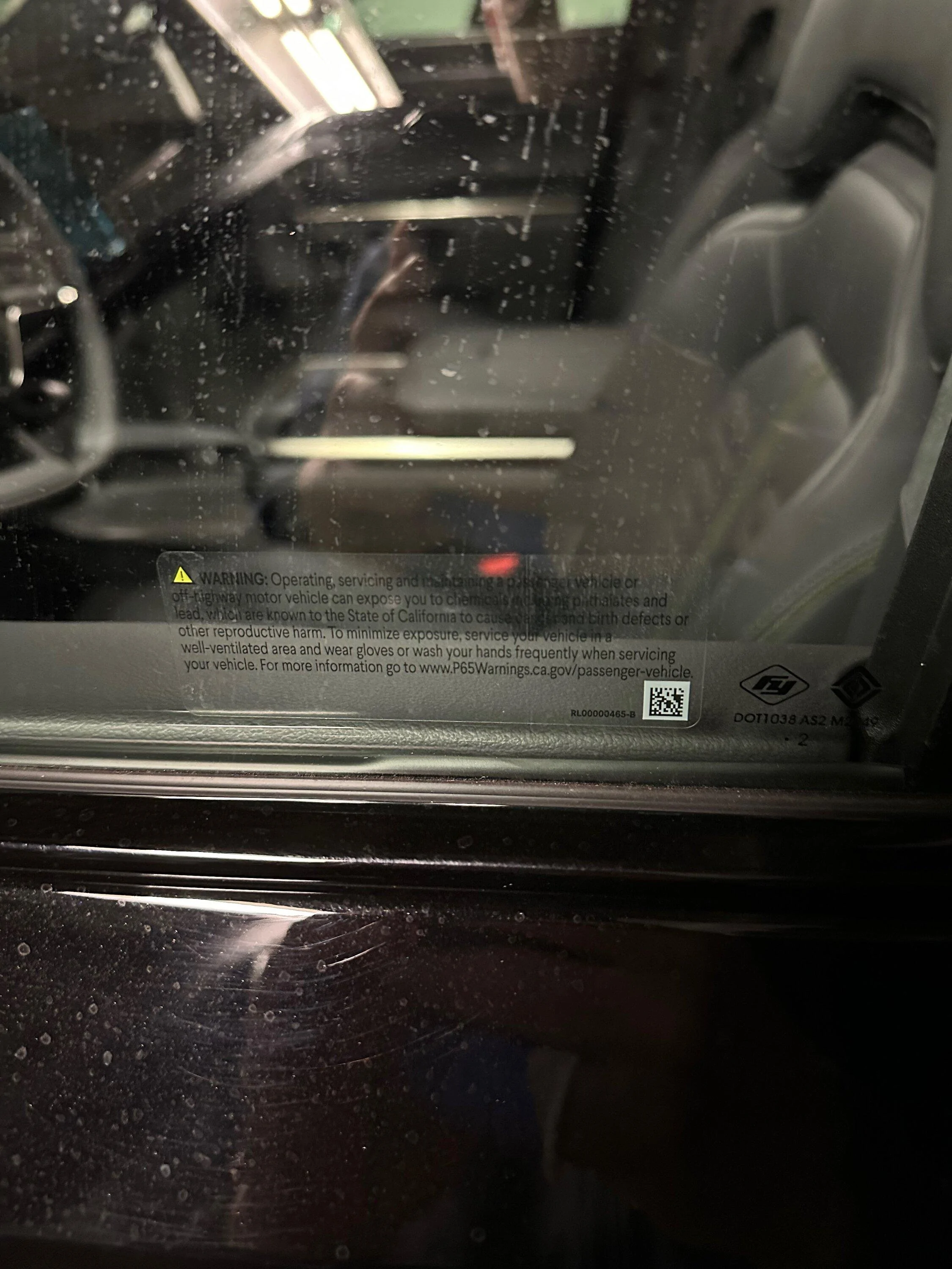

This is probably a dumb question, but does this sticker come off easily or is it meant to be permanent? I want to remove it but don't want to make a mess. Can we blame California for trying to scare us?

Every vehicle gets one. Get a plastic razor blade and scrape it. Remove any remaining adhesive with a microfiber and some adhesive remover (as needed).
Alternatively, use a hair dryer or heat gun on low to warm up the sticker for easier removal.
Last, if you plan on getting windows tinted, the tint shop can remove during their prep process.

Yes easy I used my fingers and then goo gone. I hate stickers myself.

Yup removed it on day one just using my fingernail. No residue left over.

Yes, very easily. Used a heat gun, no residue left behind.
