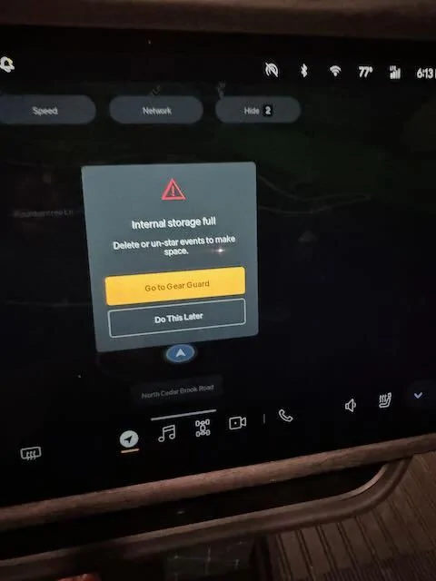

Keep getting "Internal Storage Full" alert whenever I get into my car

I don't have any jump drive plugged into the car. I have nothing flagged in favorites. This pops up everytime I get into the car to go somewhere. I have to sit there and hit the do this later multiple times. I'm about to just create a service ticket but maybe someone else has dealt with this.

It sounds like you need to go to GG and delete events. The only thing that is saved on external storage is the drive cam even when you have a drive plugged in. The incidents and motion can default to the internal storage. It keeps internal storage footage for 10 days (unless it’s started) but if there are a lot of events then it may fill up before they expire.
some locations may be triggering motion cam to record a large number of events. If there aren’t a lot of events stored then an infotainment reset should help.
hold down the far left and far right steering wheel buttons at the same time until it reboots.

I reboot the infotainment system didn't help. I think it was the internal storage was really fully. I saw all these videos that I had no idea were there. You would think it just overwrites the oldest. I think I'm good now. Thanks for the suggestions.

Same error, found a 2 1/2 minute stop motion animation featuring Gary…

I have the same issue as you. Buggy update is my guess.
