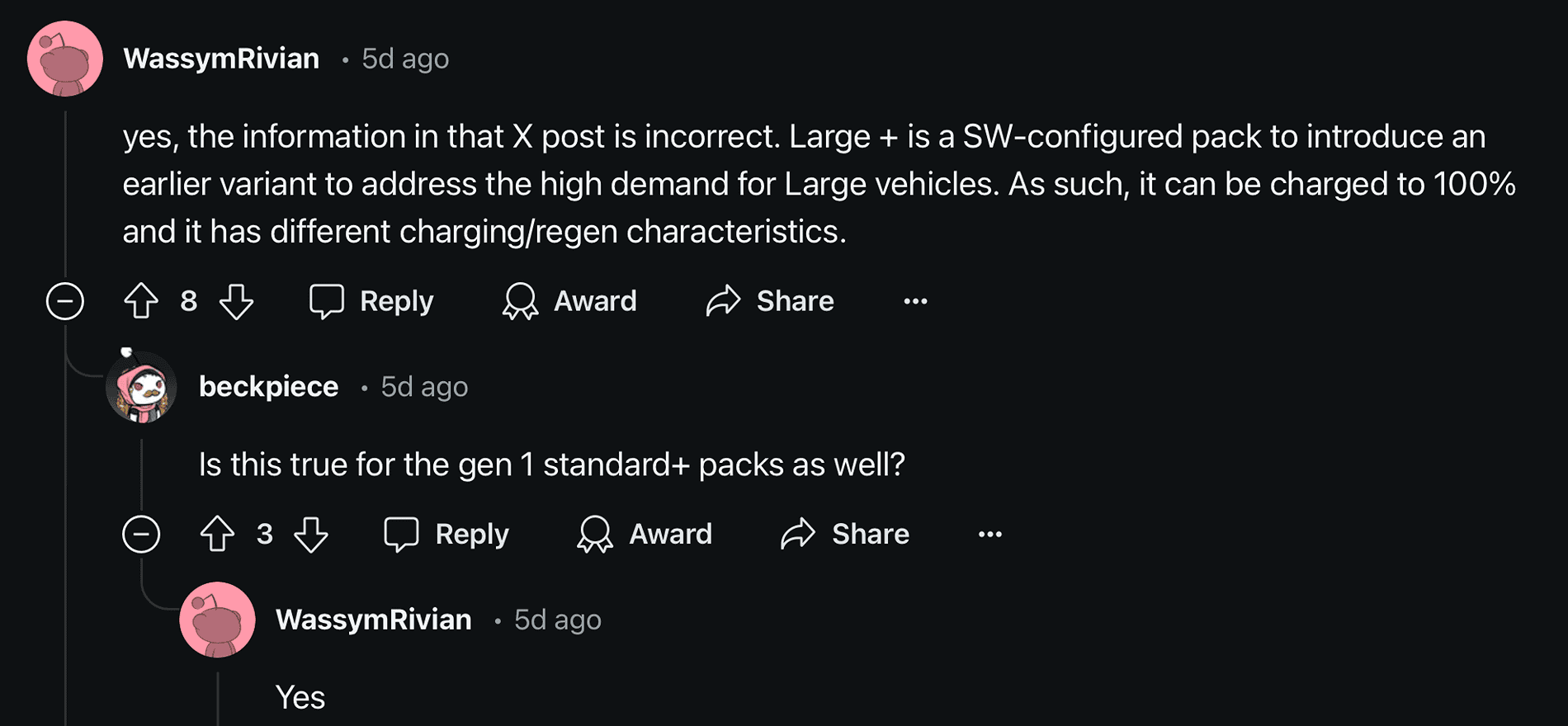

For those curious on Gen 1 Standard+ packs. Same info has been confirmed as well. Source
Rivian R1T R1S Large+ appears on Rivian Roamer site Screenshot 2024-08-19 at 10.26.11 AM
