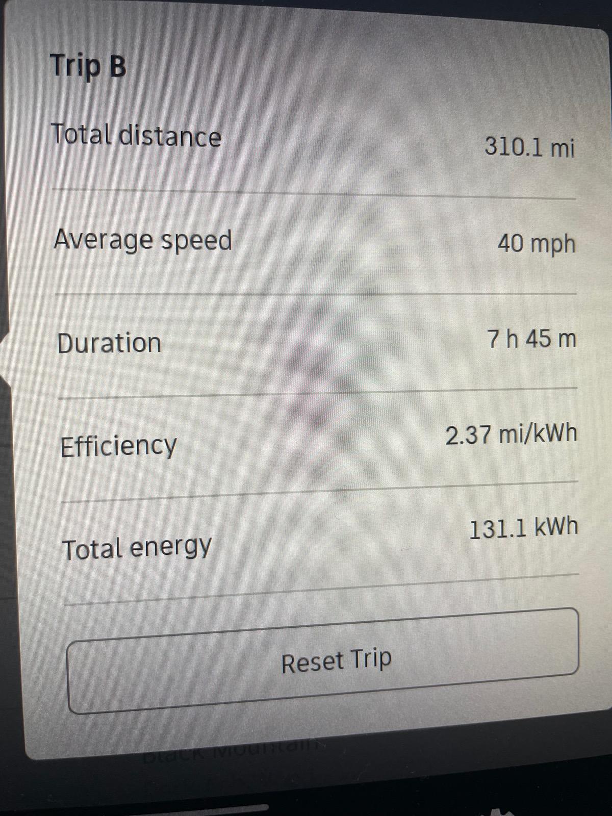

Interesting, thanks for the info. I just recently clocked 310miles on the same configuration & have been wavering on how much I need the extra 7% or 10/11kwh.
Image was mostly freeway ave. speed was skewed by long border wait.

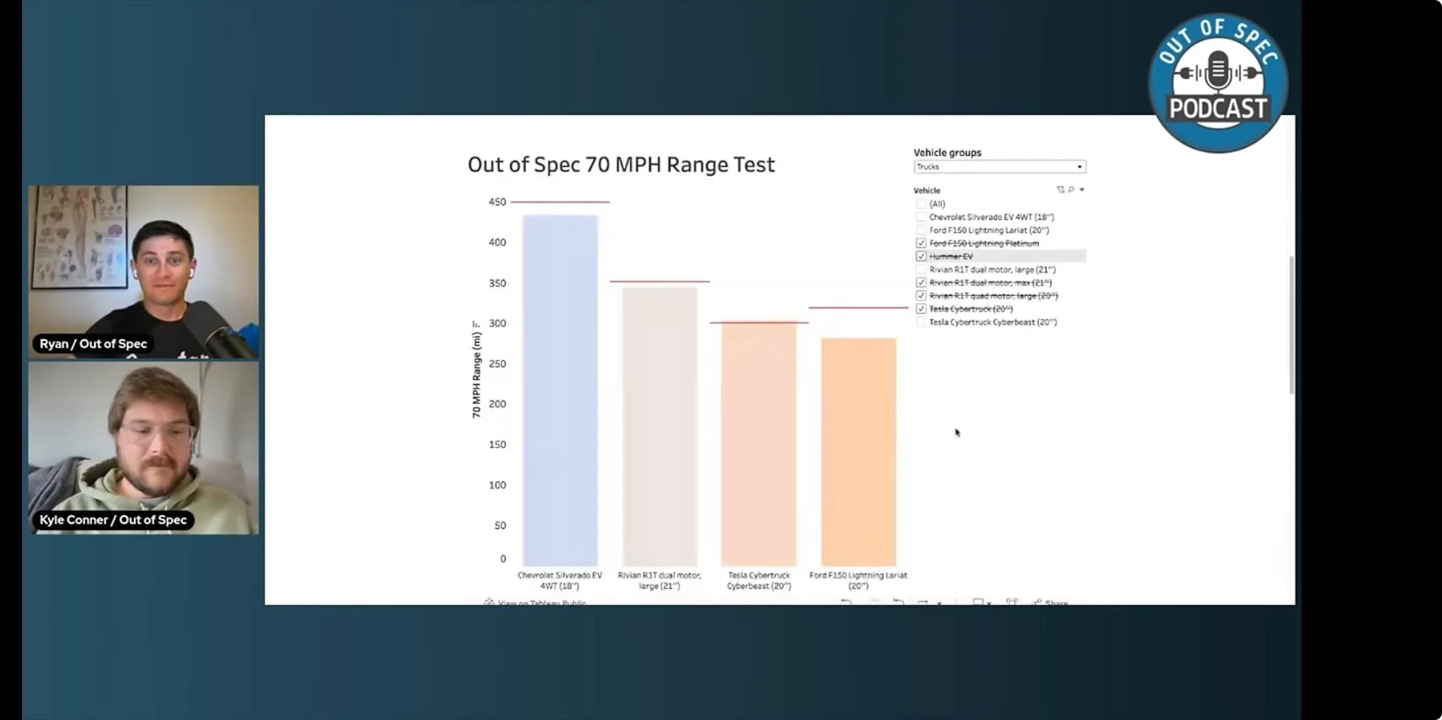

This is the video I am referring to. He surprisingly showed the results upfront in this 2+ hour video. See attached screenshot for the part that caught my attention, where he referenced results from other Rivians
And we can play with the data from his results on his website. https://outofspecstudios.com/70-mph-range
Yeah, so you're ignoring the direct comparison results there. When he did the range test of the max pack, he also did one of a dual motor large pack on the same wheels. The max pack has the same highway efficiency, but went slightly further. On the day referenced above the dual motor large went something like 15 or 20 miles further than in the first test.
the graphs etc are pretty but he hasn’t made any attempt to normalize them to standard conditions so they are essentially useless for direct comparisons (unless the two vehicles were tested the same day in same conditions).
