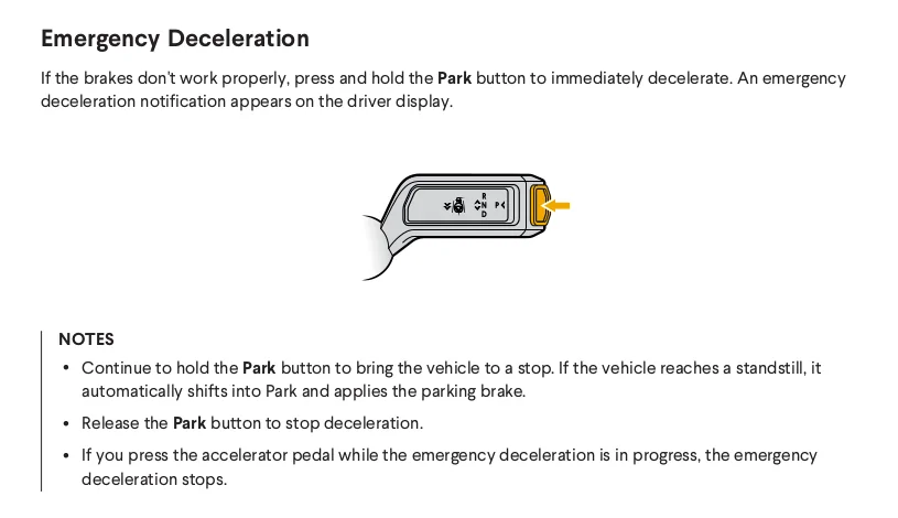

I was cruising down 35 here in Austin today when I ham-fisted an attempt to turn on Driver+ and depressed the park button on the stalk for a second. The car lurched like it was under braking and made a grinding sound from the front wheels, and showed an error message that read something like "come to a complete stop to go into park." Thanks Captain Obvious, you've been promoted to Admiral.
I was certainly taken aback. I'll be more careful in the future, but more than anything I figured a software lockout would prevent the car from even attempting to enter park while at 70mph. I haven't had the guts to try it a second time to see if that's what really happened. A forum search didn't turn this up... anyone else want to admit to being this clumsy?

I've accidentally hit that button multiple times while driving trying to set cruise control. That's how I set it on my previous truck and my brain works more on muscle memory these days.
It always just tells me I need to slow down before trying to Park. It has never applied the brakes.

There is a legal requirement about the maximum deceleration that shall not be exceeded with park brake while the vehicle is moving (maybe about 0.3G?) due to the instability it would cause to lock up the rear axle.
(One of my job back in the old days was to implement this feature for electric parking brake vehicles. That time they were much more rare and manual handbrakes were the normal
Those were the days where the control of the electric brakes were not figured completely out yet and Jaguar had a recall because their park brake randomly engaged on freeways even you were driving over 140kmph speed. Was very dangerous --> hence the legal requirement was born later to limit the force an EPB can apply
https://static.nhtsa.gov/odi/rcl/2004/RCDNN-04V488-9617.pdf )

Literally one of the first...3 things... my Delivery Guy told me was that is how to activate the emergency brake while driving.
I'm flabbergasted that this isn't on a standard Rivian Delivery checklist!
