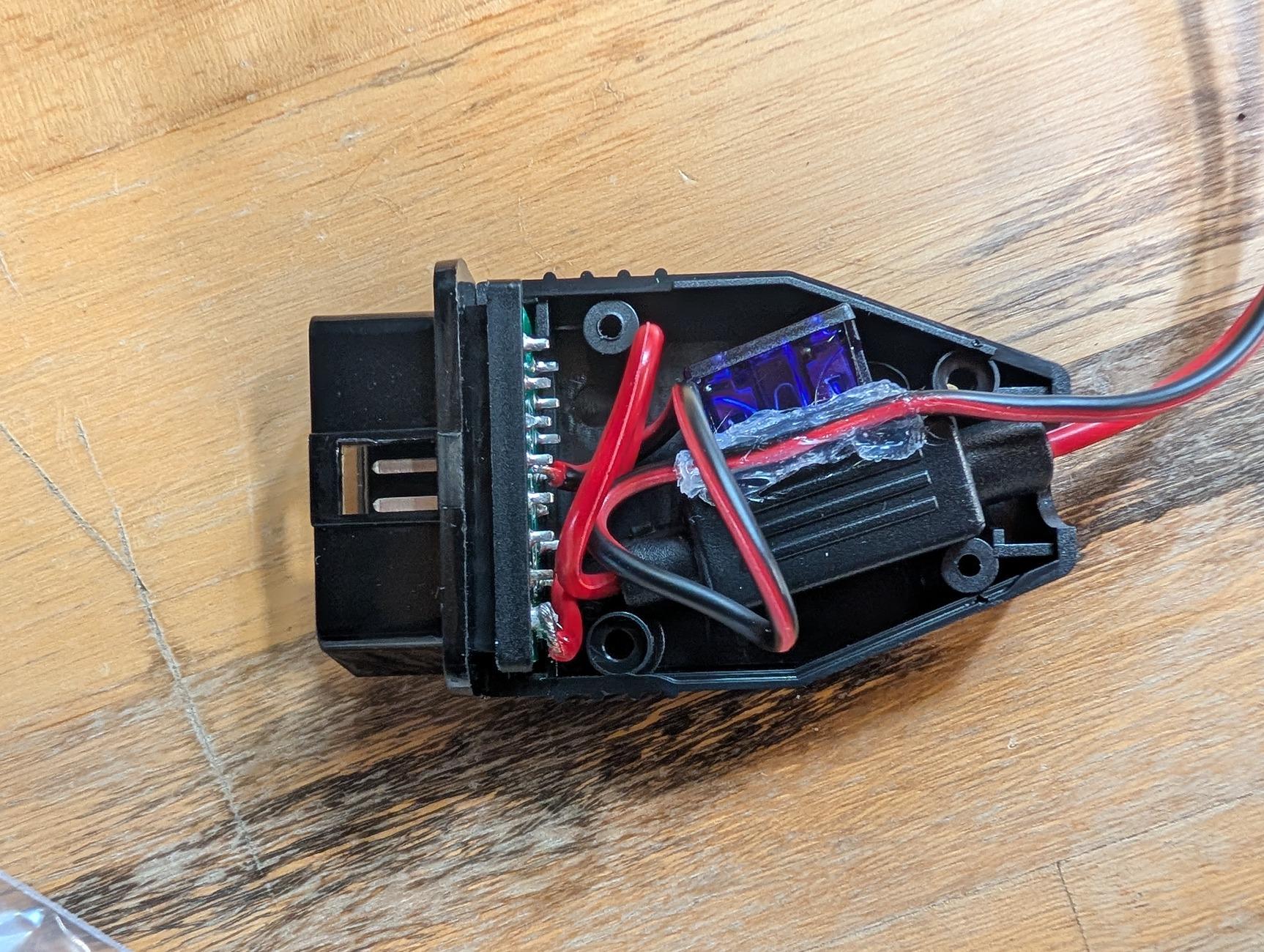

The SAE to ODB2 is not available on Amazon but a cheaper option is to solder the provided cable to an ODB2 plug.
GND: pin 4
+12: pin 16
YACSEJAO 2PCS Car OBD2 16 Pin Connector OBDII 16 Pin Male Wiring Plug Adapter DIY OBDII PCB Diagnostic Tool with Screw & Shell for Car Truck OBD2 Connector https://a.co/d/hD7TyyH
Total cost $30.

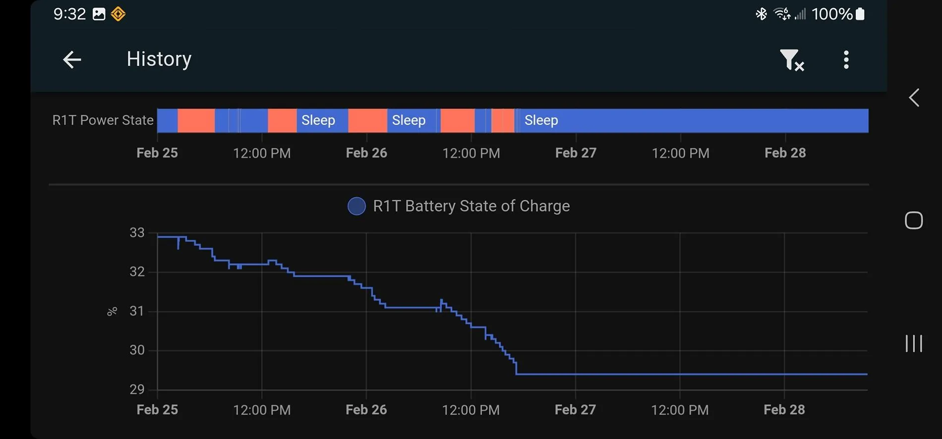

Posting a snapshot of what the trickle charger solves. Notice the sleep wake cycle just becomes a long sleep cycle once the 12v is fully charged, otherwise it's sleep a few hours, wake up and charge for a few hours and repeat endlessly until driven or charged.

Notice the sleep wake cycle just becomes a long sleep cycle once the 12v is fully charged....
Same for humans when our time runs out- the sleep/wake cycle becomes a looooong sleep cycle ;)
