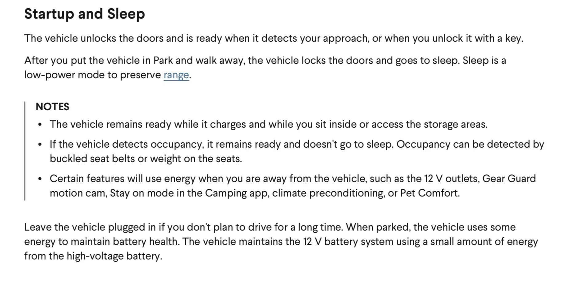

I am going to caveat this with saying that I know you’re frustrated and with good reason, and I agree that a notification should exist. Just be prepared for the manual to be cited, despite most people never reading it, myself included.
Rivian R1T R1S PSA: Don't leave seatbelts connected IMG_1281

I am curious if this was a front belt? Those are the only ones I’ve known to keep the vehicle awake indefinitely.
It can be in the manual and also be a design flaw. Yet again, zero logical reason why a seatbelt buckled should keep the truck running for days at a time and to the point that it literally cripples the truck. There HAS to be a safety mechanism. For instance, on Tesla's many of the "maintain" features like cabin overheat protection shut off after it reaches a low battery state. They need to implement that here. It should turn off and go to full sleep at 10-15% or something like that. Then you would need to manually override that.
