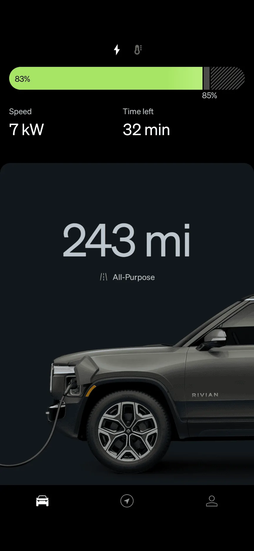

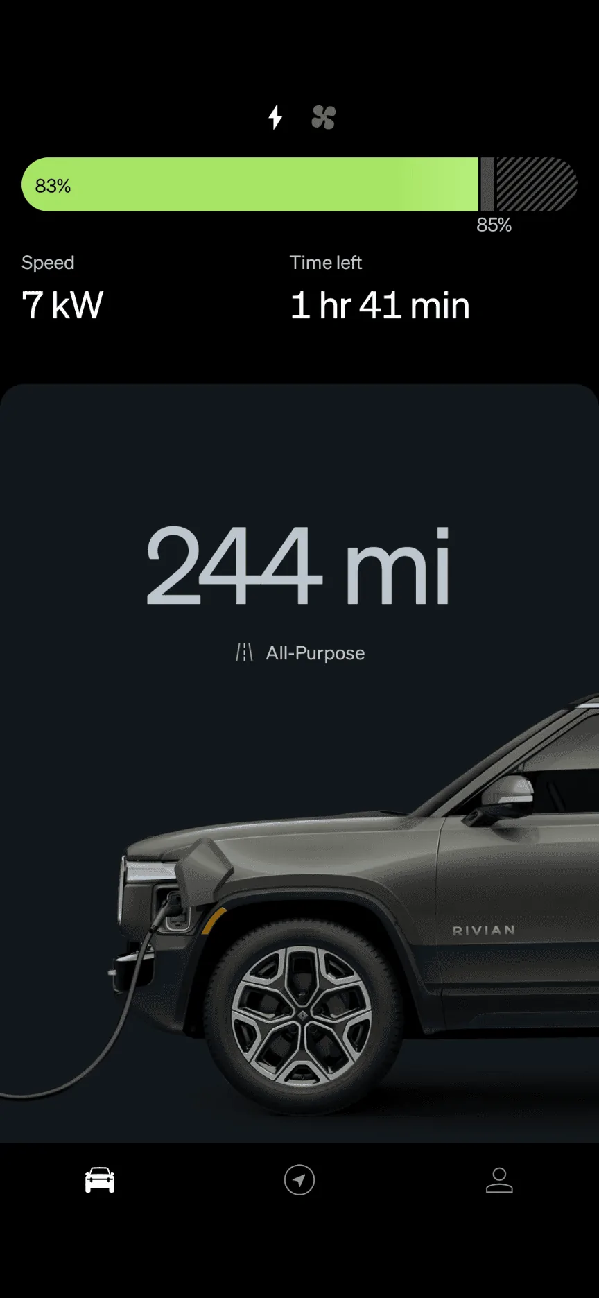

R1S A/C at full blast uses about 5 kW
Rgrin
Oct 12, 2021
117
157
Bolt
Plugged into 7 kW charger, about 30 min to go. Remotely turn on A/C to pre-cool, as cabin at 120 degF. Give it a couple minutes to get up to full blast. Charge time remaining goes to 1h43. So roughly 5kW of the 7 kW being used for A/C.

Hmmmm. I’d like to cross check this with the energy menu. You have to get in the truck to see it but it shows you the real time breakdown of power allocated to battery vs. other things (visual bar plot of sorts).
the air conditioned volume of the R1S must be about twice of the R1T so it should take more power to heat/cool. However, 5kW is like a home AC almost so I’m surprised at that value.
Rgrin
Oct 12, 2021
117
157
Bolt
I was surprised too. The A/C was clearly designed for the R1T, as it the cooling power is too low for the R1S (as reported elsewhere in the forum, and I have experience myself). Now this is during the initial cooling phase, where it sounds like it is going to explode, so it is going flat out. Still, 5 kW was surprising. My measurement is indirect, so it is just a rough estimate. Will be interesting to see what the actual breakdown is.
