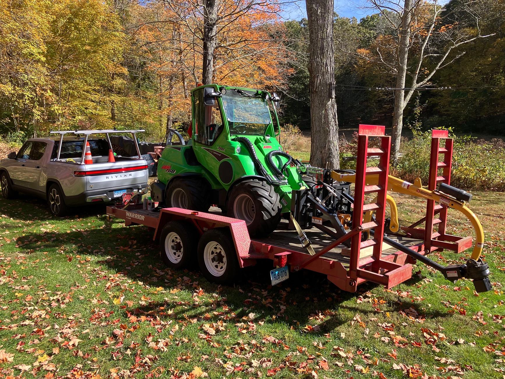

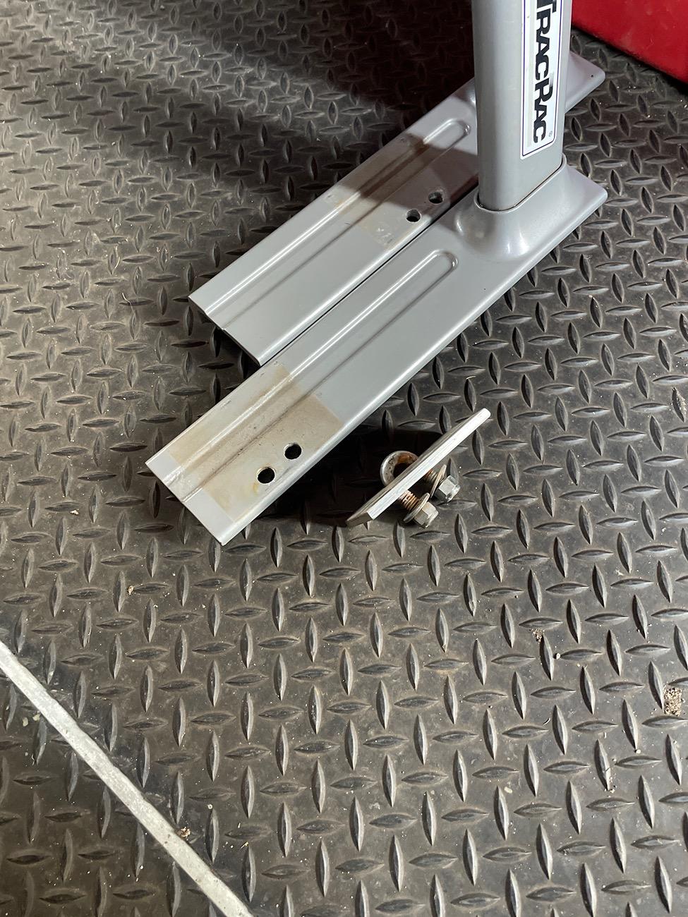

All of these aftermarket racks for the R1T are “bend over and pass the Vaseline expensive”. It does seem like there is no shortage of owners willing to bend over. Almost 2 years ago I was in the same situation trying to find a rack system that would attach easily and be secure, and work in concert with the cab mounted cargo bars. It was surprising to me that the Rivian engineers had not already designed a solution to this problem. They were probably all focused on the cool tambour access to the gear tunnel from the back seat. (What did that cost?). My solution was to slightly modify my aluminum rack system from my previous F-150 Supercrew that I sold just prior to the R1T purchase. I drilled two holes at each base of the rack, aligned to the cargo bar mounting locations on the bed rails. I then used a 5/8” cable clamp u bolt, some 1/4” thick aluminum fish plates, s/s washers, and s/s nylon insert lock nuts to secure the rack to the cargo bar mounting locations. No vaseline needed. The rack was rock solid. I used it for everything from ladders, kayaks, to 16’ long pt 2 x 8 lumber. No issues ever. The design was simple enough, very cost effective, as I either had all the hardware on hand and fabricated the fish plates from flat stock also on hand. I only removed the rack system yesterday after two years on the truck . No evidence it was ever installed. The TracRac system will go on to my next truck. Good luck with your search, and don’t forget the Vaseline!

I was also intrigued by Wojo's more DIY approach to modifying a non-Rivian-specific rack to work with the Rivian mounting system. This led me to an interesting option I've found on Amazon, which looks like it would need only a very similar adaptation to what Wojo did with his TracRac system - drill two holes in the bottom of each column part, add fish plates, and use U-bolts to attach to the built-in attachment point.

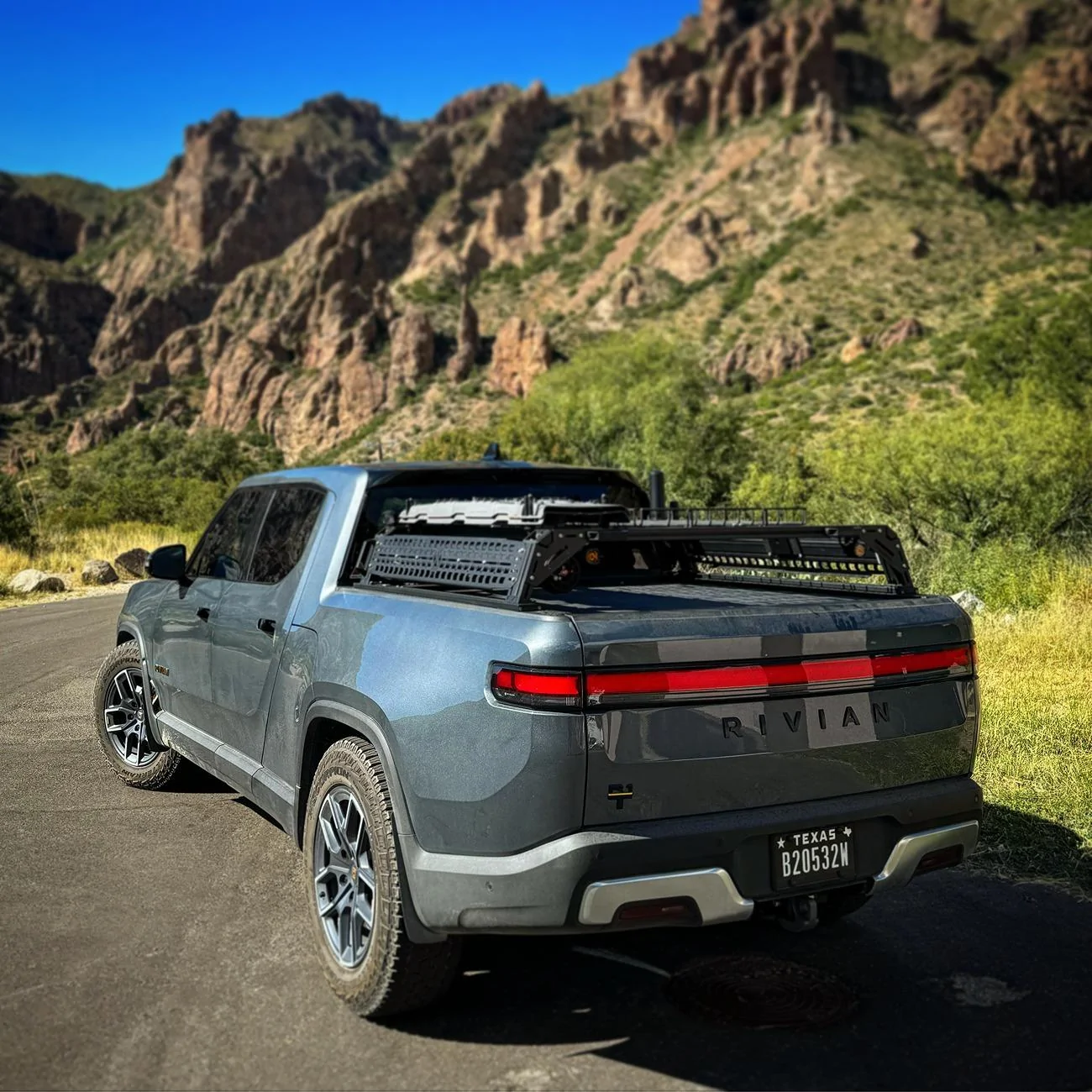

My Xtrusion Overland rack has served me well. Super modular and rock solid.
Looks amazing. Is this the 10 or 14 version? would you happen to have a picture of it mounted with a rooftop tent?
This is a 9" setup, before they standardized their sizes to 10"/14". I've never mounted a RTT on it, but you can find some images out there of people who have.
