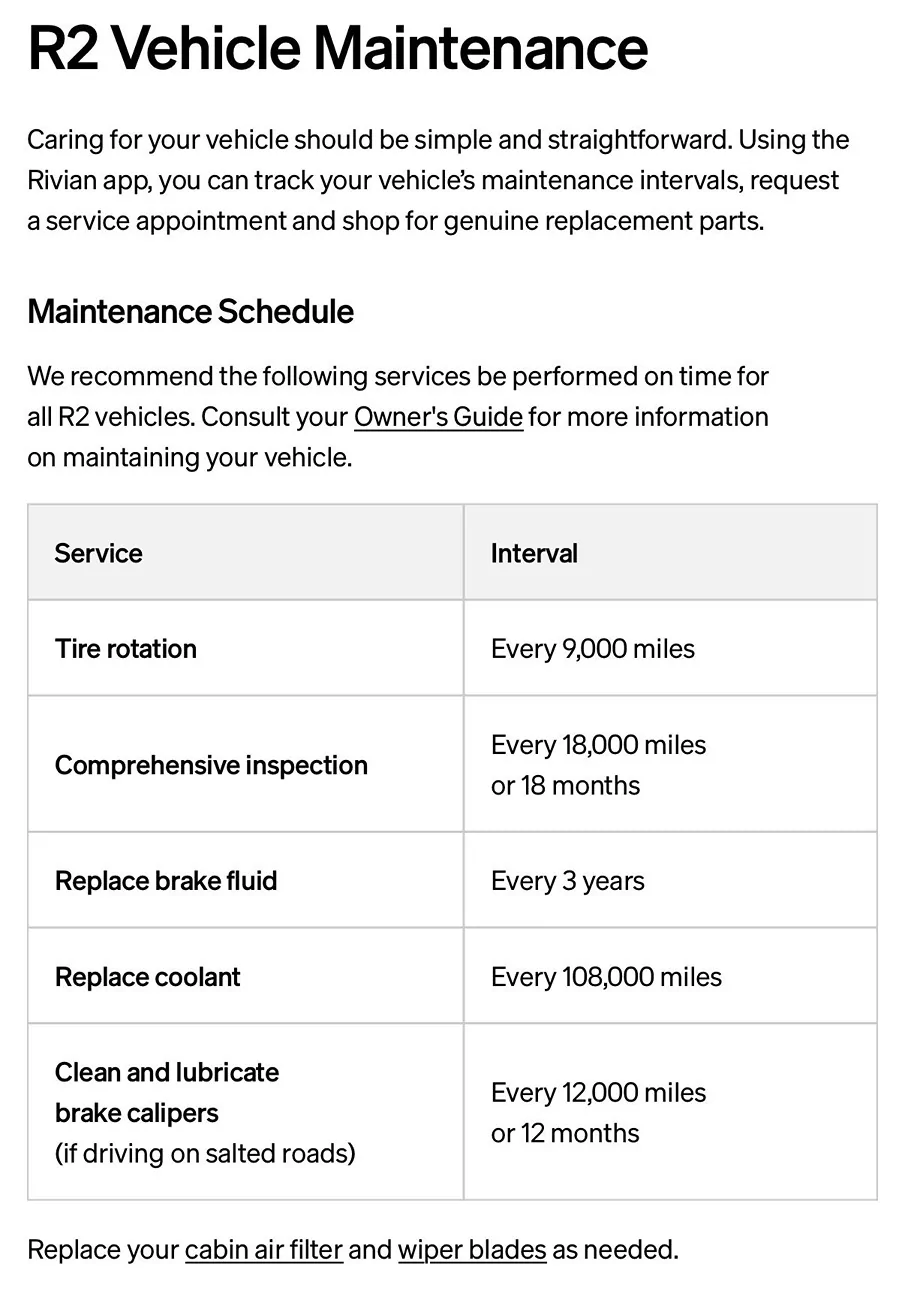

R2 Vehicle Maintenance
Caring for your vehicle should be simple and straightforward. Using the Rivian app, you can track your vehicle's maintenance intervals, request a service appointment and shop for genuine replacement parts.
Maintenance Schedule
We recommend the following services be performed on time for all R2 vehicles. Consult your Owner's Guide for more information on maintaining your vehicle.
Replace your cabin air filter and wiper blades as needed.
| Service | Interval |
| Tire rotation | Every 9,000 miles |
| Comprehensive inspection | Every 18,000 miles or 18 months |
| replace brake fluic | Every 3 years |
| Replace coolant | Every 108,000 miles |
| Clean and lubricate brake calipers (if driving on salted roads) | Every 12,000 miles or 12 months |
