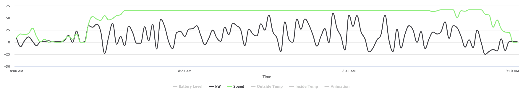

- How much re-charging actually happens?
That depends on how you use regen and on where you drive. If you drive on level terrain at constant speed it won't be used much at all. If you are in stop and go traffic and/or in hilly country it will be used a great deal. Every time you slow down for a traffic light it recaptures the kinetic energy that you put into the car when you came up to speed (less that taken by drag, rolling resistance). Every time you go down a hill it recaptures the potential energy you put into the car.
Rivian R1T R1S Regen Braking for Beginners.... I have questions Regenus
Here's an example from a recent drive. As you can see autopilot was on and so all the regen (when the power line is below 0) came from going down hills. I have taken trips where the battery charge is greater at the end than at the beginning.

In Tesla the only time there is blending of regen and brake is when the car comes to a stop and hill hold is on and, of course, when autopilot is driving and finds regen alone insufficient at slowing the car.
To verify your observation look at the power meter as you apply brake. Does stepping on the wide pedal increase the power going to the battery?
The question here is as to how Rivian has implemented regen control. We know there will be more options than in the Tesla portfolio but that's about it at this point. They are supposed to be posting the owner's manual soon and we will see then.
To clarify word choice here. When you're talking about "blending" regen, you're specifically talking about increasing regen with the break pedal and then eventually adding in a mechanical break. You're you're not intentionally implying that the tesla doesn't do any region when you also apply the break pedal? Right? I thought the moment you fully lifted off the accelerator it did full regen, and then any break is in addition to the regen. To flip your question on it's head, does stepping on the wide pedal decrease the power going to the battery?
