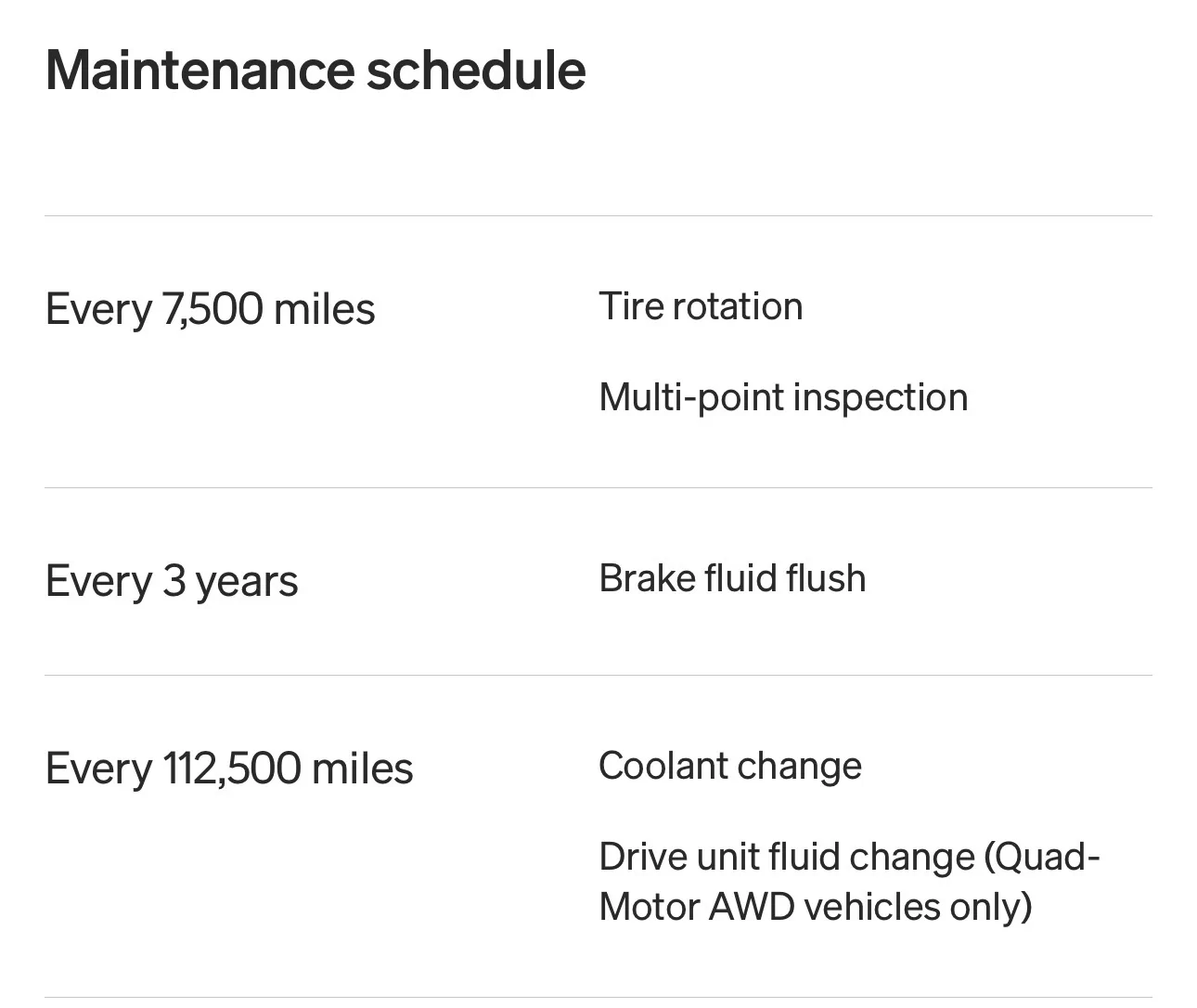

Every 3 years, Rivian recommends a brake fluid flush. And for Gen 1 quads, every 112k miles, to change the drive unit fluid.
