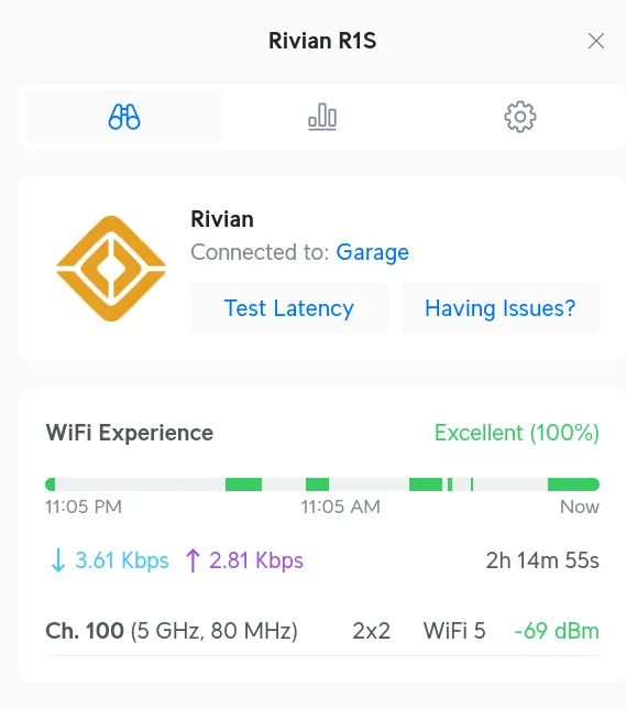

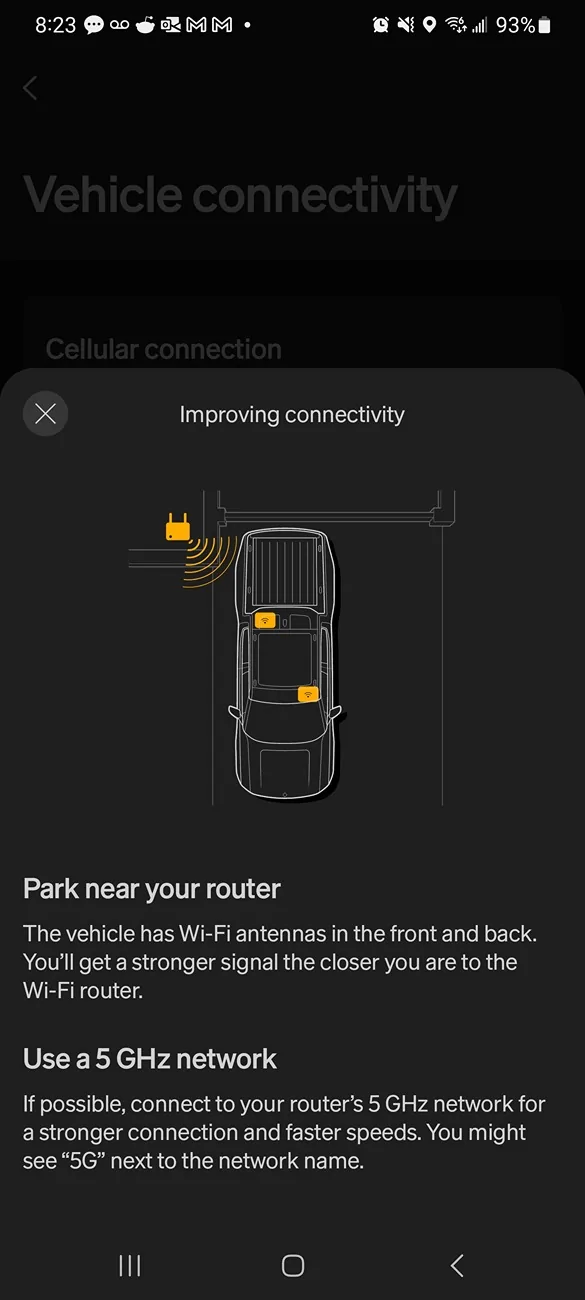

Gen 1 should be able to see 5 GHz as well, personally haven't tried. Gen 1 had 2 Wi-Fi antennas, front and rear, where Gen 2 only has the rear.
This is from my 2023 Gen 1
Rivian R1T R1S [SOLVED] 2025 R1S (Gen2) does not see WiFi 5GHz mesh node Screenshot_20250915_082304_Rivian
