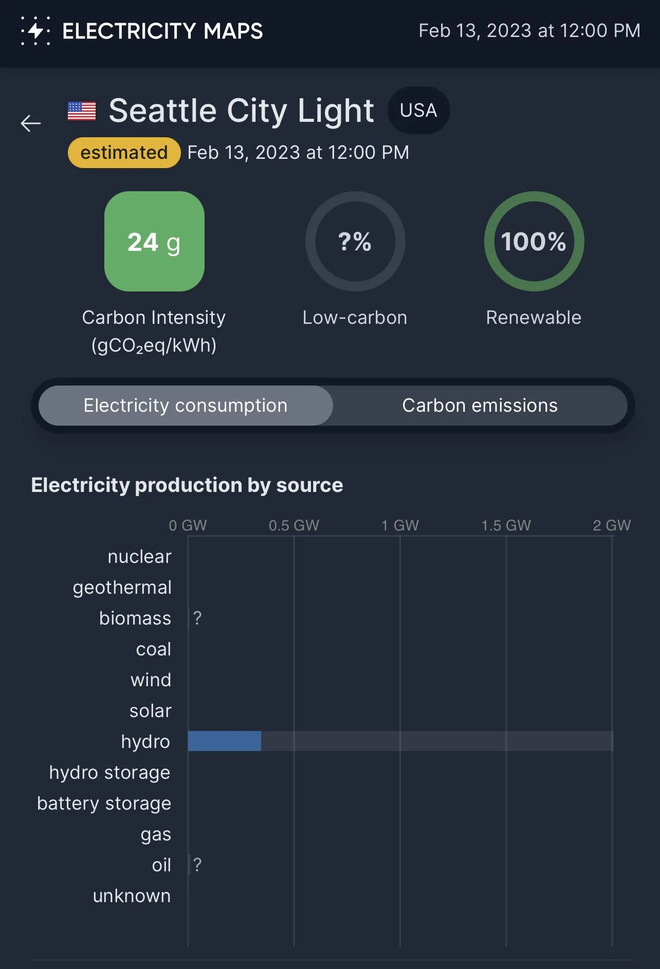

Here is a really cool map if you want to see real time data on different power grids and their electricity mix.
The number I used for Wyoming was 886g / kWh for a reference.
https://app.electricitymaps.com/map

Been playing with turning on and off my OpenEVSE based on CO2signal / electricity maps data via HomeAssistant. It's been very very interesting. I've found a couple of inaccuracies in their data, but generally it's pretty reasonable and very eye opening.
I'm in the WAPA Rocky Mountain region Balancing Authority. And yeah we have way way way too much coal in our grid still. Nasty.
Phantom drain is nasty too. Need to get rid of both lol

I use the Electricity Maps combined with our 10.6kW solar array to maximize low carbon charging at home. This time of year is tough with less sun and a slightly dirtier grid.

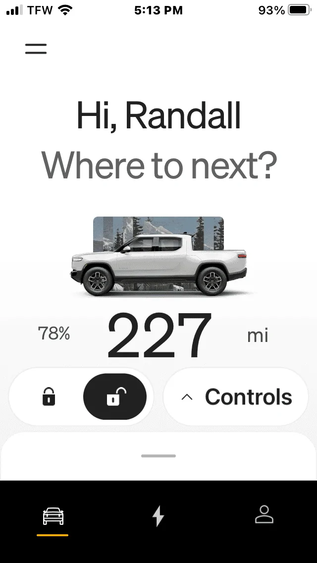

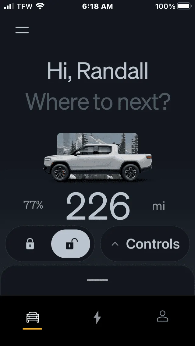

There must be a lot of difference from one truck to the next. I’ll keep checking mine, but I didn’t turn anything off including the app and left the truck unlocked. I only lost 1 mile overnight.
Rivian R1T R1S Some Quick Math on Electrical Grid CO2 Emissions and Vampire Drain D06DD3BE-89BC-40BB-BEC8-4A1E3836C96A
Rivian R1T R1S Some Quick Math on Electrical Grid CO2 Emissions and Vampire Drain 49D10720-ACE6-47FC-87BF-64E735967774
