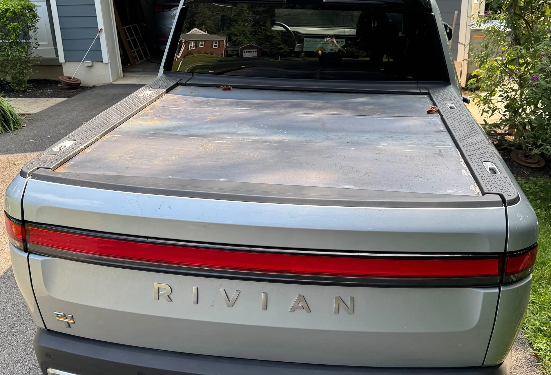

Rivian R1T R1S Steel Tonneau Cover tonneau-full
It's three sections of 18" x 52" 16-gauge steel with 1" x 1" x 1/8" angle bar for bracing and 2" x 1/2" bars for the rails.

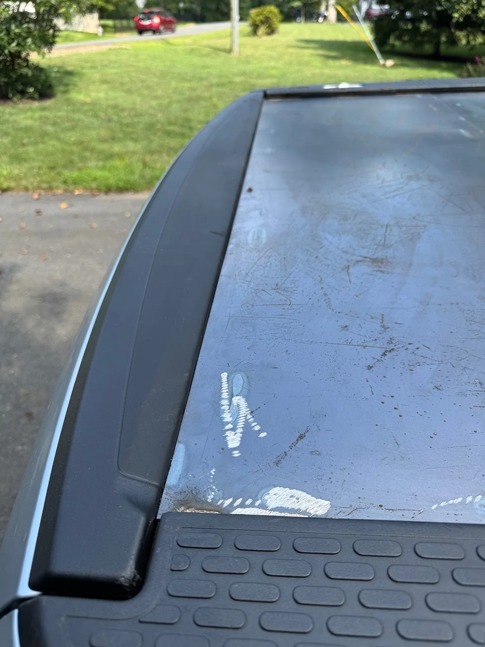

Rivian R1T R1S Steel Tonneau Cover tonneau-fit
It's a tight fit.

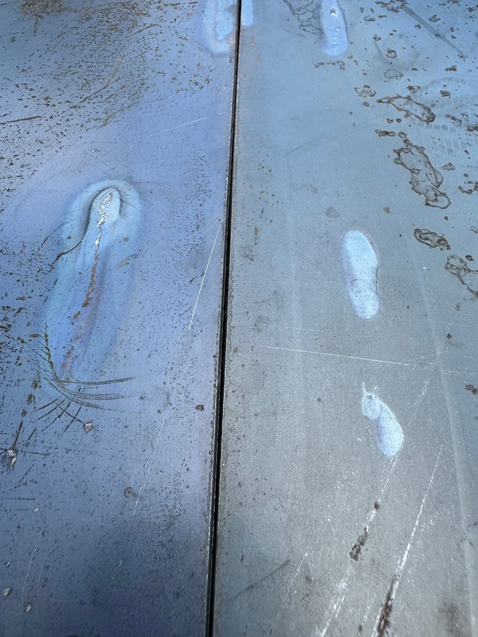

Rivian R1T R1S Steel Tonneau Cover tonneau-ga
The panels fit well together, but are not yet waterproof.
Eventually, I'll paint them and put some gasket material between the panels, but for now, they will do.

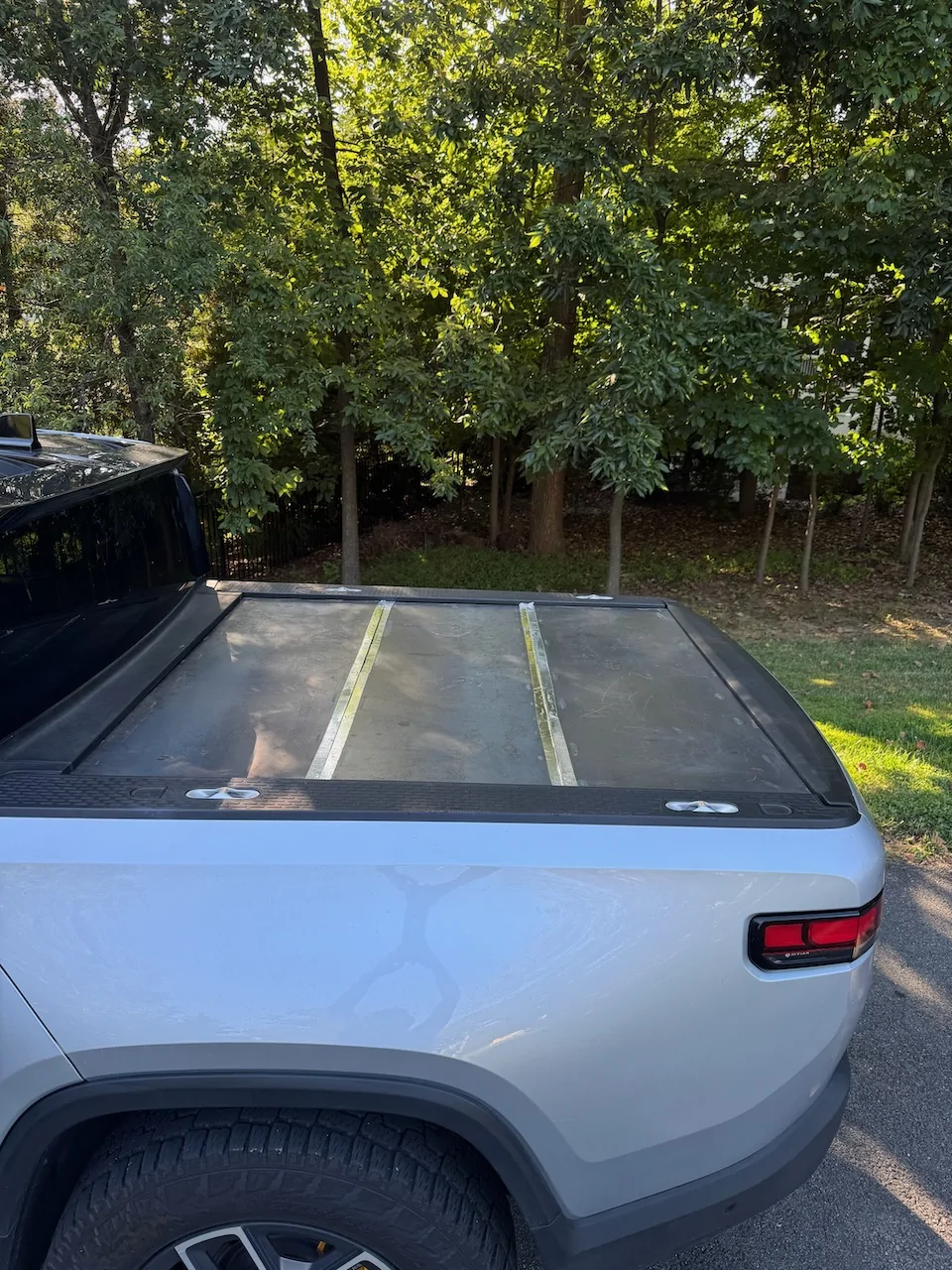

I received an email from the admin stating that they had fixed the issue, and I was able to upload the pictures. (see above)
The road trip went well, and I sealed gaps with aluminum tape. At one point, we drove through a rainstorm that was almost a complete whiteout, but no water got into the bed.
Rivian R1T R1S Steel Tonneau Cover tonneau-sealed
