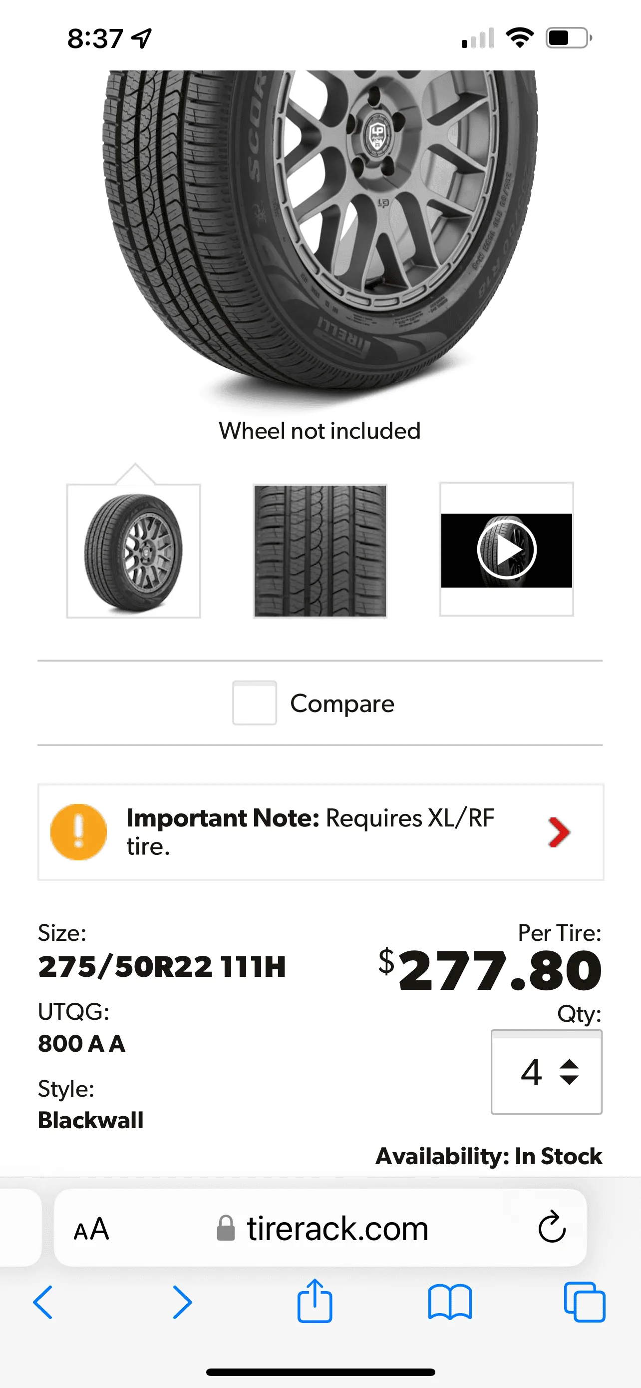

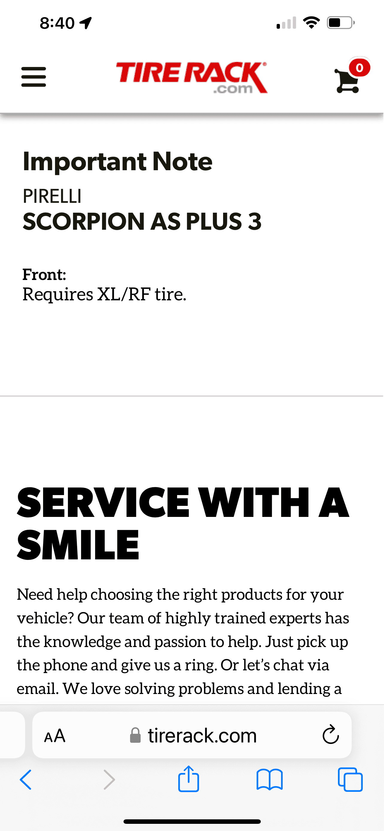

I don’t think I noticed this before, but it seems like the 22” OEM tires are the least expensive to replace.
OEM tires from Tirerack.
20”: $394
21”: $415
22”: $436
There are many cheaper 22” tires but they don’t seem to have an XL load rating.

I think I mixed up the as + and the zero for the 22”. Gotta stop posting late at night on vacation several time zones away
