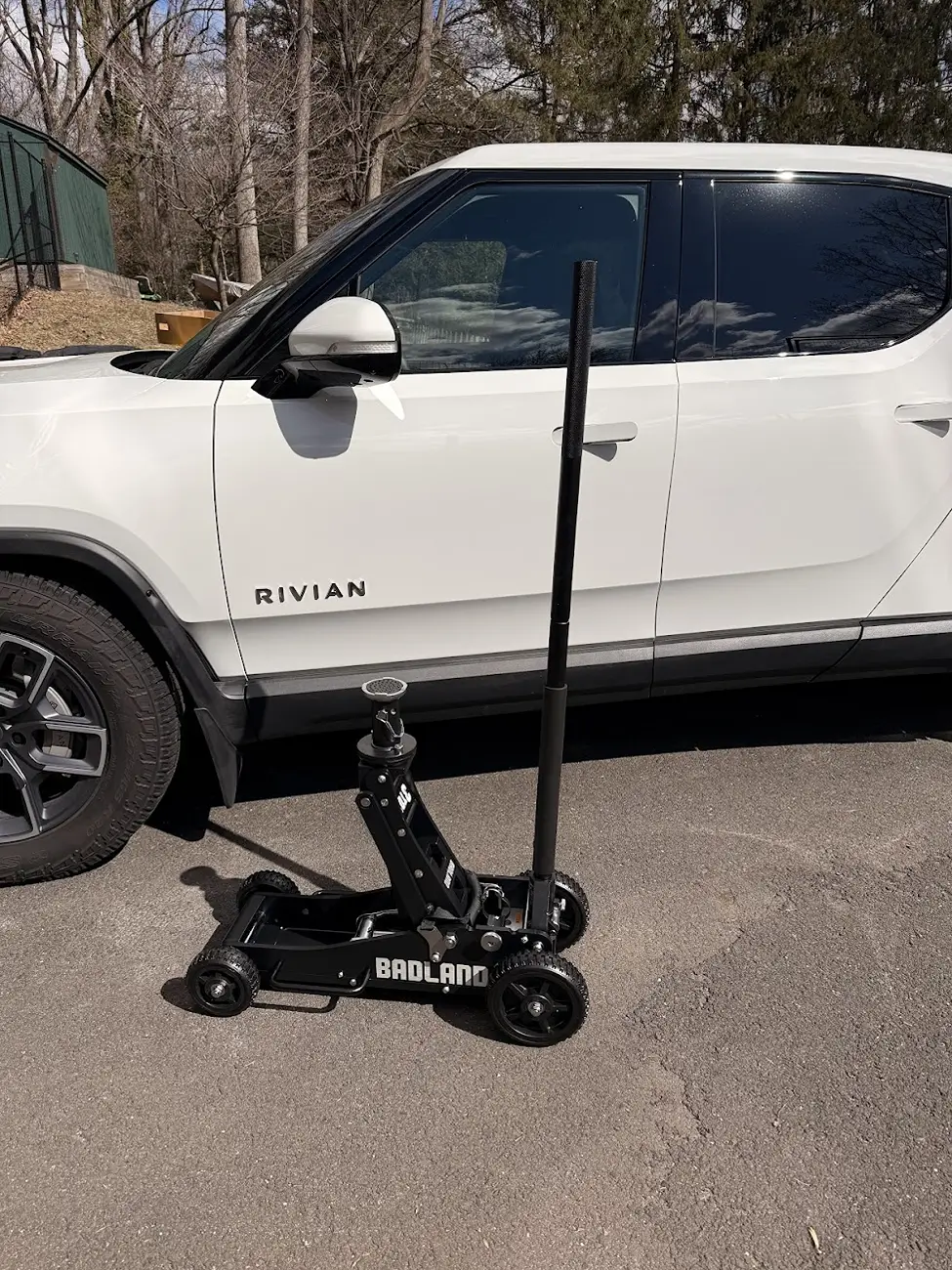

If I am going off road, I put this in the gear tunnel or bed. And most of the time it is strapped into the front of the bed with the tonneau cover closed. I do have the OEM jack but hope to never need it. Would only trust it with very firm and flat footing for the vehicle.
I have this too but for my R1S. Still haven't found a good solution to strap or mount it to something and store in the sub trunk for road trips.
