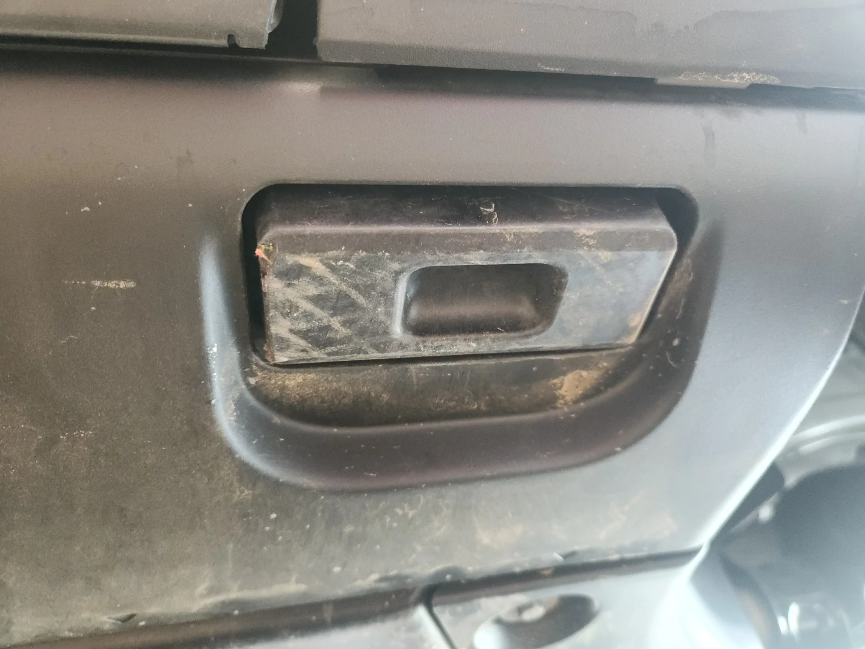

I like the Mercedes and BMW jack points. However this looks slippery and too big in one dimension to fit most floor jacks. If it is replaceable, like some German cars, maybe someone will come up with a better design.
THe pad is almost certainly big enough for a floor jack saddle - has to be since two post lift pads are similar size. Looks like the depression in the middle is meant for the scissor jack that comes with the spare tire kit.

Any chance that the entire pad can be removed, and so provide access to a roughly 2x4 inch jacking point into which a bespoke puck could be fitted?
This is the pertinent question of the day. We'll know soon enough.

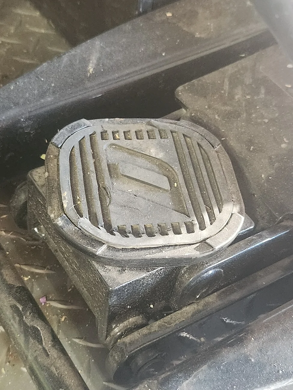

The floor jack in Austin was too large to fit with a lift pad like this below (4"). Rivian Service Centers already have an adapter for lift posts, so it's not a direct fit.

I wonder if instead of "optimized for service center" they meant "optimized for manufacturing".
Maybe they just assumed what worked on the factory floor would work in a service center. That's not logical, but it sort of makes sense. The focus is manufacturability, not serviceability? 🤷‍♂️

This is the new jack point for the R2. The 2"×4" high‑density polymer pad is the designated load surface, and the cavity in the center is difficult to justify from a functional standpoint for service facilities. The cavity would most likely be for a Rivian supplied scissor jack? Nothing outside that small rectangle is weight‑bearing, which means no traditional floor jack or bottle jack can properly interface with it. From a serviceability perspective, it’s an unusual choice
Rivian uses a small‑diameter round aluminum puck with a cross‑hatched top for lifting, and as a vendor, I’ve seen both that puck and the service‑center lift adapter firsthand. This design has the potential to create real challenges for tire shops and general service facilities unfamiliar with the R2’s lift geometry, as well as the DIY crowd.
When speaking with the Rivian team, they noted the jack point was optimized for their service centers. Even so, the R1 design is significantly more forgiving when it comes to locating and securing a jackpuck (lift adapter). Below is an example (photo taken by me) of the cross‑hatch imprint from the production R2 lift puck provided by Rivian Engineering.
I see no issues with this, they arent recessed. A taycan, panamera, and e-macan are almost identical. You need no special tool to lift them or use a jack on them
So the jack point on the car is not even wide enough for a typical floor jack saddle?
