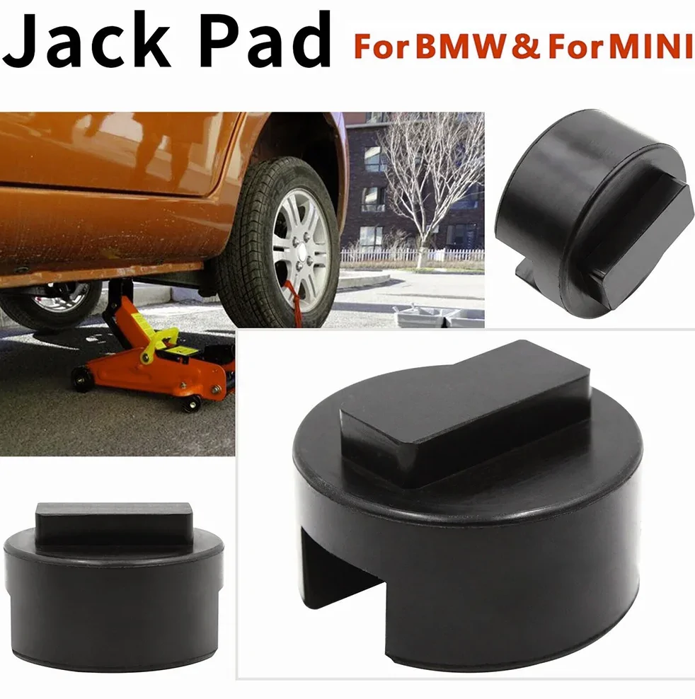

Have none of you ever seen a mercedes or BMW jack point?
Exactly what I was thinking...
Though a regular flat pad floor jack works fine in that spot on BMWs too.
Rivian R1T R1S R2 Jack Point Design - Potential Issues / Challenges Opera Snapshot_2026-05-21_174233_www.turnermotorsport.com
Rivian R1T R1S R2 Jack Point Design - Potential Issues / Challenges Opera Snapshot_2026-05-21_174312_ae01.alicdn.com
