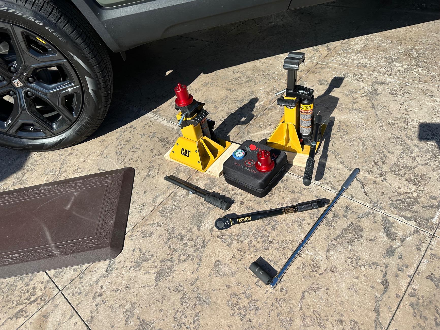

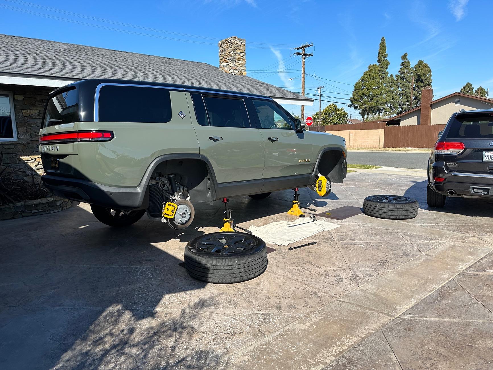

I use 2 of these for my tire rotations.
Rivian R1T R1S JackStands with Rivian IMG_8835
Rivian R1T R1S JackStands with Rivian IMG_8836
7,604
13,127
Thanks for sharing! Are the pucks just positioned on top of the bottle jack stand or is it secured in place somehow?
They are just sitting on top
