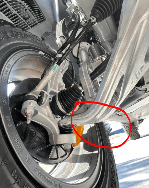

With a piece of wood to prevent gouging.
Good call on the wood. ALWAYS makes me nervous to use suspension components, but I’m convinced now….OK, now f I just had a spare! Haha

It seems better to lift via the puck port, then place a stand under the wheel suspension arm. My issue with that is the jack will need a high enough lift to make a 1" or so gap under the tire? Also I recognize the need for a best surface contact under the suspension arm to avoid slippage or damage.
Such a task requires some measuring of jack and stand capacities in advance.
I highly recommend NOT using wood in any vehicle lifting scenario other than maybe a flat piece under a tire, jack, or ramp to give you a bit more lift/clearance. Sure, "it worked the last time" but I don't see a load rating on my random piece of wood...
Some lift points are not perfectly flat over a large enough area and present a point load to the wood. I've seen 2x4s split, even before the full weight of the vehicle was on the jack. Imagine unloading a jack onto a jack stand with a piece of wood there only to find out the wood splits and the jack moves dangerously, perhaps under some other component. Definitely an "oh shit" moment (from experience).
That's good advice. I only had to jack it up there for a second to reposition another jack, but your point is well taken.
