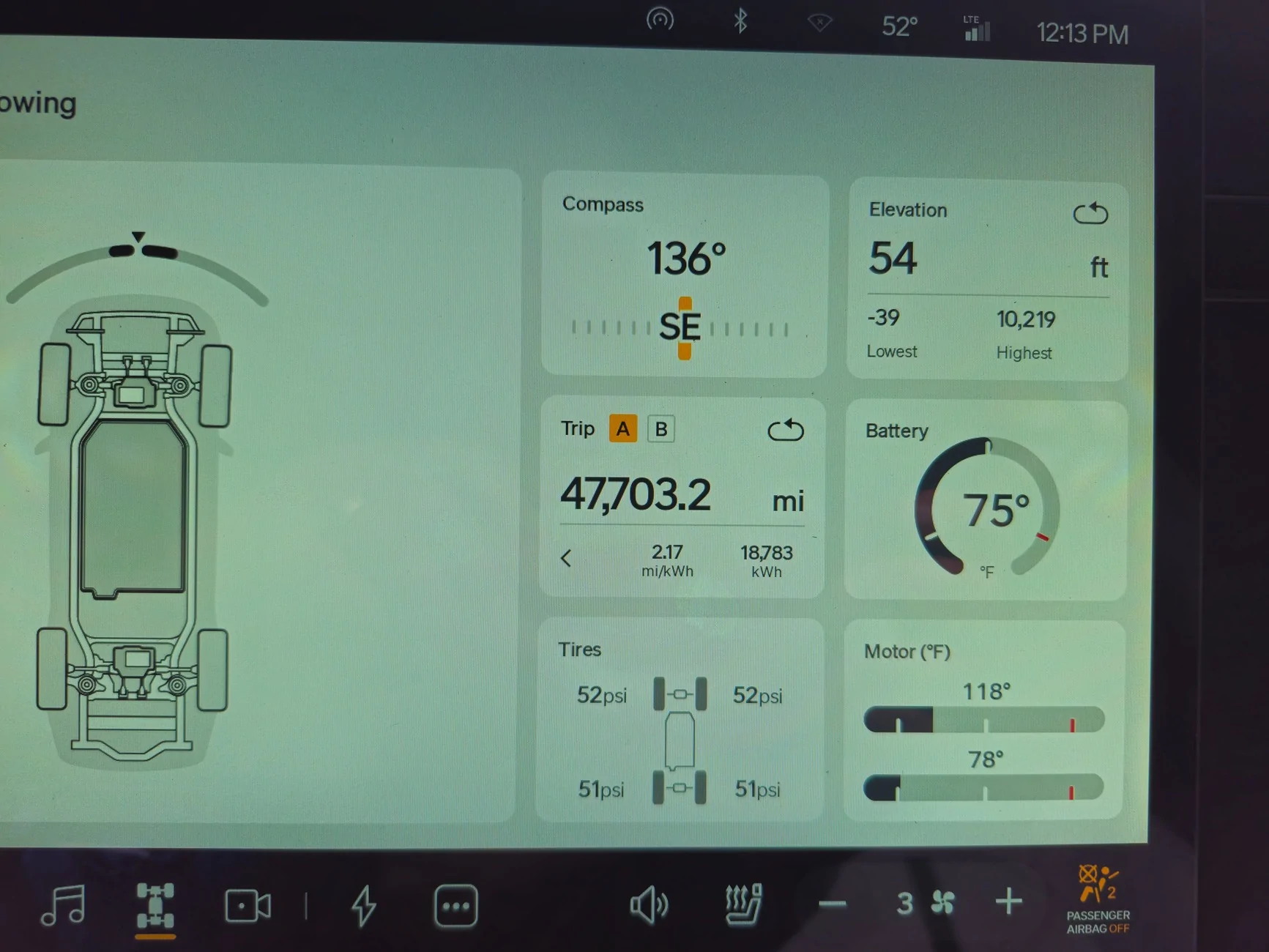

Story 1: The picture of the graph below is from the main data screen on my 2023 R1T [trip A view]. My truck is a dual motor with max pack, but I don't think that matters.
When I divide my total miles driven [47703] by the stated kWh consumed [18783], my miles per kWh pencils out to ~2.54 mi/kWh. But what the car calculated was 2.17 mi/kWh. What this view doesn't show me is what my total kWh impact has been and I am trying to solve for the additional layer of overhead usage. I know the total kWh would be 21982 if my range was truely 2.17 but I would really like to see that detailed. And why give me a 2.17 mi/kWh value if I don't have the right data to validate the claim? Was it a recent update that made this happen?

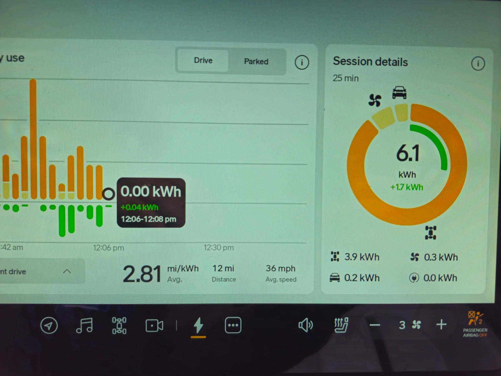

Story 2: The second picture is from the power screen. Its from my trip to the gym today, that totaled 12 miles. 2.81 mi/kWh doesn't come from 12 miles/6.1 kWh but when I account for the regen the math kind of works, meaning that I divided 12 miles /4.4 kWh [6.1-1.7].

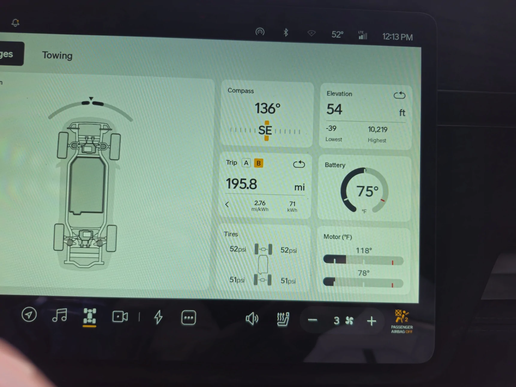

Story 3: My trip B screen shows the common sense calcs: 195.8 miles driven, 71 kWh consumed with the average being 2.76. Simple math tells me this is correct but I wonder if the data is incomplete.

Also, your #2 item is one that is super confusing. That graph uses regen and battery usage to somehow determine energy used. I guess regen + battery = energy needed to move the truck but who cares? All I care about is how much battery is used.

The energy monitor graph has always been super unintuitive to me, and I have to take several minutes to back into the math to make it work (which negates most of the "at-a-glance" value).
I'm assuming it means you consumed a total of 6.1kwh. BUT, that doesn't include the 1.7kwh regen.
The breakdown however, does try to math in the 1.7kwh regen, evenly split amount the consumers of power. So while it shows 3.9kwh used for drive, it's really closer to 5.4kwh.

I’m just as confused as OP on the trip meter. Total miles driven is a simple calculation. Total kWh used is a simple calculation. Why does A/B not equal C?
My trip meter is the same way. Pretty much spot on for my 1,500 mile trip A. Not even close over the lifetime 31k mile trip B.

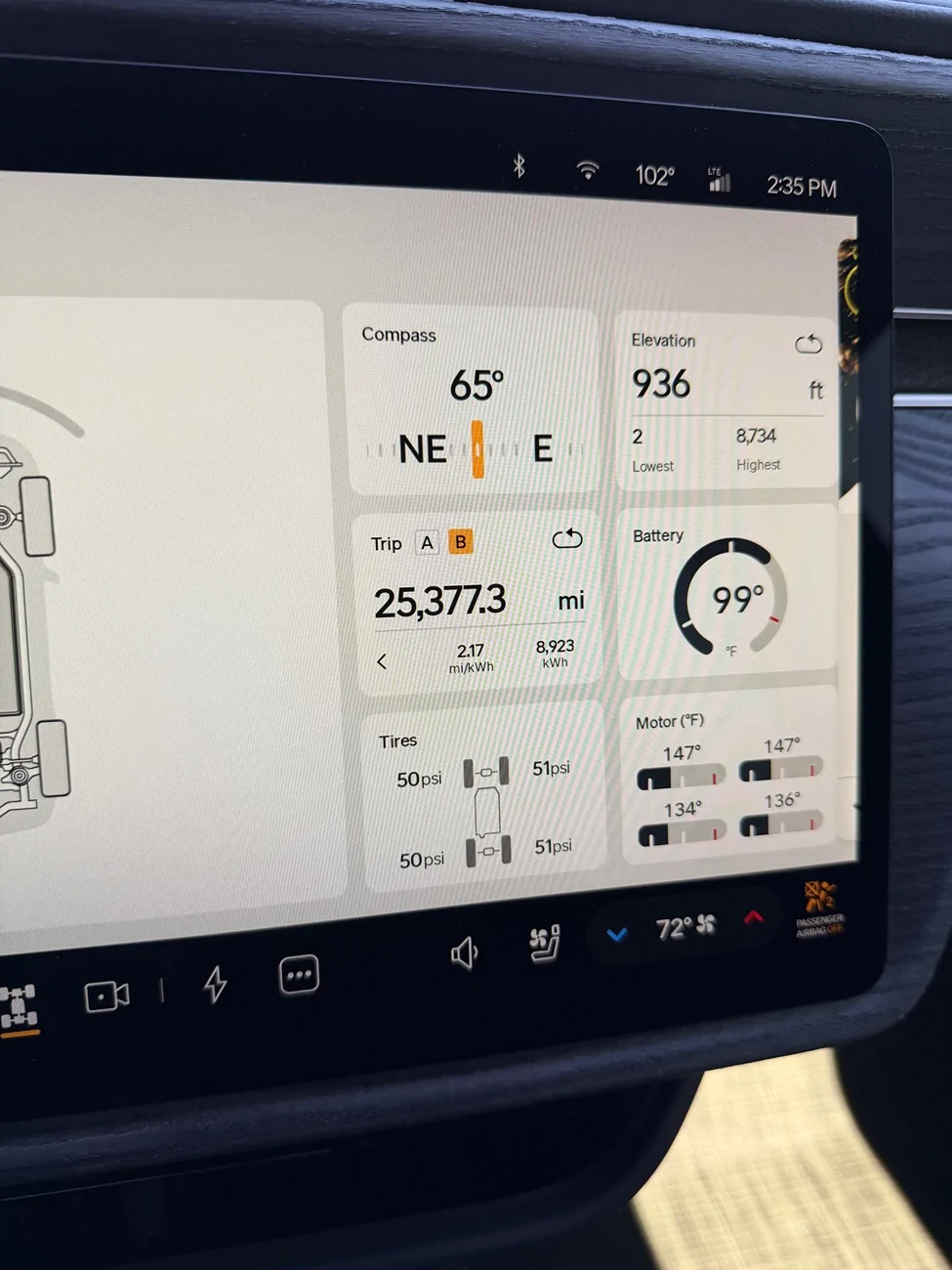

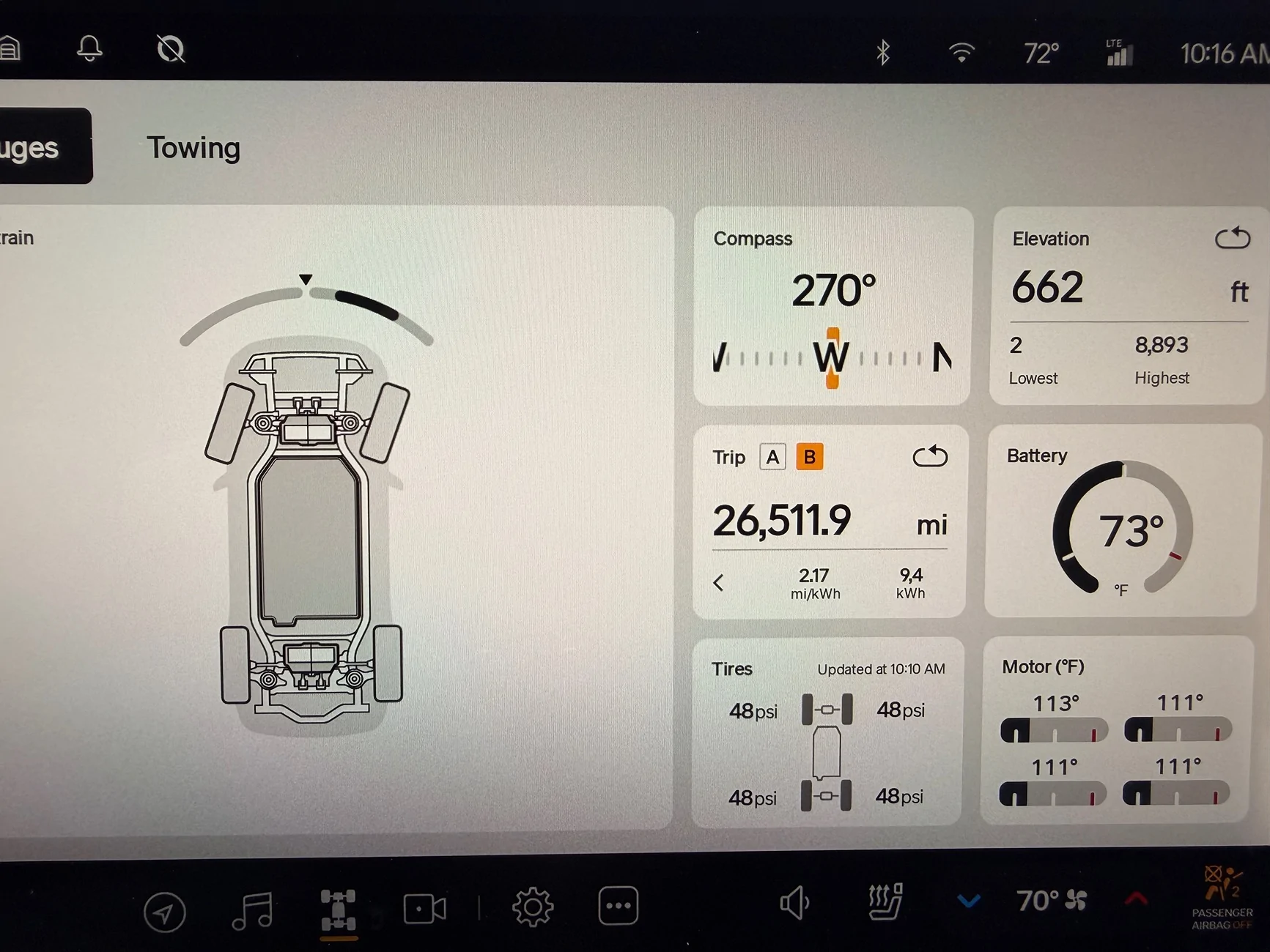

My gauge has been stuck on 2.17 m/kWh for a year now. I think it must be a software glitch.
I may be wrong, but the trip meter math also includes the power used for everything - HVAC, vehicle computer & other systems, etc. The number at the bottom of the Energy screen/app is the raw driving stat.
