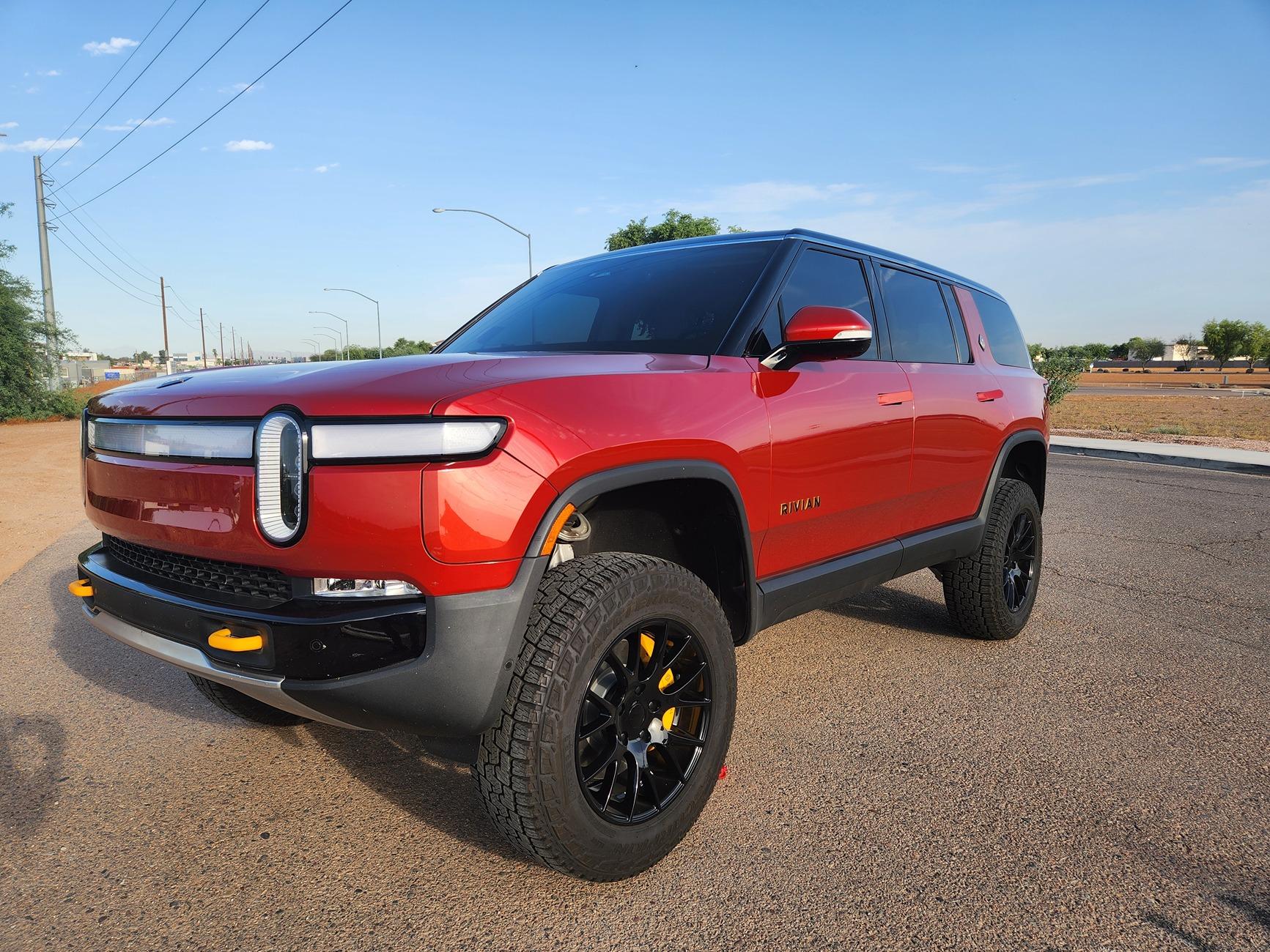

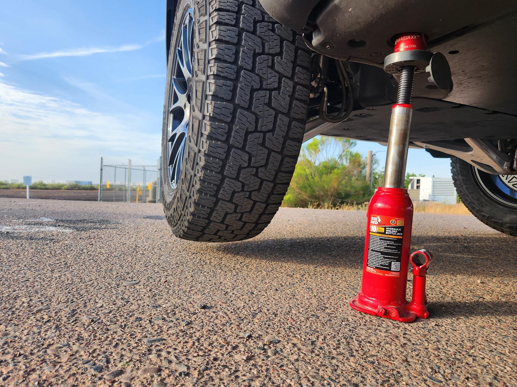

You've got it correct, just one slight change. Put the vehicle in highest mode (off road or all purpose works), then do your 1-4.
I have the Dodge HellCat wheels on my wifes R1S, and for long road trips swap in the 21's. It would be advisable to use a higher temp light grease on the hub-centric rings, because getting them off after they have heat cycled a few times, can be a challenge to remove to put the 21's back on.
Wifes R1S with HellCat wheels below in highes off-road setting. Second photo shows our magneti jacks pucks in same setting on front..

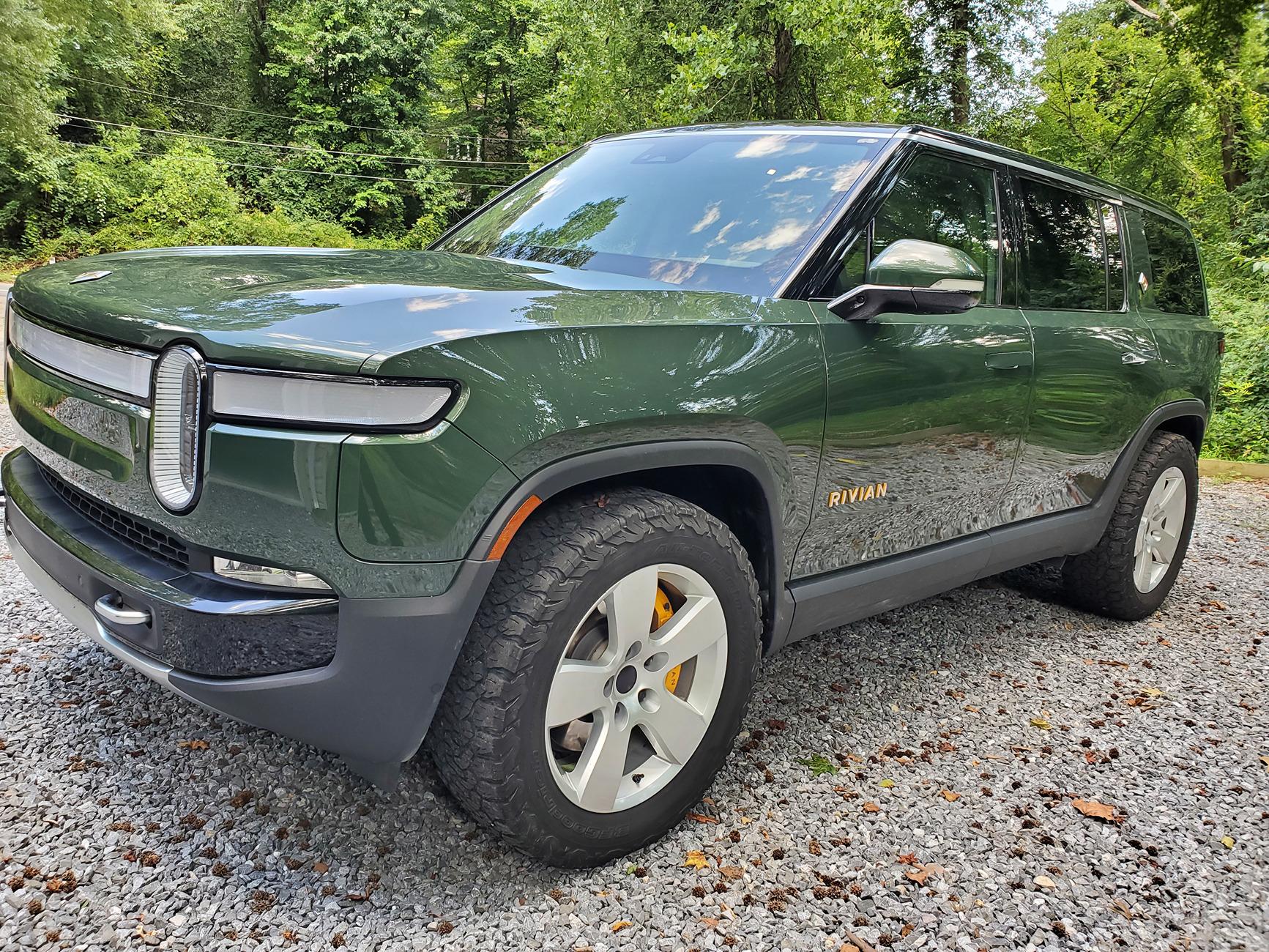

Cool, thanks for the confirmation. I'll make note for next time to ensure that the vehicle is in highest before doing the swap. Good note about the grease too. Might see about pulling the RAM wheels and throwing some grease under the rings - they were pretty tight for the initial install and I would be surprised if they seize quick.
Rivian R1T R1S Tire Change - Forgot to do AT / Highest 20240810_134117
