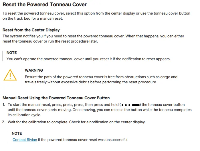

It's really more like four very fast presses, and holding the last one.
Tried that too, to no avail. HW reset didn't help.

I attempted this on my tonneau but it treats the final long-press as a manual engagement, and it stops as soon as I let go. I can't get it to automatically recalibrate.
On the 4th press, release the button as soon as your tonneau starts moving.

For anybody reading this. Watch this video. You have to hit the buttons very quick

Thanks to both @Dark-Fx an @SolartoEV for the help. Unfortunately, the reset procedure doesn't seem to work in my case.
Three quick taps and holding the button down on the fourth does close the cover, but it does not cycle open. This is the case regardless of whether the button is held down on the last press, or not. At first I thought this may be because the cover was not completely closed (when it reaches the end of its travel, it stops momentarily then cycles back about a foot - whether the tailgate is up or down). I tried getting the cover to the end of its travel before doing the 3-1 procedure, but that doesn't work either.
May well be operator error on my part, but I tried pretty much every iteration to no avail.

@Yossarian, mine is doing the same as yours this morning. Honestly, I haven't operated mine in a few months (first couple months because I didn't need it, last month out of fear something like this might happen). When I take it off charge this morning (I'm at work), I'll give the manual reset a try & let you know if it worked.
EDIT: Just did the manual reset and it worked perfectly. Event got the notification on the center console.
